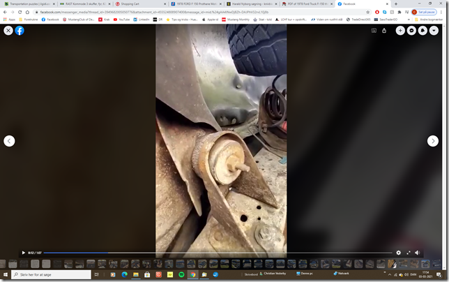

Bushes - cap
Hi
I need new bushes and I don't know what they are called ?!
Anyone ?
Thanks

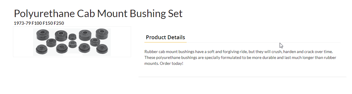

Hello,
I am by no means the expert on here and someone should come along soon enough and correct me if I'm wrong, but it looks like Body (or Cab) Mount Bushings are what you're looking for. The picture below is from LMC. Also, for future reference you should let people know what vehicle you're asking about....year, Model, motor, etc. That way the friendly people here can give you better answers. Good Luck!

Hi MrG
Ohh yes....you're right
1978 Ranger XLT
I have also found those and I think it's right...
Thank you

Consider a full bushing kit.
You may need to get new lower retainers and LMC is the only place I could find that has them.
You will need to reuse the upper sleeves.
Give yourself time to do the body bushings because you will probably want to clean and paint the upper retainers and perches.
We did ours over the summer and it was fairly easy. You will want to get or make a puller for the old bushings.

Glad you found them Vesterby. At various times I've seen them listed in Ford literature as "insulators" and "isolators" and even "cushions" once. But almost everyone in this country will know them by body or cab "bushings" as you found out.
They are often referred to as body "mounts" too, but that can be confusing and is more appropriate for the metal part (or bracket!) on the frame on which they sit.
You may never need to look for another set, but if for some reason you or one of your friends needs some and those names come up in the search, they're usually one and the same part.
Have fun working on your truck!
