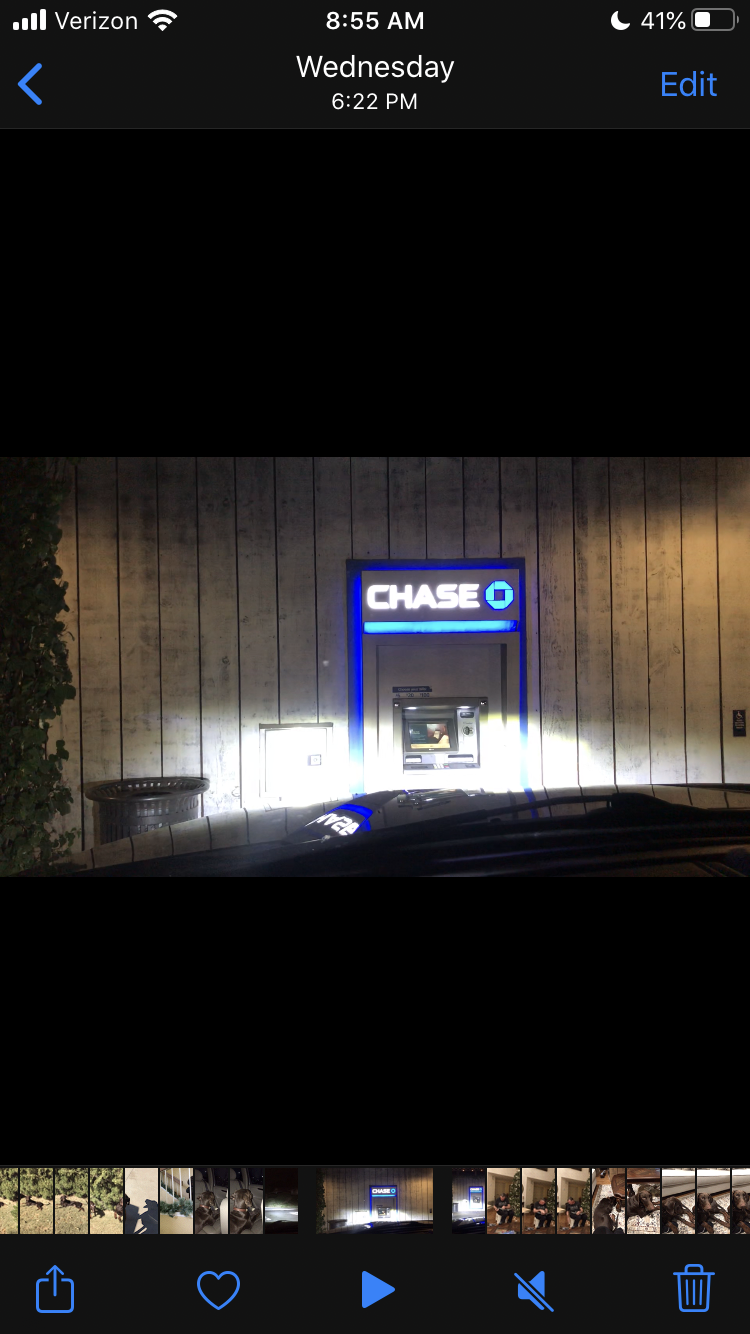

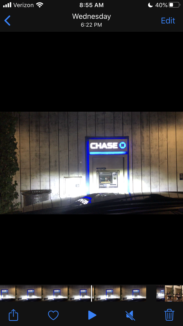

Attaching two pictures with the old LEDs. Low beam and high beam pictures.
Low beam
High beam

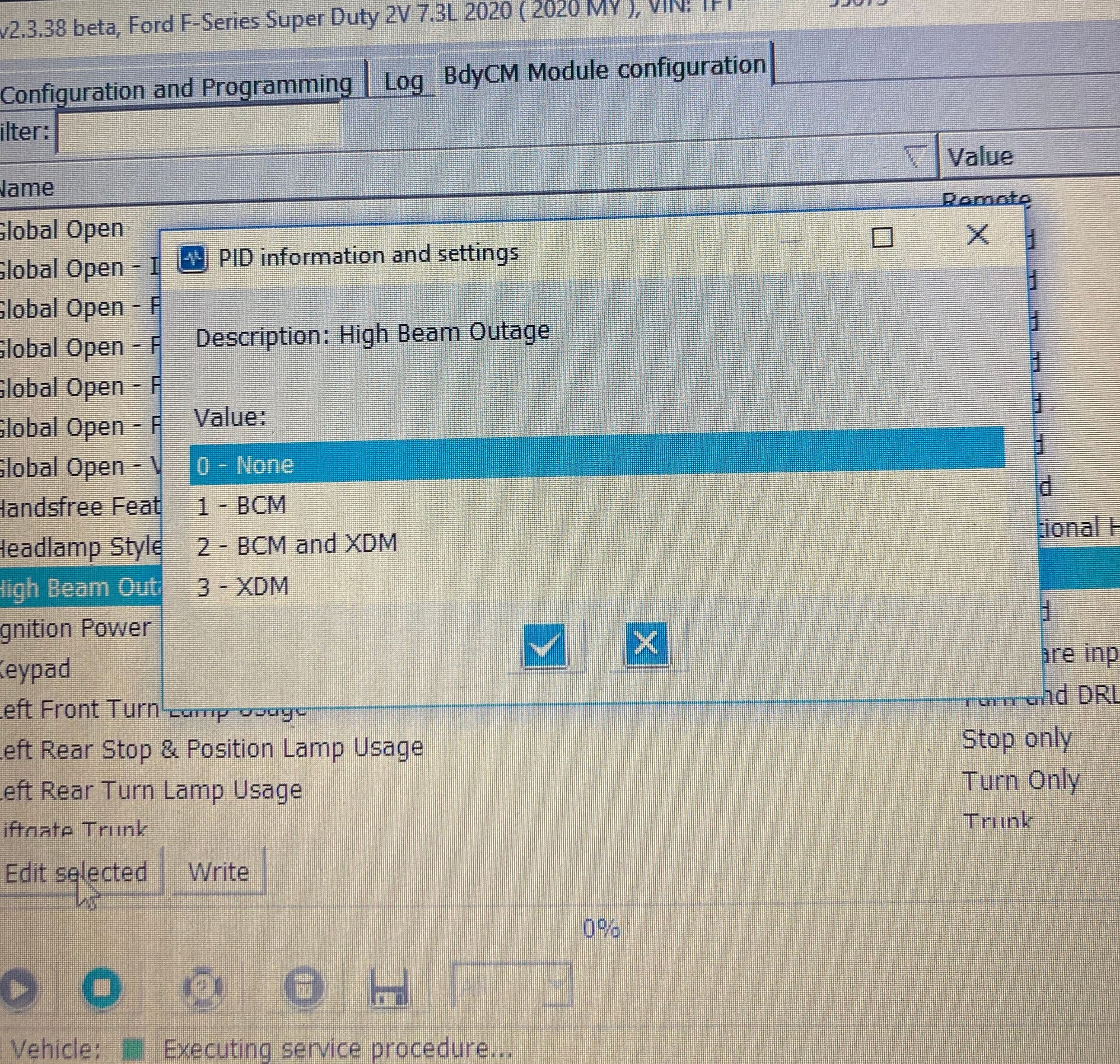

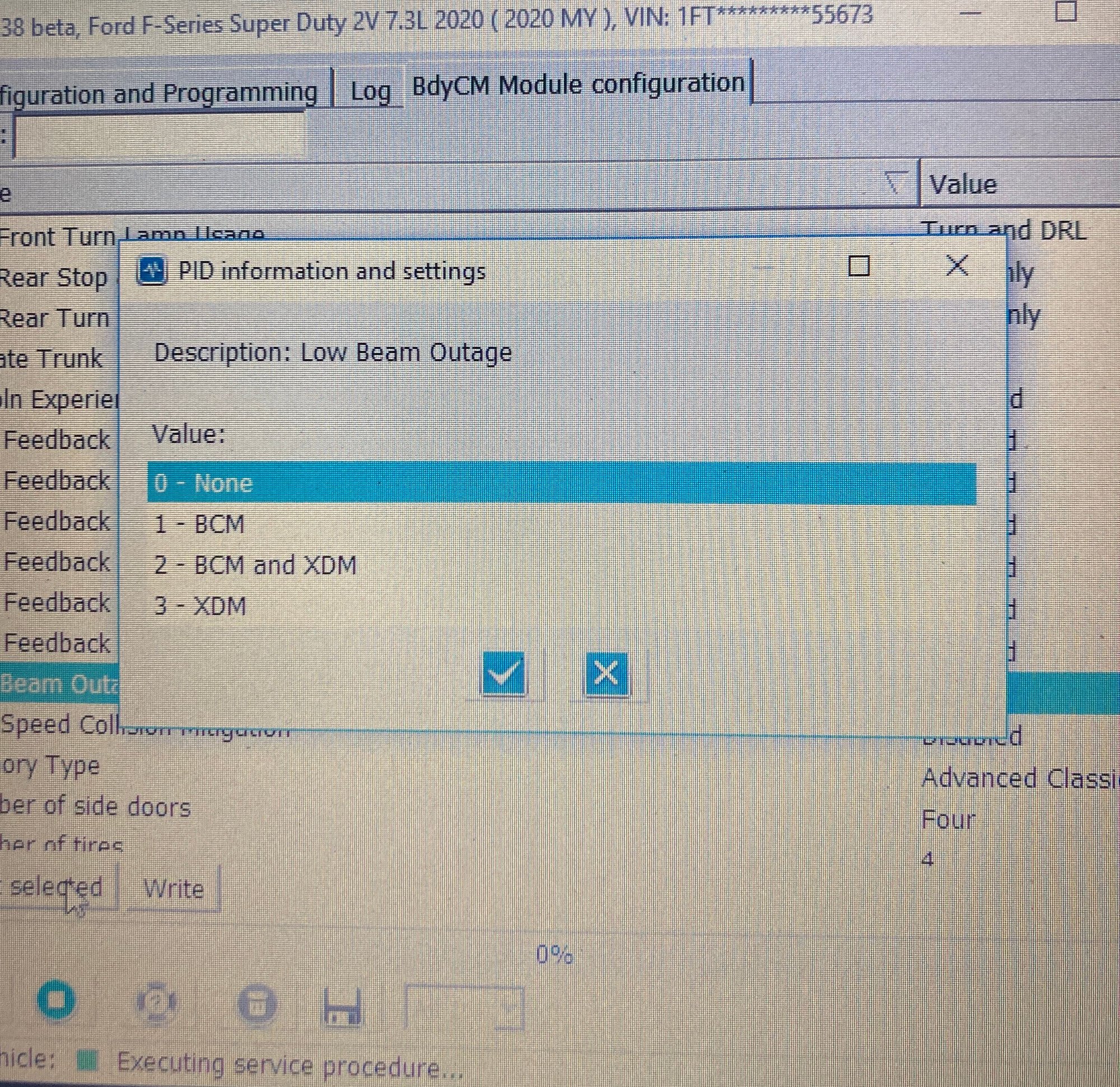

There must be a part of the story missing? But to the OP, if you get into FORScan look into the NON AsBuilt or "plain English" side. The spreadsheet that I have printed at the moment doesn't show headlight settings. But I was just into my truck last week with FORScan for some speedometer adjustments and I recall seeing some headlight settings there. Possibly for halogen to LED or ABM Outage settings, I can't remember exactly. I may have FORScan out later to get rid of the horn honk when I lock the truck with fob. If I do, I'll try to get a picture of where my headlight settings are.

Here are the pics of my headlight settings within the Non AsBuilt portion of the BdyCM (body control module) of FORScan. FWIW, I am not having the problems that the OP is having with no discernible difference between high & low beams. You can use these pics for comparison to your own settings, but I would suggest checking in with someone like ZooDad who knows what he's doing in FORScan. My settings may not translate to success for the OP.
I'm not the greatest at backing up a module in case something goes wrong. So at the very least write down the things that you changed and note the original settings in case you need to go back.
