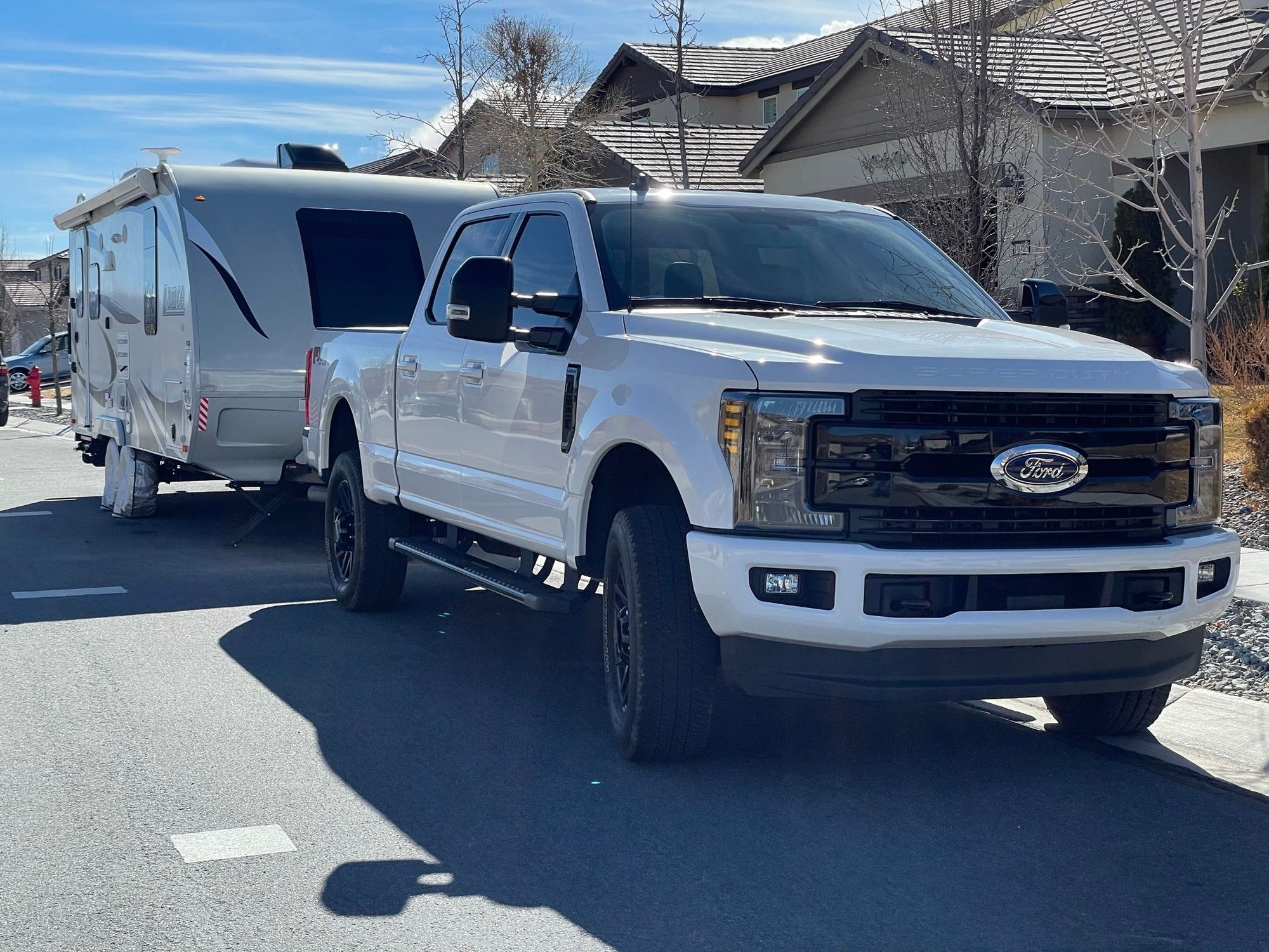

My first post... So, I just got this wonderful 2019 F250 Lariat, FX4 with 6.2 gas, and I'm starting to "learn" it. It's my first pickup so I have a long way...
Any case, the only "concern" I have at the moment is the rigidity of the suspensions. I live close to a freeway which I take to go in any direction but nearby shops, and they had the great idea to pave it in cement which of course requires joints every three/four yards. It seems that it is the right distance to get into resonance with the F250 and it's really bad, you start bouncing up and down and there's no way to stop it, slowing down or accelerating doesn't make any difference. I did lover the tire pressure to 45 psi (the truck is empty) and that has improved a little bit, but not much.
The problem is my wife, of course, I can manage but she is really not liking it...
What can I do to mitigate the problem? Is it a factor of the FX4 "reinforced" suspensions? I will not do any significant off-road, the truck will be mainly used to tow a 6000 trailer, so not a big deal. I know that when towing with the added weight it will smooth out a bit, but I'd really would like to use it also as daily drive, if possible...

Did you not test drive before purchase? FX4 has nothing to do with beefed up suspension. The FX4 package includes skid plates and heavier duty shocks, not more stiff. The truck is made for work, it is not a 1/2 ton suspension. A 6,000 lb trailer you could have bought the F150 gas engine, or diesel and it sounds like you might have been happier.
''I run 65 psi, btw.
You have a nice truck best to enjoy it since you already bought the farm.
''Note: why do you have your Trailer tires covered in front of the house? Extended stay there? Also tell that person down the street to not park in front of a fire hydrant.

Nice truck and trailer! We have a Lance 2075. Since it's your first truck give it some time. My wife was afraid of the big thing at first now she wants to drive it. We don't have the concrete issue here but one of the things that sold me on mine was the stable suspension and bumps were cushioned well, never harsh. Does your truck have a lift, aftermarket suspension? If so maybe that's part of it. We had that harmonic issue with our Early Broncos on California freeways. Maybe try some weight in the back like suggested or do some more tire pressure experimenting.

First of all, very nice truck and camper!. My F-250 rides like a Cadillac...........until you hit a bump. Enjoy the truck, you'll get used to it and so will your wife.

Well, I did try it, just not on the freeway... And I have to confess that probably I would have bought it any case, it's really nice and I wanted to be completely free from any worry about weights...
Good eyes...! I'm fortunate that in my development the HOA is almost non-existing, so I can park in front of the house no problem. For some reasons it has been there for the past month or so... And, I will go right away to check on that hydrant!!!
The 2075 is great! Mine is a smaller 1995, still pretty good for two people...
The suspensions are stock, no lift, this is actually why I was wondering about the FX4 because it's really quite high from the ground. I'm 6' and I'm ok, but shorter people have troubles even using the step...
