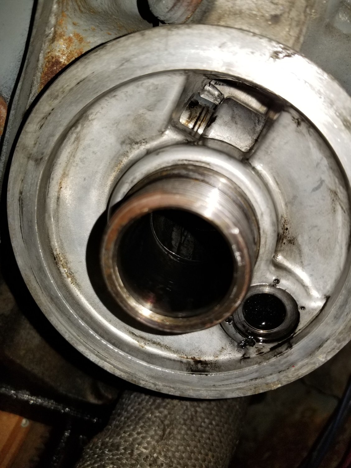

I changed the oil. It was black as night but no signs of metal. No abnormal sounds from the engine. I sprayed the pressure regulator valve with brake cleaner and tried to grab the end of the inner bit with a pick but feel nothing. It seems like it's fully seated. Starting it after the oil change oil pressure came up quickly, Westach gauge reading as expected, factory gauge was very slow to come up and more consistent that previously but still somewhat erratic. After letting it idle for about 10 mins I came back outside and both Westach and factory gauge are reading zero or below. So basically no change from waht I had originally, except the factory gauge is more consistently intermittent after reseating the connection on the sending unit. No change in engine sound from cold idle around 40 psi to hot idle with gauge not reading any pressure. I have to imagine it would have seized by now if there was really no pressure.
Before oil change:
After oil change:

ur engine is clean, it definitely has low oil pressure
