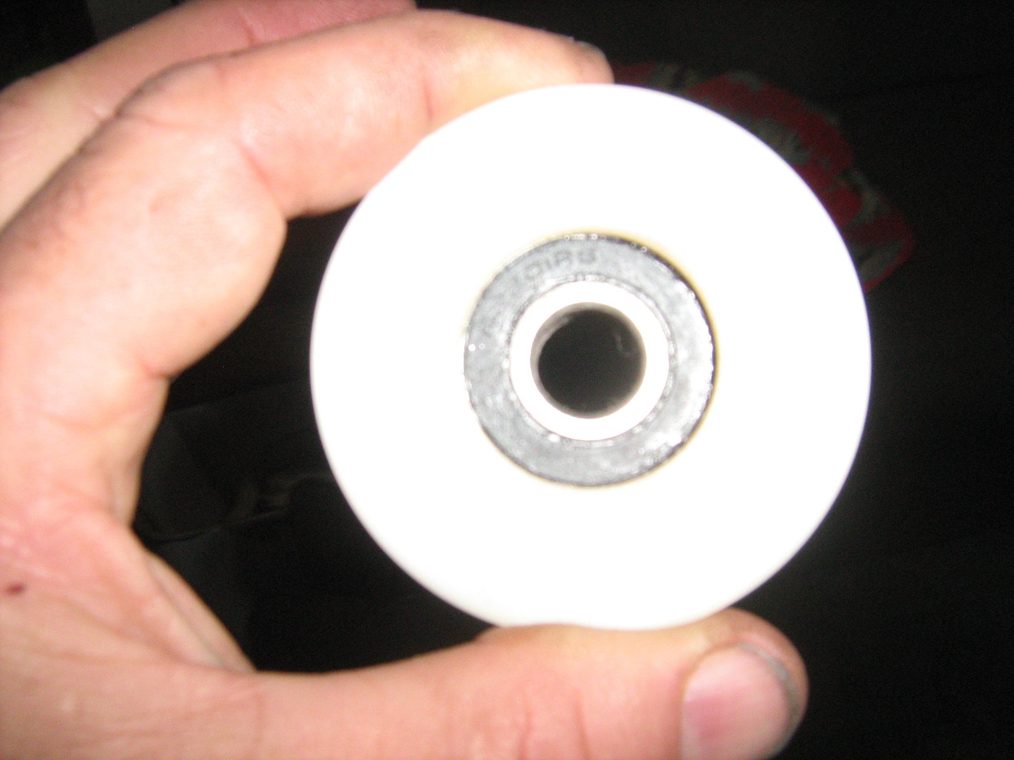

I've used these on 2 of my hood tilts,no groves but work 190%
