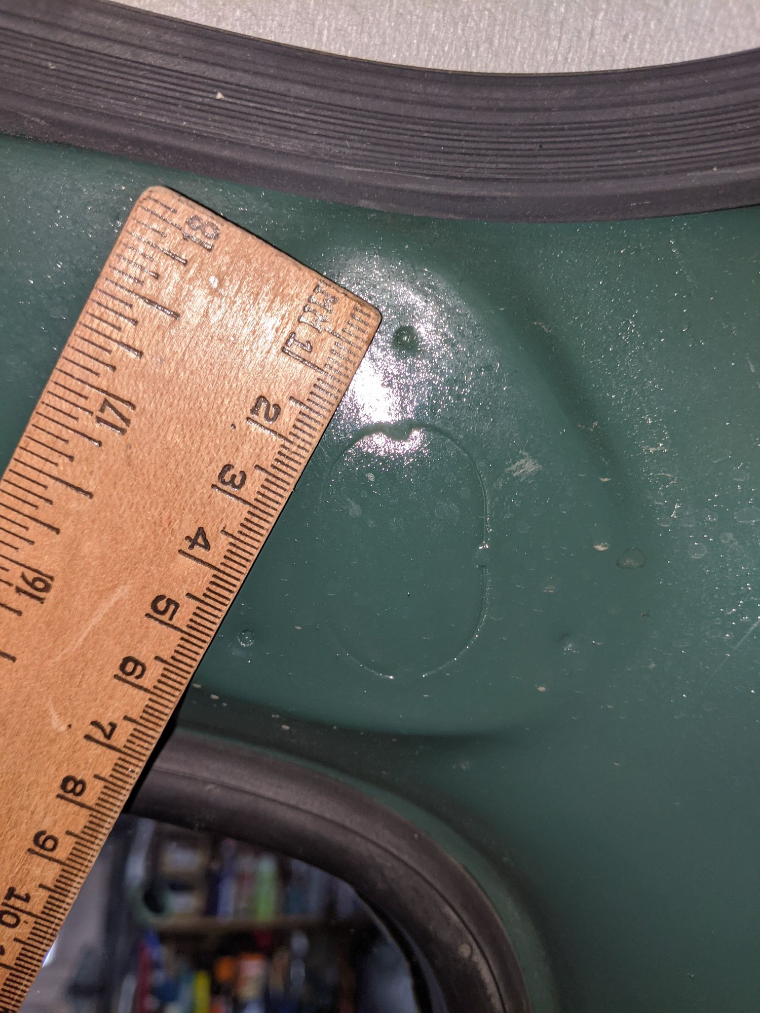

Does this help? I even give it to you in metric!

From the Dennis Carpenter website.
compare the pads, which were not used originally:
53-55:
56 pad:
56 visor arm:

The 56 hole measurement center to center is 1 5/8" ,measurement from those to the single hole to the bottom is an even 2"
In abe's picture it appears the two hole are in the lower position which place the visors at a different angle
