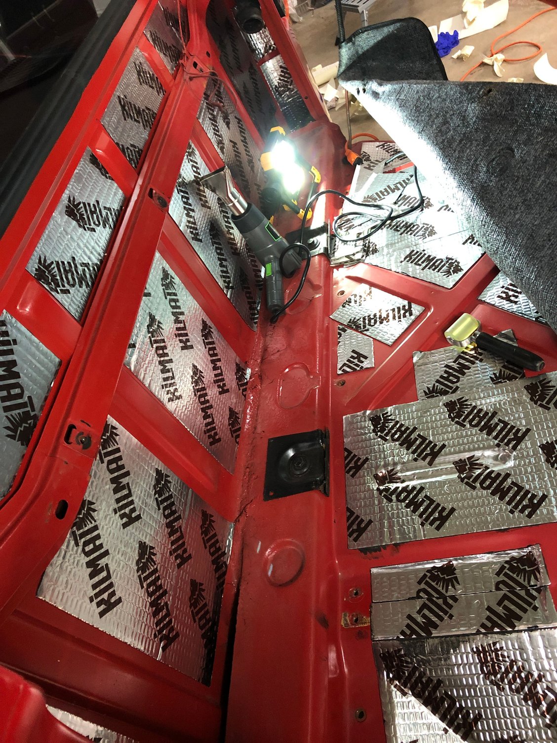

I've been tracking noise as well. Big changes for me were Dynamat and Dynapad on as many interior surfaces as possible, including inside the doors, and full carpet on the floor. Still pretty loud at speed, but much better than when I started. I think my tires are likely the biggest contributors now...

SwampRattFord's Avatar
SwampRattFord
Joined: Sep 2019
Posts: 658
Likes: 129
From: Northern Texas
Trying to tame the noise beast
