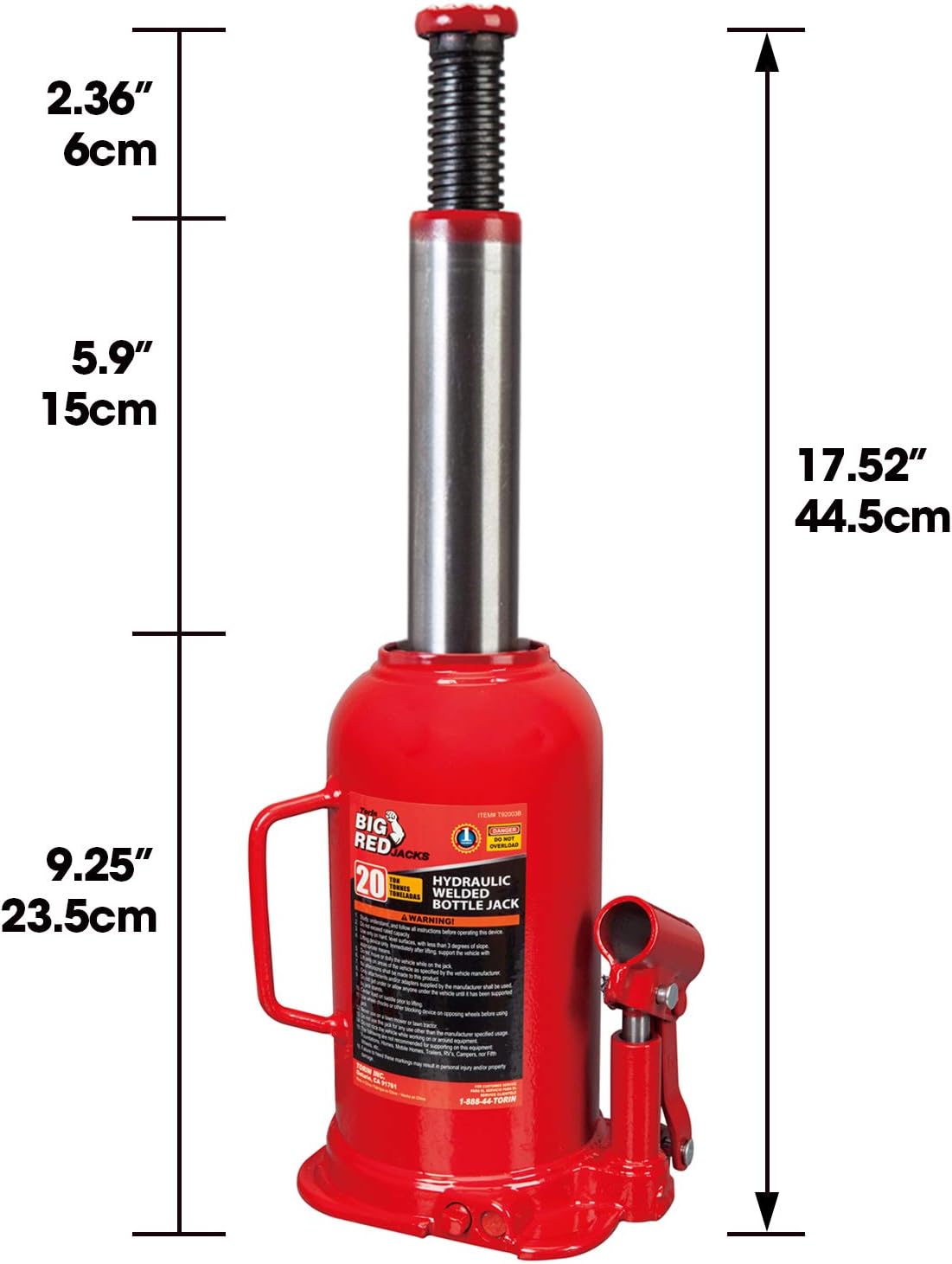

Here's how I have done all work that requires me to lift the truck.
Step 1: Use jack under the differential pumpkin and lift to desired height
Step 2: Place jack stand under the axle tube at desired height
Step 3: Lower the jack until truck sits properly on the jack stand
Step 4: Setup the jack as an additional support under the differential pumpkin.
Step 5: Work on EX

i threw out the stupid scizor thingy and put a BIG RED brand 20 Ton bottle jack inside the right rear kick panel storage area, it fits like a glove.

I ditched the factory bottle jack as well. I have this in the truck all the time. Serves as jack & locks to become a jack stand while on the road.
