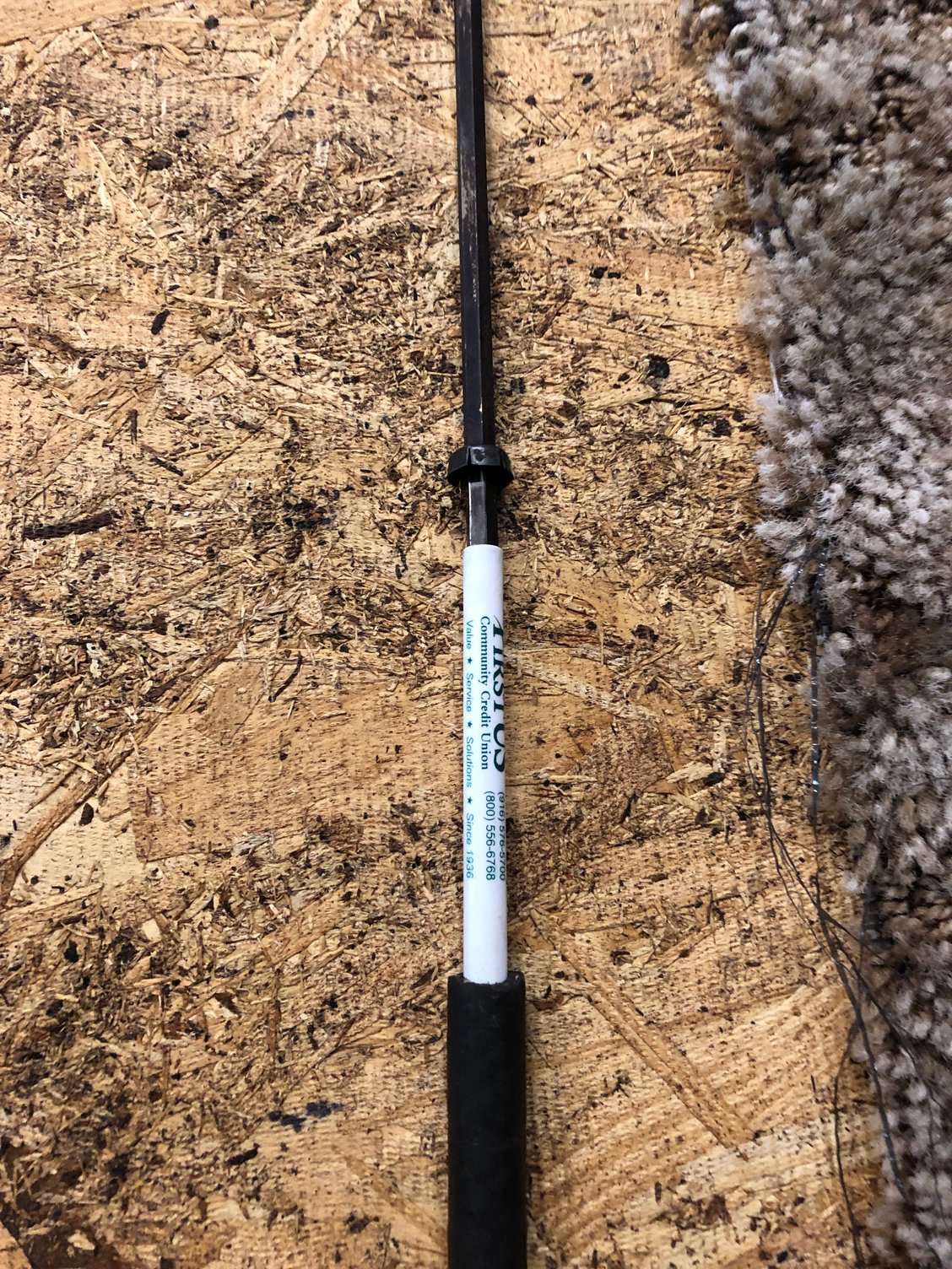

sorry to hear that I had one Leaning to the side in the dissy channel but still retrievable I made a simple tool too get it out good luck

A pic of the tool

mine was not in the oil pan
it was still in the channel where the distributor shaft goes preventing the distributor from going all the way in
i could see it with a light. I used a borescope my wife operated the cam and held the computer I could see the shaft I used the pen which fit over the shaft with the fuel hose for extension got the pen too capture the shaft moved the shaft over the pump installed shaft then used a coat hanger to push the shaft out of the pen
in post 6 I suggested that the shaft could still be saved
my borescope is about 4’ long I don’t know if a tool of some kind could find it and retrieve it
