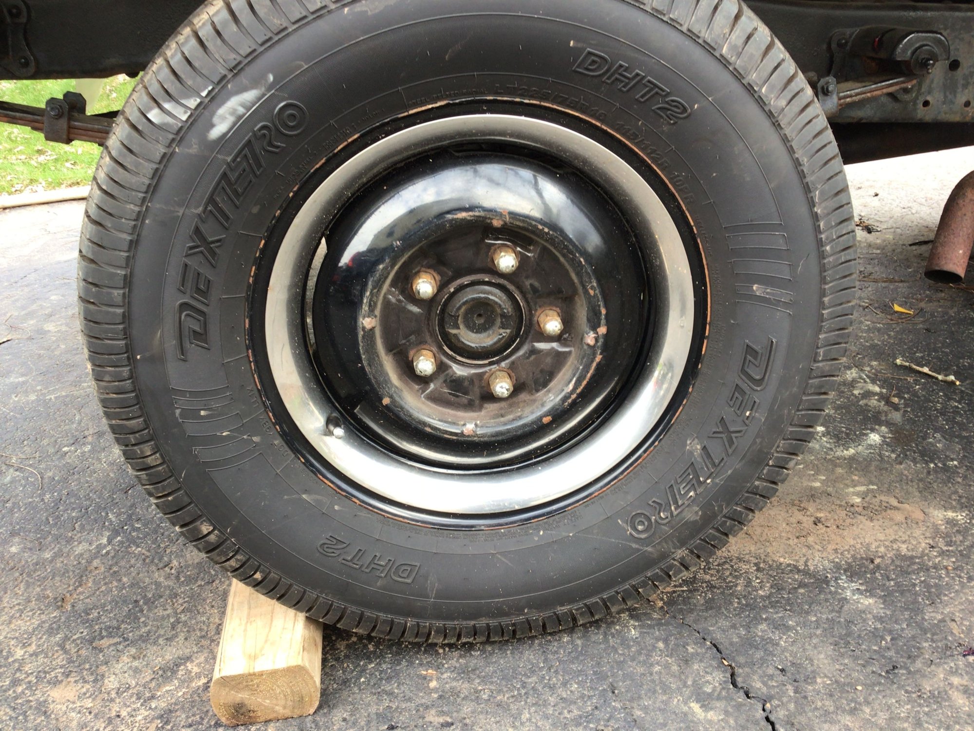

My 48 F1 came from the PO with 16” wheels and LT225/75R16 tires, not no spare. I’m looking for a wheel to use as a spare and figure junk yards would be my best bet. There’s one locally who claims to have a big pile of vintage wheels that I can pick through, but I’m not sure how to measure correctly. I know how to measure the bolt pattern, but not width and offset.
I tried to measure my wheels while on the truck. The diameter is easy but width is not so much. I put a straight edge inside the lip front and back, and measured through the hole. That came out to 5” so I’m thinking that taking into account the thickness of the metal, I’m thinking the rim is 4.5” wide, which seems narrow for the tire. Then I measured from the surface by the lugs to the straight edge, 1 1/4”. I can’t measure from the back unless I remove the wheel from the truck, which I can do if necessary but too cold today.
So when I head to the junk yard, how can I measure to get an accurate replacement wheel. I’m not concerned about the hub cap, I won’t be putting one on the spare.

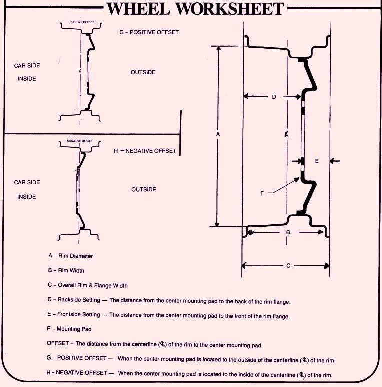

By appearances you have stock F-1 wheel(s). Assuming so they are as you found 4.5” wide. They have 5/8” of positive offset, meaning the center disc sits proud of the centerline by 5/8”. To find a nearly similar wheel you’ll want to take a straight edge and tape measure along to measure the backspace of the prospective donors. Placing the straight edge across the rear rim lips the measurement to the back of the center disc should be about 3 3/8”. Stu

so if I’m reading this right, A should equal 16”, B equals 4.5” and D equals 3.375”, right?

Correct. Stu
