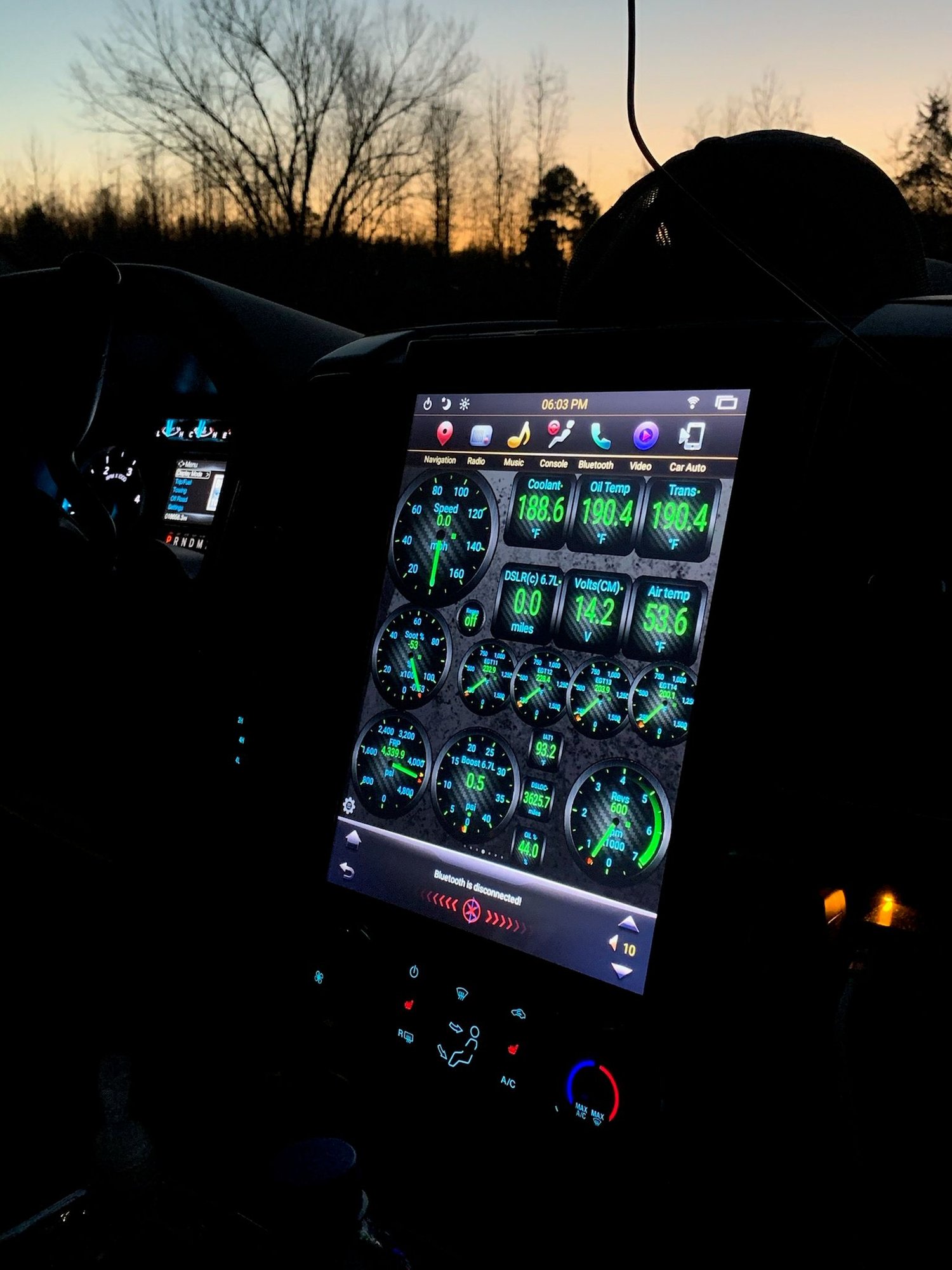

Torque Pro running on my Tesla style verticle infotainment system, connected using an OBDLINK MX+ bluetooth reader. 2018 F350 6.7

Nice but I think you could make it less busy by deleting the MPH and RPM since that is redundant. But I like it.

Yeah it is. I just got it set up, still messing with it.

actually there are a few items that are important to monitor.
EGT 11 is important as you don't want to shut down a hot turbo. EGT 14 is an indication of post DPF temps, useful to not shut it down when too darn hot due to a regen.
Regen is also another one to know, when it active or off. Nothing worse then shutting it down, again stuff is hot and oil dilution.
Distance since last regen is useful to detect issues with the emissions. Based upon trends and use.
Actual coolant and oil temps are useful for some of the same reasons.

Yep, mainly for the cool factor. Like I said above back in my 7.3 days of towing a camper monitoring vitals was more critical. With these new trucks, stock not tuned, watching all the data this and that is pointless. My wife got me the Tesla style infotainment system for Christmas so I'm still in setup mode. Will I go down the road watching it all.. Nope.

Yes but, is said info accurate?
