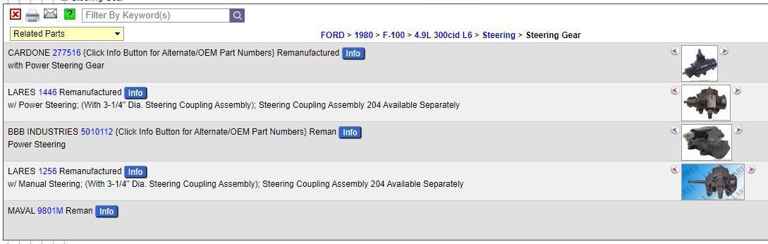

Earlier on, the base models of these trucks came with manual steering boxes. I know they came as late as 1982, but I personally haven't seen one newer than that. I think power steering must have become standard equipment in 1983. Anyway, if you look on RockAuto you will see that new manual steering boxes are available. I've seen them on there. Your local auto parts shop may be able to get them as well.
Checked RockAuto and there's one on there, 4th line down...
