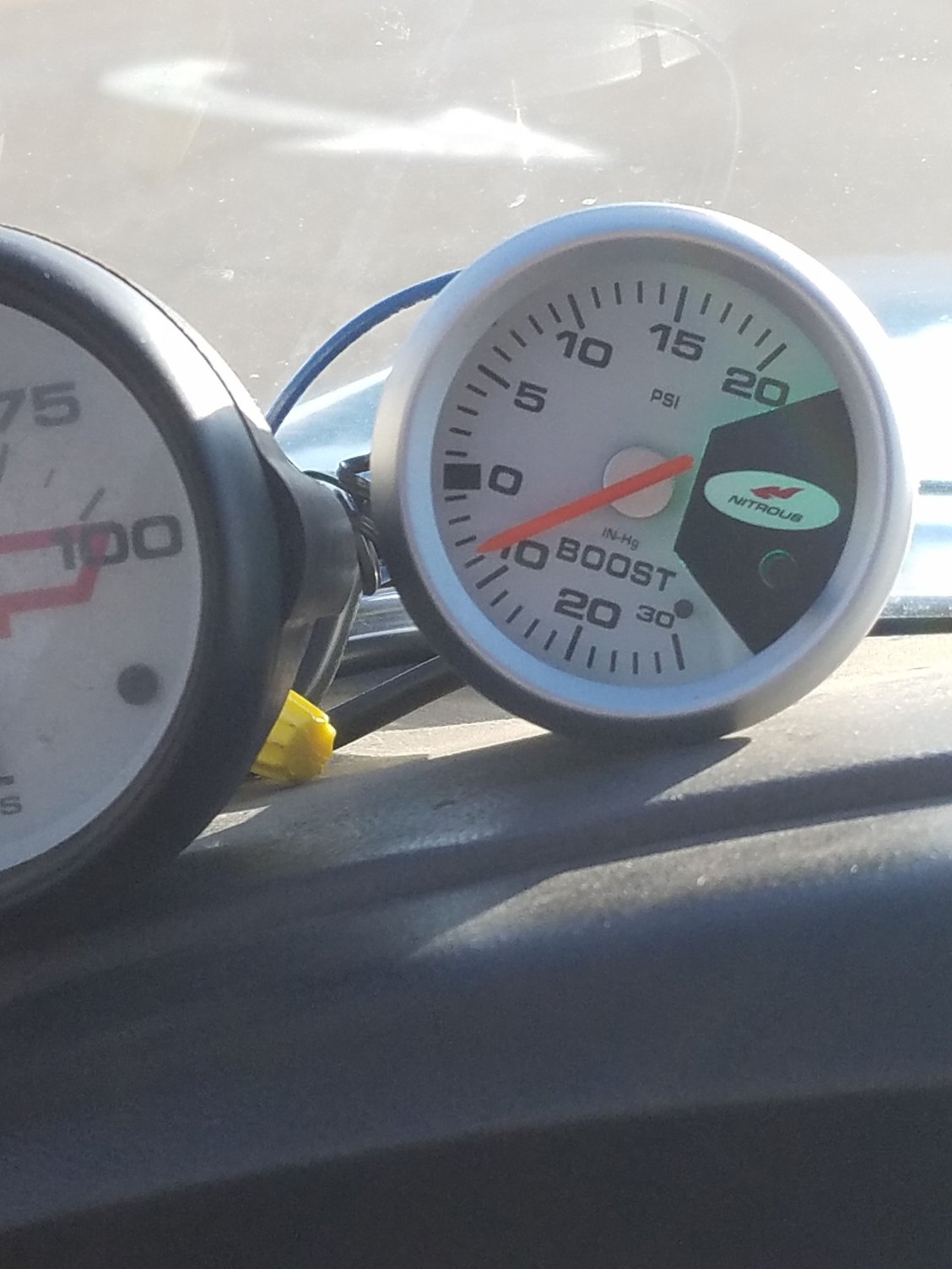

So here is the truck running 60 in 5th gear cruise set to make sure speed is steady
Approximately 7ish in hg.
Now here is the same section of road same speed in 4th
Right about 13in hg.
So not a small difference.

With EFI engine load is the most significant factory determining how much fuel is injected and Load is inversely proportional to vacuum... low vacuum = high load, high vacuum = low load. Engine rpm does factor in of course but a relatively small increase in RPM can be offset by a significant decrease in load and result in an improvement in fuel milage. So what was the engine speed in your truck during those tests in both 4th and 5th gear? If I had to guess I'd say 1500rpm and 2300rpm. Based on my experience 1900-2000rpm is the perfect hwy cruise rpm for a 5.0 truck, lower rpm hurts performance and fuel milage, higher rpm performs better but while fuel consumption is better than it is at 1500rpm it's not as good as it could be.

If my tach is right 4th 2300ish and 5th 17-1800ish. Both at 60. ( dont quote me right now, i dont remember for sure. I will double check on my way home after work and update)

Conanski, i double checked the rpm at 60 mph 4th pretty close to 2400 and 5th looks to be 1800ish. As close as a 26 year old tach can be haha.
