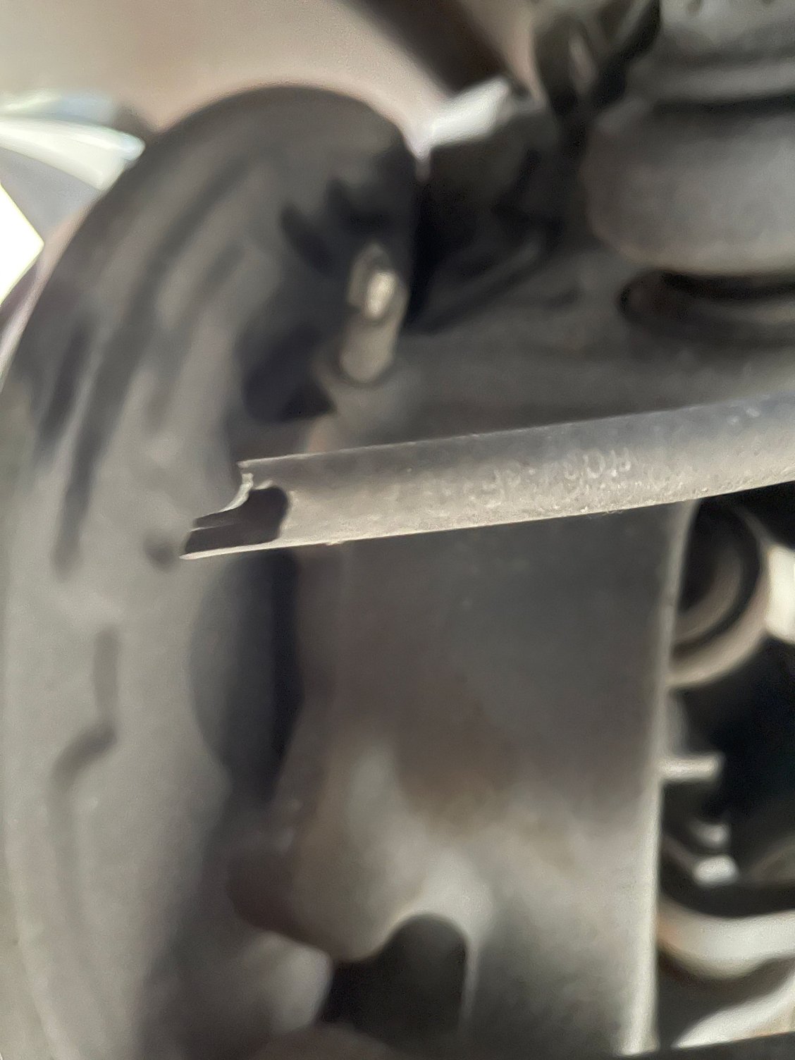

Had to switch mine to manual to back a trailer up in dirt then again in snow. Front tires were slipping. Changed the know to 4h, 4l everything seemed ok but wasn’t happening.
switched the hubs to manual and truck was a beast.
Was going to have the dealer look at it next time it goes in but randomly found out why I wasn’t getting traction. Fixed with $2 worth of hose vs days of downtime at the dealer. 2019 F250 with 23,000.
the vacuum hubs are known for issues and at least the manual hubs solve them. I threw an Allen wrench in my glove box to get my front hub caps (Moto medal wheels) to access.
Stupid question......so that is a torn vacuum hose for the auto engage?
Yup, its hard to maintain vacuum with that hole.
As others have said, if/when the vacuum system fails, you can get out and lock them manually.
