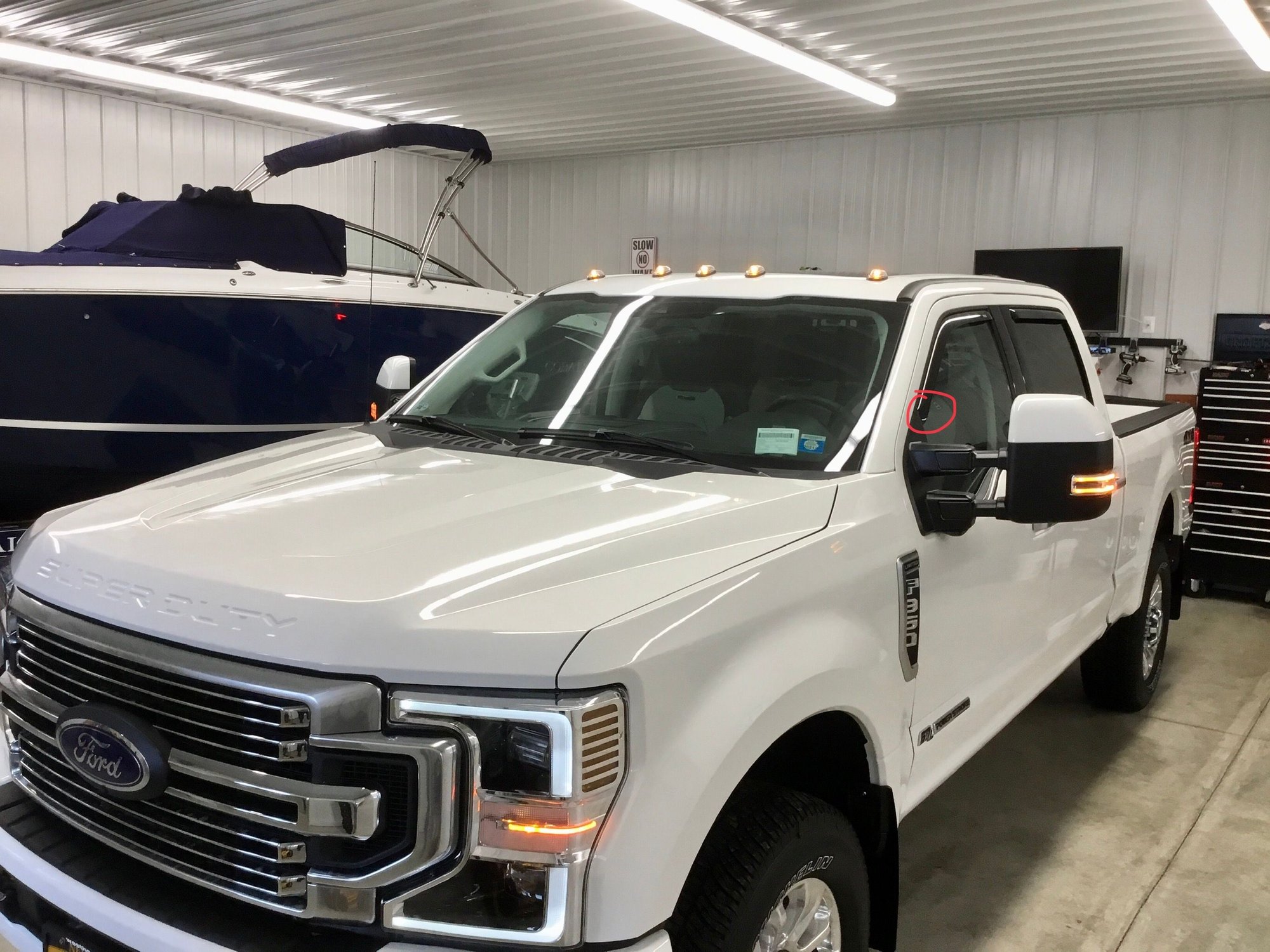

Just tape.
Zero issues, same on any of my past trucks and wife’s Expedition.
The installation is pretty straight forward. Just take your time. The rears are super easy. I removed the tape covering first.
In the front, the tricky part is getting them fully seated at the very front lip (circled) where you begin installing them.
The leading lip needs to by slipped fully under the plastic portion of the mirror mount. The leading front lip is maybe 1” of edge.. It takes a little coaxing. Get it in there as far as you can.
If not, they will not fit properly at the very back. Very tight tolerance.
Make sure they are sitting evenly from front to back in the channel first, without any bow, then carefully roll up. You may need to pull out very slightly to get the window to roll up and to not engage the safety roll down feature.
Once the window is fully closed, just leave it be for a few days. Warm temperature is a definite plus. After that, you won’t even notice they are there.
Once the window is rolled up and the 3M tape has a chance to fully cure, they’re not coming out...
I don’t find any wind noise either. AVS designs a very thin and well fitting product. Unlike the nasty stick-on type, they look stock.
