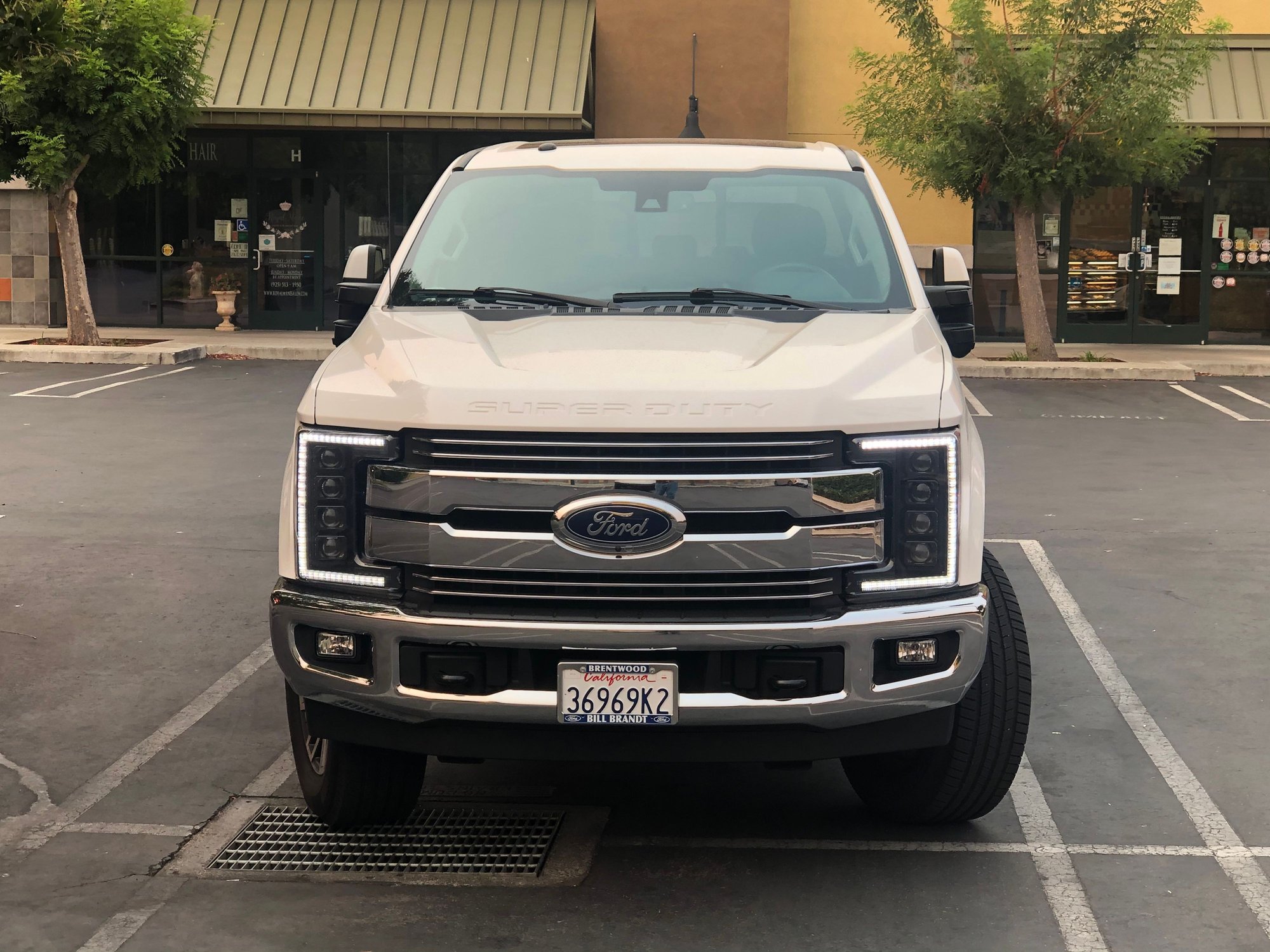

I did the LED bulbs in the standard headlight housing.
Had various issues including flickering.
Ended up going with these:
https://www.headlightrevolution.com/...B_2?quantity=1
They are great. Expensive but they work and look great.
