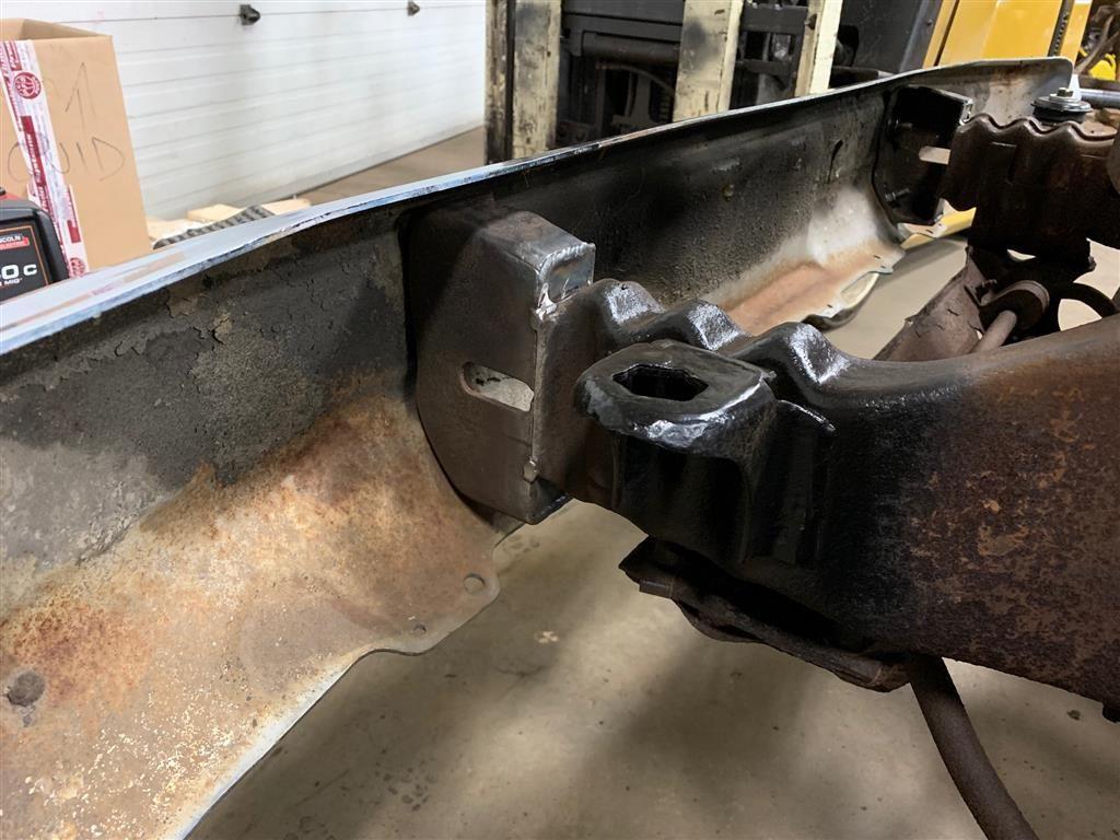

There is a member on another Ford truck site that had the same issue as you on a 4x4 frame and finding a good one was out of reach.
Projects - 1980 F150 4x4 Flareside Project
He came across a later truck with a good frame but bad body, he also did not like the later body style. The only thing that is different on the later frames and ours is the vary front where the bumper bolts to.
What he did was cut the front "horns" off both trucks and graft the 80-86 horns on the later frame so the 80-86 bumper would bolt on.
He also had to replace some of the spring hangers, you can get them new. I think he also had to do a cross member or 2.
Hey Dave, I know that guy!!
How I describe the 1995 donor frame truck is not that it had a "good frame", but it had a better rusty frame...lol.
The whole point is this though...if you can weld, it really opens up the options for finding a replacement frame. 1980-1996 is 17 model years, so it gives you an extra decade of frames that can be used on the Bullnose trucks. It also means that you can have more options for replacement crossmembers.
Everything is rusted to pieces around here...
Anyway, I removed the cab and fuel tank crossmembers and patched them up. I welded plates over the rust holes and added some extra plating and bracing where I could. At this point, my rebuilt crossmembers are as good as new, if not slightly stronger again.
The 1987-1991 frames are almost a direct swap for the 1980-1986 frames. They have the same front frame horns, just without bolt holes for the Bullnose bumper. All you have to do is drill holes for the bumper, and you're done. Everything else is the same.
The 1992-1996 frames are also almost the same. In 1992 they boxed in the front ends of the frame rails to add crumple zones. Others have done this before me, and in different ways, but I cut the ends of the 1995 frame off, and welded on a set of Bullnose frame horns (that I cut off a 1986 F150) at the junkyard. It looks a little goofy with no bumper, but once the bumper is installed nobody will know the difference.
