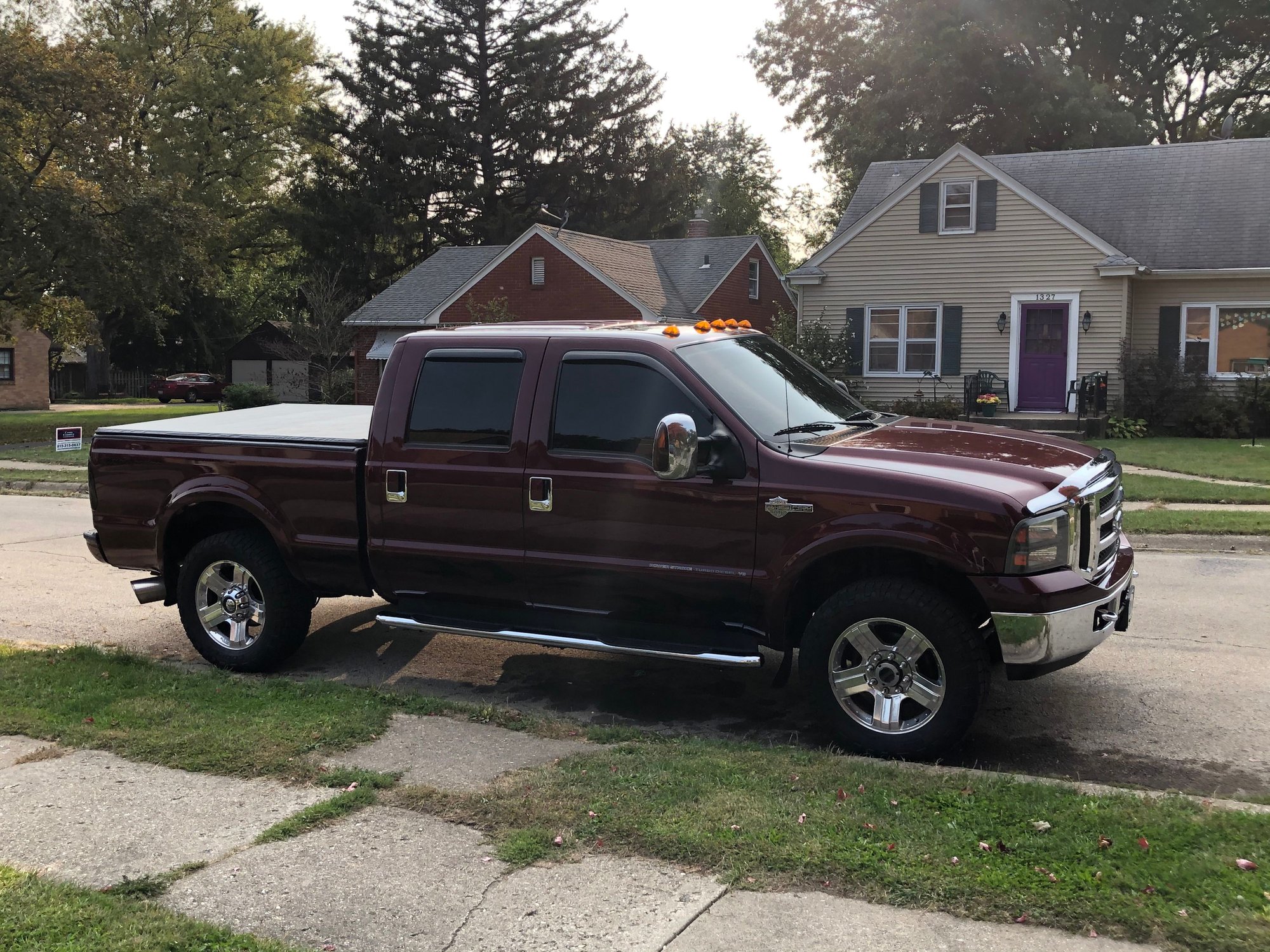

Hello everyone,
I am looking for recommendations on wheels and the offset I will need. I have a 2006 F250 Harley Davidson Edition with stock 20” wheels. I am putting a 6” lift on the truck and I am looking to go with a 37” by 12 1/2” or the 37” by 13 1/2” tire. My question is what wheel width and offset would make this possible and what wheels in your opinion will look good on my truck? Also if you have a similar combination please post a picture so I can see how it looks. I have posted a picture of my truck that I am doing this to. It is snow season here and I don’t drive my truck once they start to drop salt because I live in the rust belt.
Thank you for any help you can give me.

For your truck and those tire sizes I’d go with a 20x10 with a -19 or -24 offset. Depends on if you want the tires outside your fenders. With a 12.50 tire and -19 offset on my 05 Excursion it the tires were barely past flush. But your axles are wider than mine, I think by 1.5-2” per side. So with the 10” wide wheel and one of those two not crazy offsets I mentioned above it’ll have a nice little bit of tire sticking out of the fender well
Too bad you’re not closer, I have a set of 5 Fuel Hostage II wheels, 20x10et-19 that I’m going to put up for sale soon. Would probably look great on your truck!

I run 20x12 with 37x13.50 tires. You're gunna have to do some trimming >.< I had to cut even more to fit the long johns. I absolutely hate those fender flairs I mean cmon look at those mud flaps

I don’t want to have to do any cutting up on the truck for them to fit. I just don’t like the idea of cutting things up to fit because it is the Harley Davidson Edition.
With a 6” lift and the wheel sizes I recommended you should have plenty of clearance.
