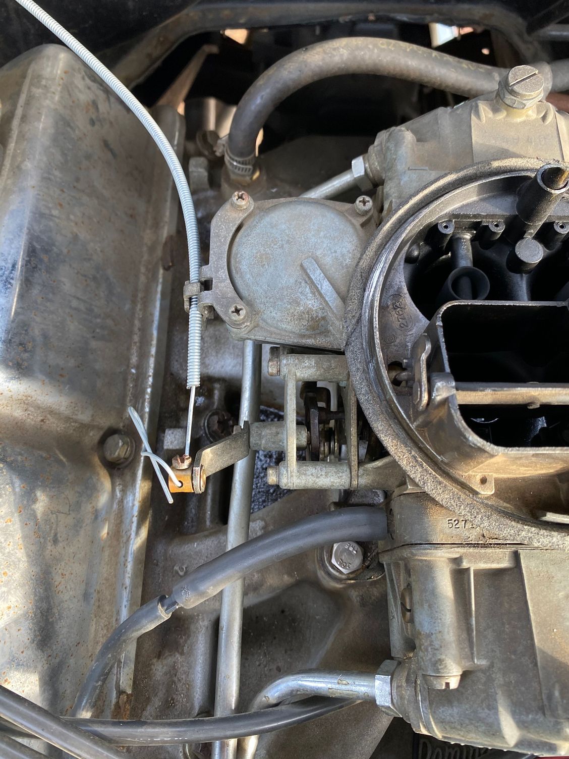

I'll let my truck warm up, choke works good. My idle screw is set at around 650 rpm. I will be driving through town at operating temp and next thing you know im idling at 900-1000. I find myself messing with my idle screw alot. I just replaced the spring on it thinking that it was a little loose but that didnt seem to do much. I figured i would try having it idle at around 500 so I got out a put it at that. About 10 minutes later at a stop sign, its idling near 100-200 barely staying alive. Its really annoying because I find myself having to stare at my tachometer but I have no idea what could be causing it. Any help would be greatly appreciated.

Auto choke or manual choke? What engine? What Carb? Pic of your linkage on the carb? Pic of your choke. All of that will make this thread a bit shorter.

Manual Choke
Rebuilt 390fe with around 2000 miles
750 CFM Holley Street Dominator Carb
Maybe these pictures will help -
Edit - It was a rebuild that was sort of butchered. Had gotten the truck after it as rebuilt and theres still a lot of flaws to perfect.

Squirt some Silikroil on the lower shafts. They could be sticking due to heat expansion. You might need a spacer to stop the heat.

Is your vacuum advance hooked up?
If it is, ported, or manifold vacuum source?
Manifold vacuum to the advance can cause an erratic idle.

Agreed, I see a line coming off your ported vacuum fitting but I don't know where it's going. and even if it's connected properly your vacuum advance can could be sticking.
A bad vaccum leak, such as your booster could cause it.
The spacer would not be a common cause.

Like he said it happens after warm-up. That would make me suspect of heat making the metal to expand causing binding. also you should be using studs not bolts to mount the carb.
