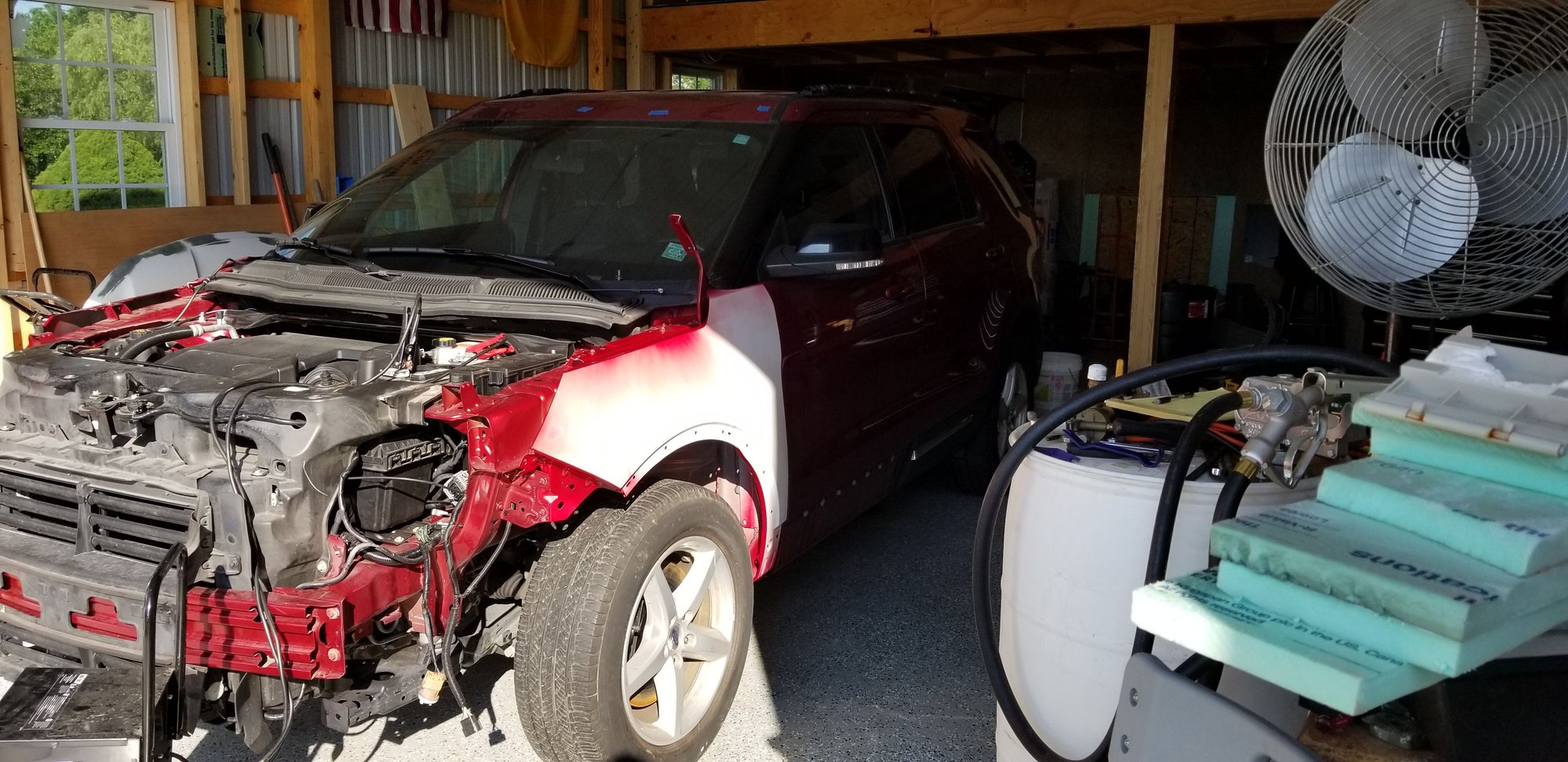

We wanted to get a newer Explorer for my wife since her 2008 was starting to nickle and dime me to death, along with it being on (as of early December 2020) its 8th waterpump and about 7 front hubs. It also has about 188,000 miles on it. So after looking around and not wanting to spend $20K plus on a low milage Explorer, I started searching COPART for a salvaged one. In March of 2020, I found one and brought it home. The following week, I bought another one that was wrecked in the back end for parts. We wound up spending a little more on rebuilding it do to some issues that I will go into detail about later on in this story. It also took longer to get through thanks in part to COVID for numerous reasons.

I sanded down the hood and fenders. While sanding the hood, I also found a few areas of corrosion right under the front lip. Forgot to get pics of that. But I removed the corrosion and then treated and primed those areas. Then I took them to the paint shop and had them edged and the underside of the hood painted. In these pictures you will notice the blue painters tape. On the doors, it was just minor dings and dents that a paintless dent repair guy took cars of. But the ones on the roof.....well this is the next area that cost me more money than anticipated. Whats hard to see (and I could not get a good picture no matter what) were three large dents in the roof, all on the body line where the roof changes slope. Those wound up costing me an extra $1000 in body work and paint. If I had gone and saw the vehicle before buying, I do not think I would have gotten this one and just waited. But here we were and I was not going to turn back.

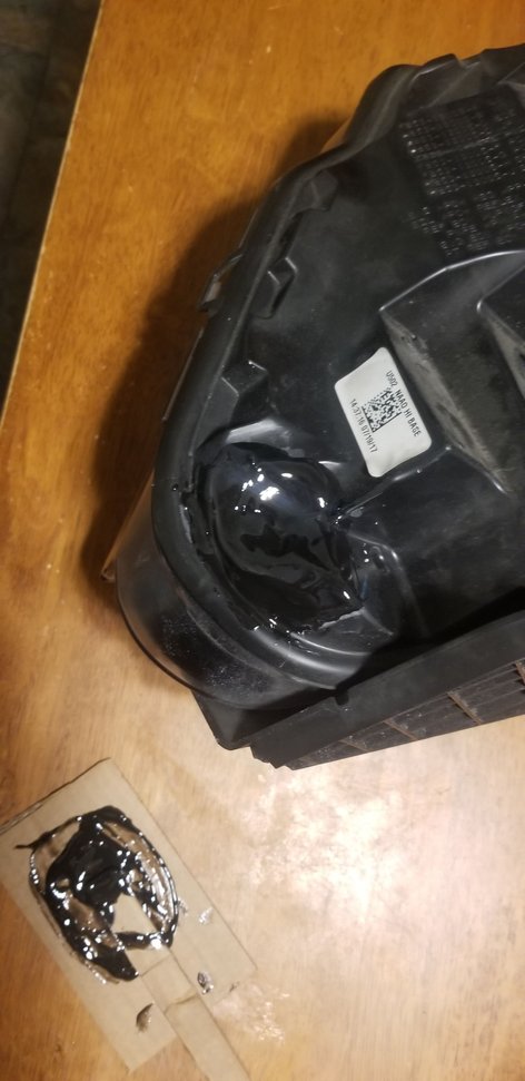

This was the headlight from the red one. Now one might ask why I just did not use the one from the white one. Well that one was damaged as well. And as I was going through this project, I was selling off parts from the white one I did not need to help fund (well replace what I spent) this endeavor. When it came to the headlights, I gave the guy the option of choosing what lights he wanted. He chose both from the white one, even though they were all the same. Guess he could deal with a broken tab rather than a hole. Ok, no big deal for me. So the first thing I did was make a clay mold of the hole. I then used that mold to make up a piece of plastic to go into the hole. I used JB weld plastic bonder. I then made the patch to fit into the hole, then used more JB Weld plastic bonder to glue it in place and covered the whole thing.

Back from paint and body work. You will notice the blue painters tape on the A pillars. That was to cover the holes for the bolts that hole on the plastic trim on the A pillar. Due to the hood getting shoved back, it broke the bottom of the trim off. And believe me, no matter what, you can not take it off and re use it from a donor. At least they were not to expensive to buy.
Also I was a little annoyed with the paint guy. As you can see at the bottom back dog leg of the fenders, he chose not to paint that. Yes its covered by trim, but the amount of time it took to tape those off and probably still covered in paint, probably was more than what he saved in paint and clear.
