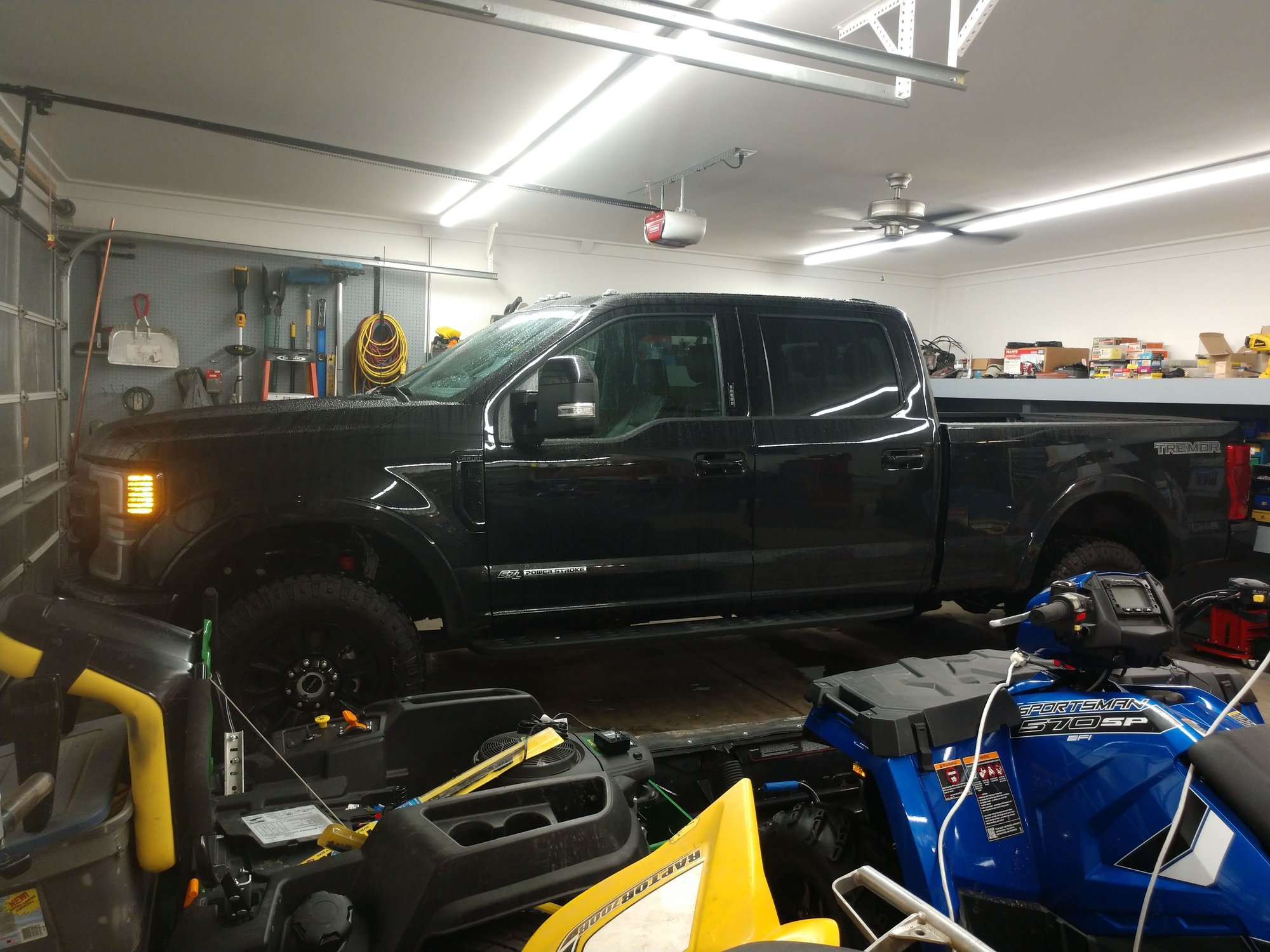

FWIW....6.7 350 Tremor Sport Lariat Ultimate.
I probably tow the heaviest out of this website with a super duty. Personal I wouldn't be worry about it.
