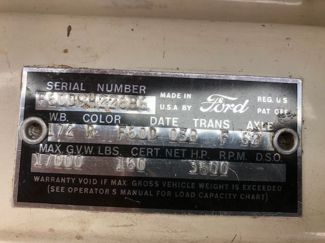

What do I have here?
I brought this gem home on this chilly Christmas Eve. Can you experts out there help me with some history. I haven't seen dual rear axles in any book that I have researched. The front axle is driven and the rear axle is a copy of the front with the exception of the front of the rear has a blank out plate. The rear of the axle looks the same as the front. No drive shaft connection. The axles are mounted to the frame with a Hutchens 7700 series suspension system. I only know this because I just rebuilt a Eager Beaver 20 ton tag trailer and the suspension is Identical. The only thing that needs immediate assistance to use around my farm is the Accelerator firewall linkage is almost seized up.

According to the tag, your truck was originally a single axle. I've seen quite a few trucks from back in the day that people put a tag axle made from a pulling rear axle with the chunk removed and a plate over the hole. A lot of them used trailer suspension since they are plentiful, cheap, and light.The main problem with trailer suspension is not a lot of articulation, leading to getting stuck easily.

Field built tandem. VIN shows as a '59 F600 292 4V. Similar to my dad's '58, but with added axle and frame. He had a 14' bed, that looks a little longer.
FAIK, Ford never did a tandem F600. They were 700 or 750 and up, designated "T-700" etc. And as you describe it, this isn't a factory tandem setup.

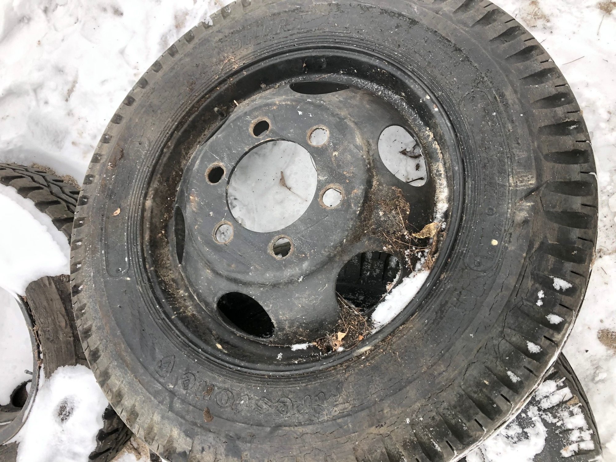

Check those wheels. Could be widowmakers!

The fronts are widow makers. Please guide me into a safer alternative. Are they available. Also included was a complete set of wheels and tires. I will review which ones have the split rims

Wheels with locking rings are safe if handled correctly. WM on the front--at least if they blow up, the ring goes inward instead of into whatever you're next to.

Is the issue with the Widowmaker an issue with changing the tire improperly or do they just "explode" at arbitrary times or is it someone trying to remove the lock ring prior to deflation of the tire. Would love your take on them. I'm pretty careful with things like this and do replace my own tires on my semi and tag trailer. They are not lock ring type rims but big and scary at times setting the bead.

I had a rear one blow apart as I was driving down the road one time. Quite the explosion, and the fun of watching the tire and half the rim pass me in the oncoming lane of traffic.

Take yourself to school by doing a Google search for the trade name of these rims - Firestone RH-5°. Stu

The WM wheels are unpredictable. Many millions of miles have been run with them without incident. But, age, rust, fatigue etc conspire with the design to allow failure with catastrophic results. Must fatal accidents are probably after assembly when an error, wear or just bad luck combine to blow the wheel while it is being aired up. In service, an impact or low pressure allowing deformation could lead to the wheel coming apart. In short, plan on replacing them. As Truckdog suggest, do a search and see how these assemble, then ask yourself if you'd stand next to one.

Here is what I have as part of my deal.
Two of the tire/rim combinations are 22.5 inch rims with 6 bolt centers. I assume these were purchased for the front two by the previous owner. I have the two that are on the front that are different than the ones on the rear. I believe the ones on the rear are the Firestone......Widowmakers based on the research that I have done. The front ones are the face/locking ring type rims. Are these the same "dangerous" rims or are they less "dangerous". I'm not downplaying the issue just want to know what I should be spending my money on. Seems like the military type that I have seen on ebay have this type (picture included).....or simular.....face ring. In your opinion, are these viable/useable tires/rims. I definately have the widowmakers on the rear duals of my truck. They don't have the face ring as this stack of military tires have.....they have the ring on the center section of the rim.
All opinions are welcome. I am new to these "monsters"
If these military are viable options, I think purchasing 8 for the rears and use the two 22.5 for the fronts would be my plan.
