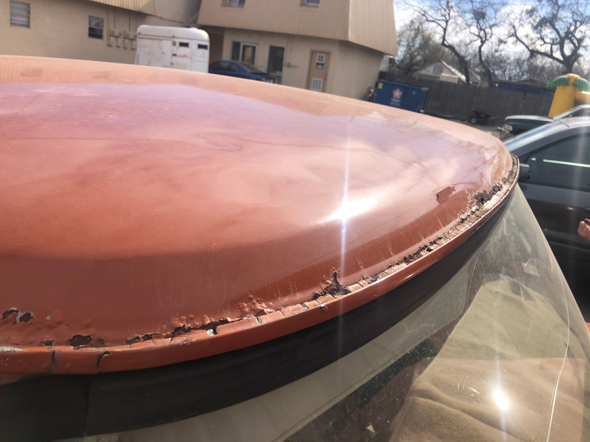

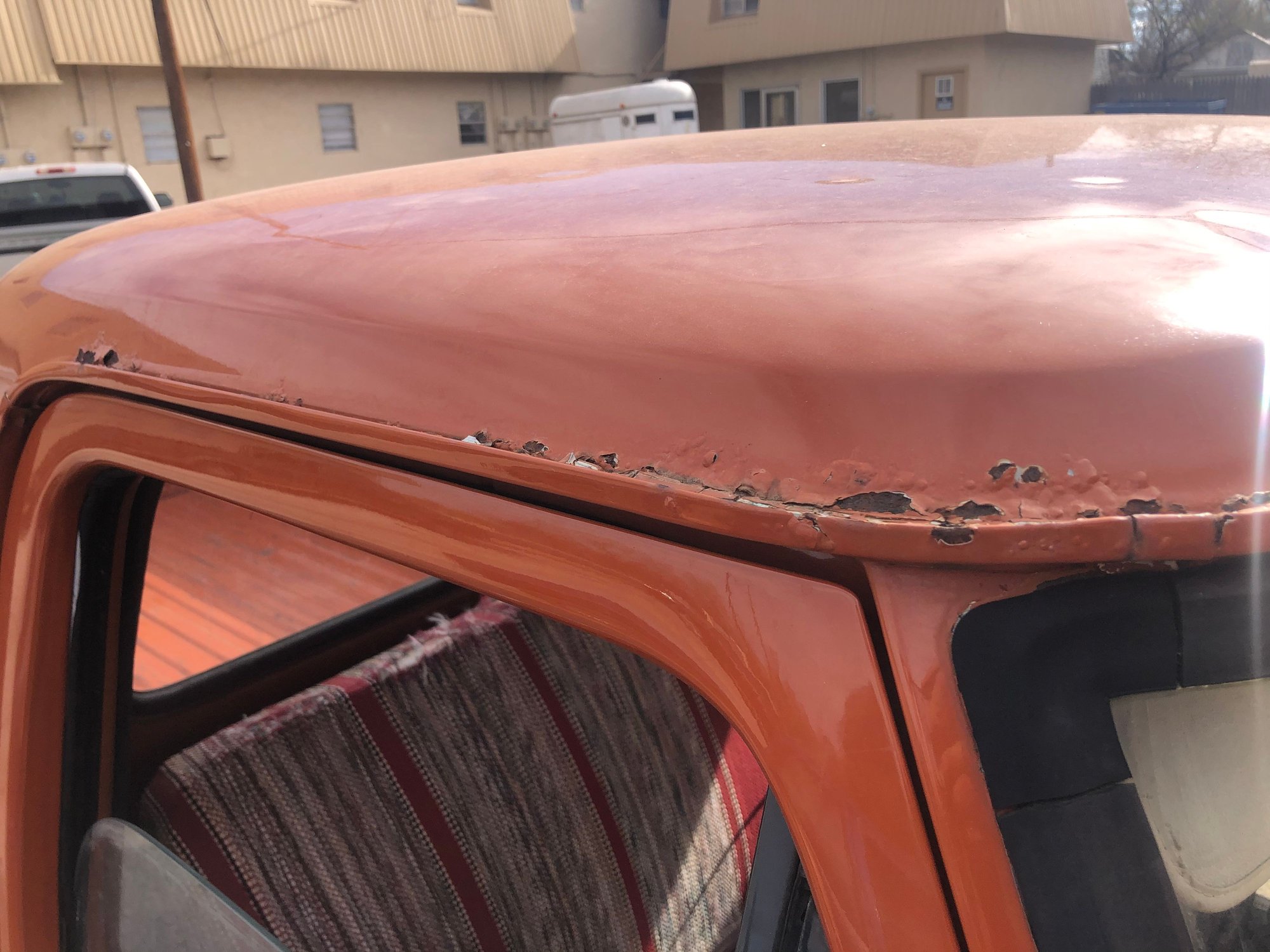

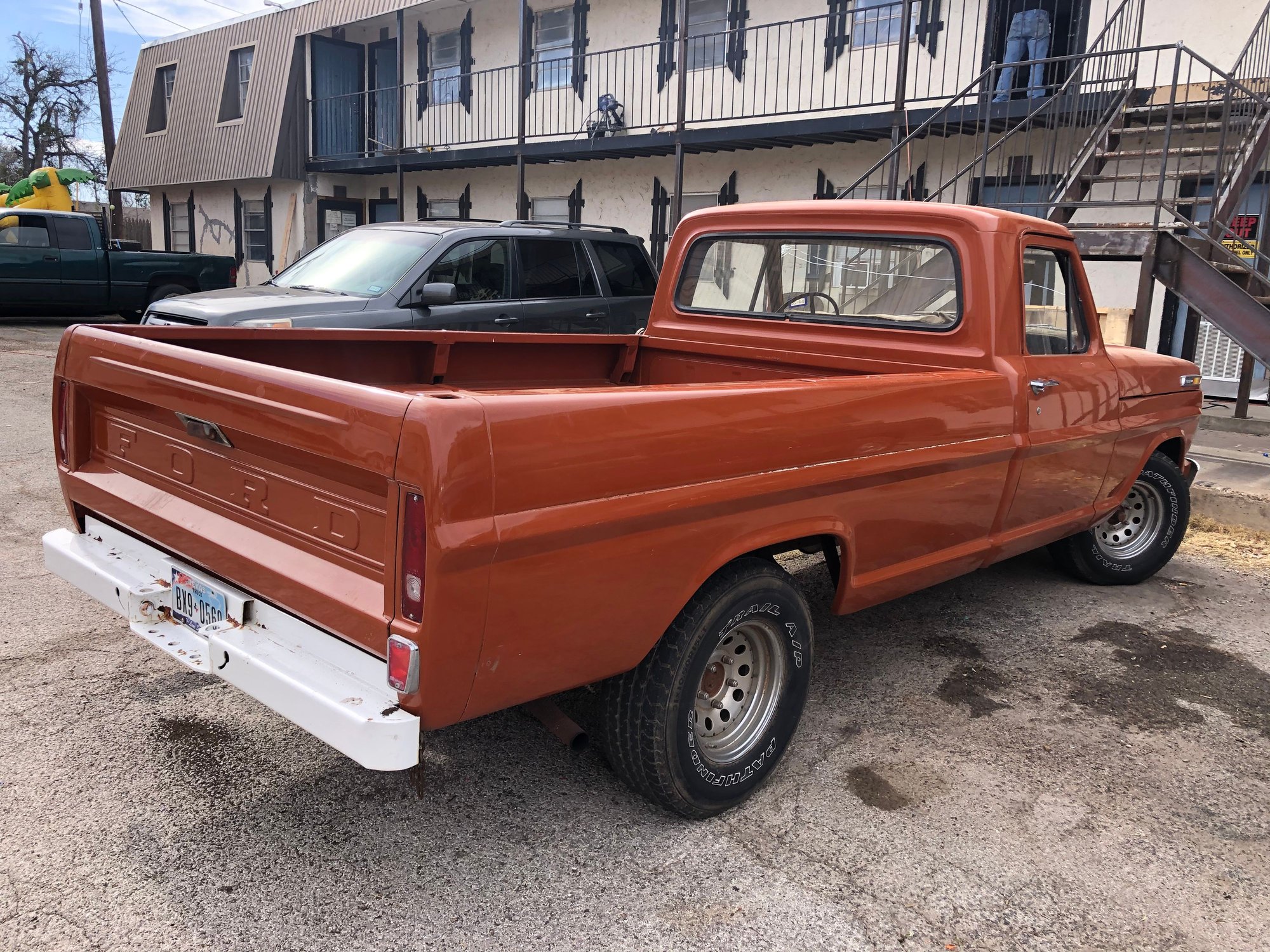

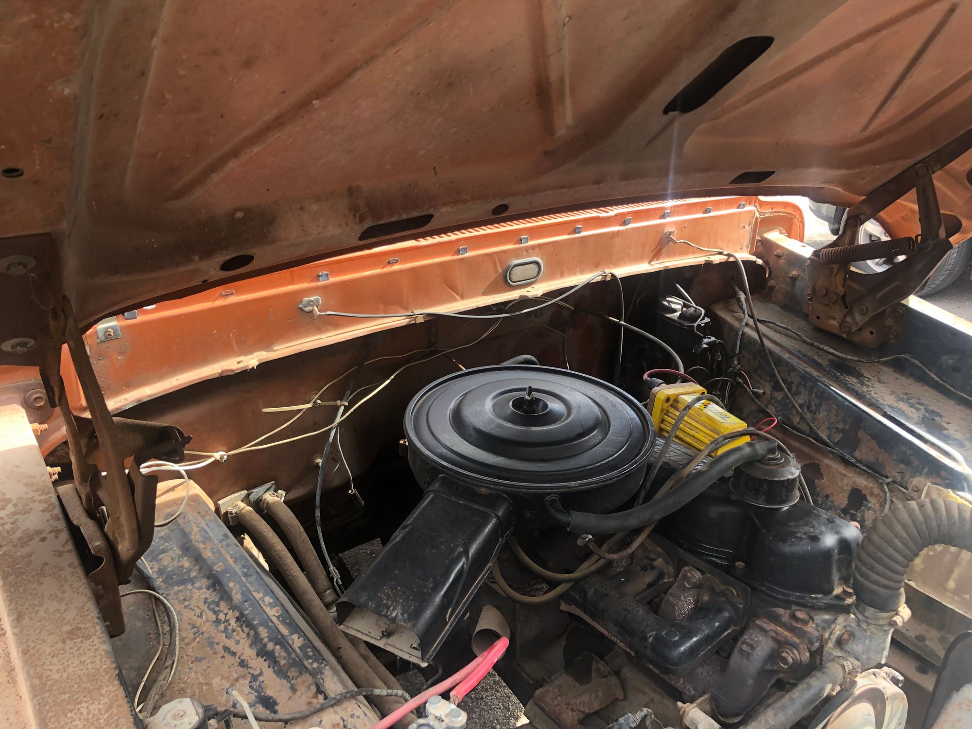

I looked at this one today. 1969 f100 with straight six and 3 on the tree. Bad re-paint on it, but looks pretty straight.
Does the cab roof look like a major problem? Anything else that would scare anyone off?
Of coarse the six cylinder will be gone. We will definitely be dropping an engine in and painting at some point.

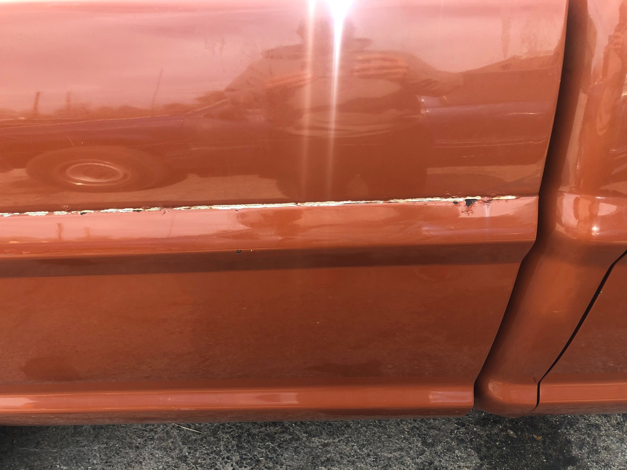

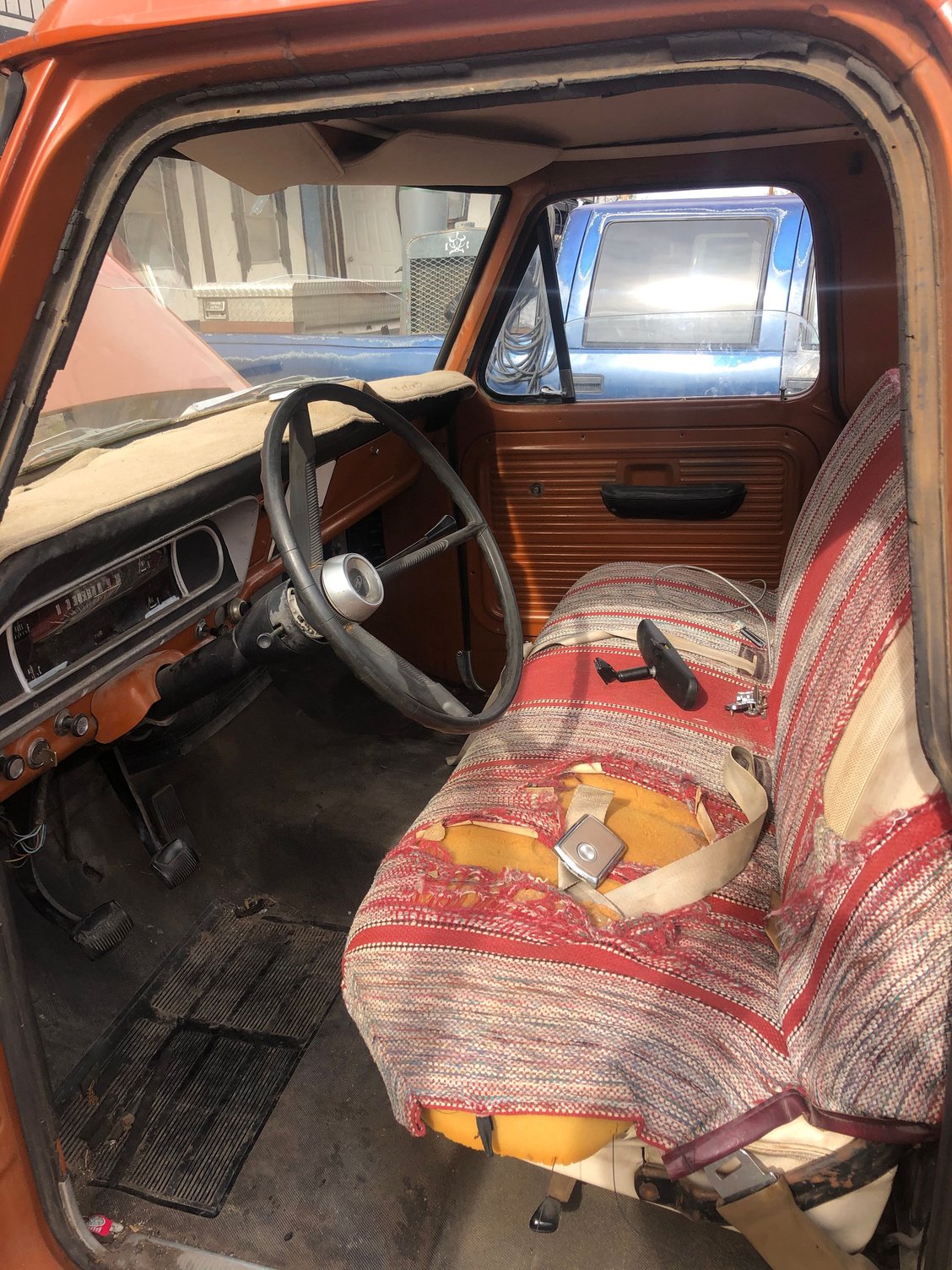

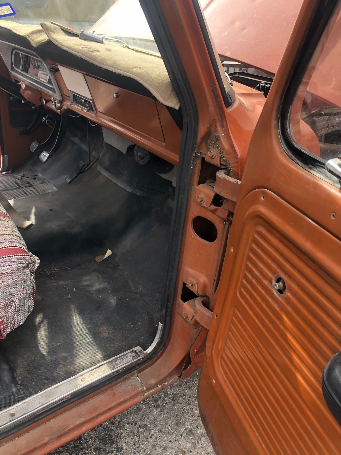

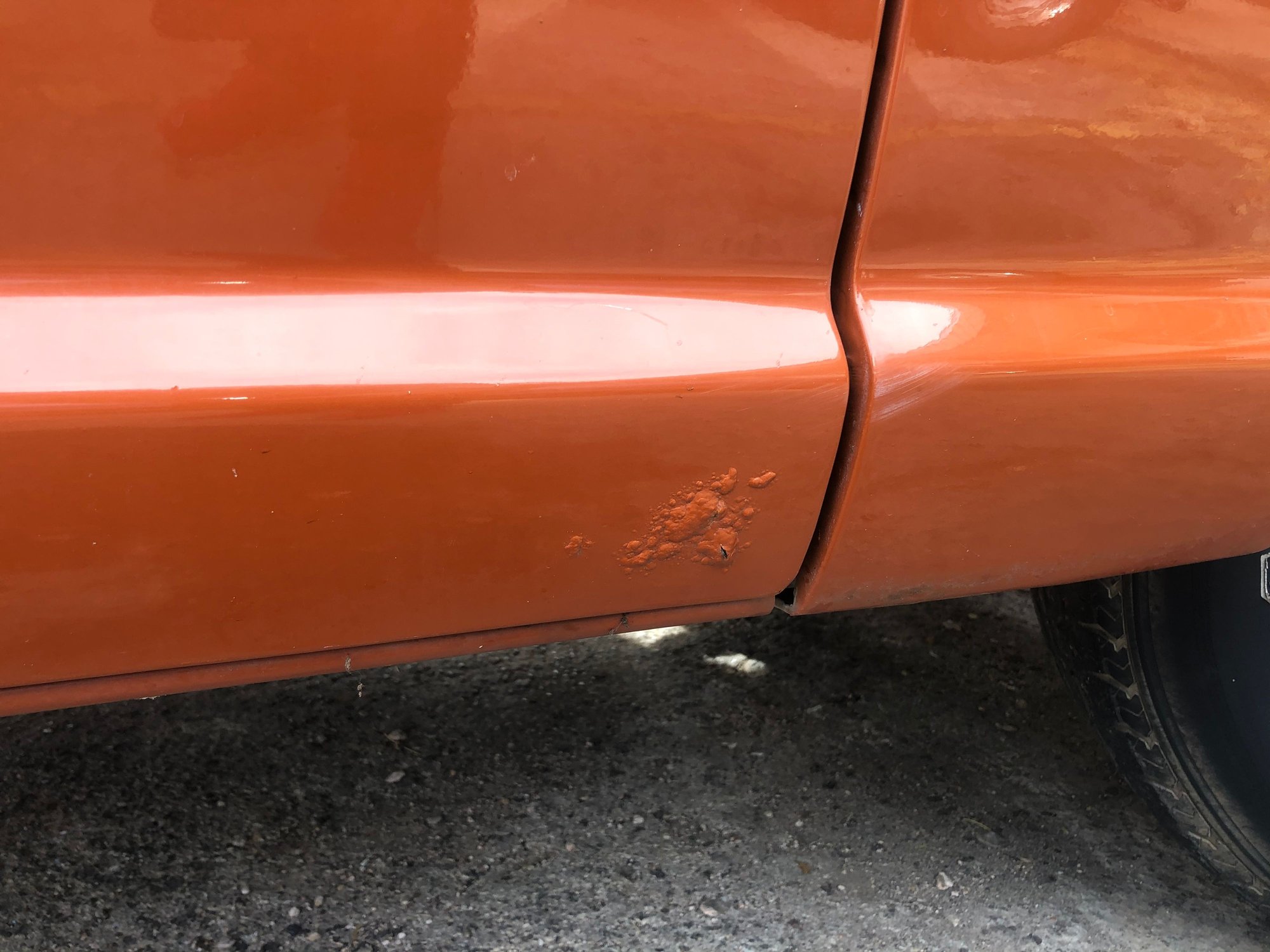

Couple more pics:

I would pass on this one. Too much rust. Especially that roof rust.

Keep in mind you (or your son) will spend a ton of money and time on it if your expectations are high. There’s something to the other kids wanting new trucks and it’ll take money and time to have a new running truck. They’ll be driving by and honking when there’s a breakdown. That roof rust looks like mice are in the roof channels and it’s rusting inside out or just a bad surface prep on the repaint.
