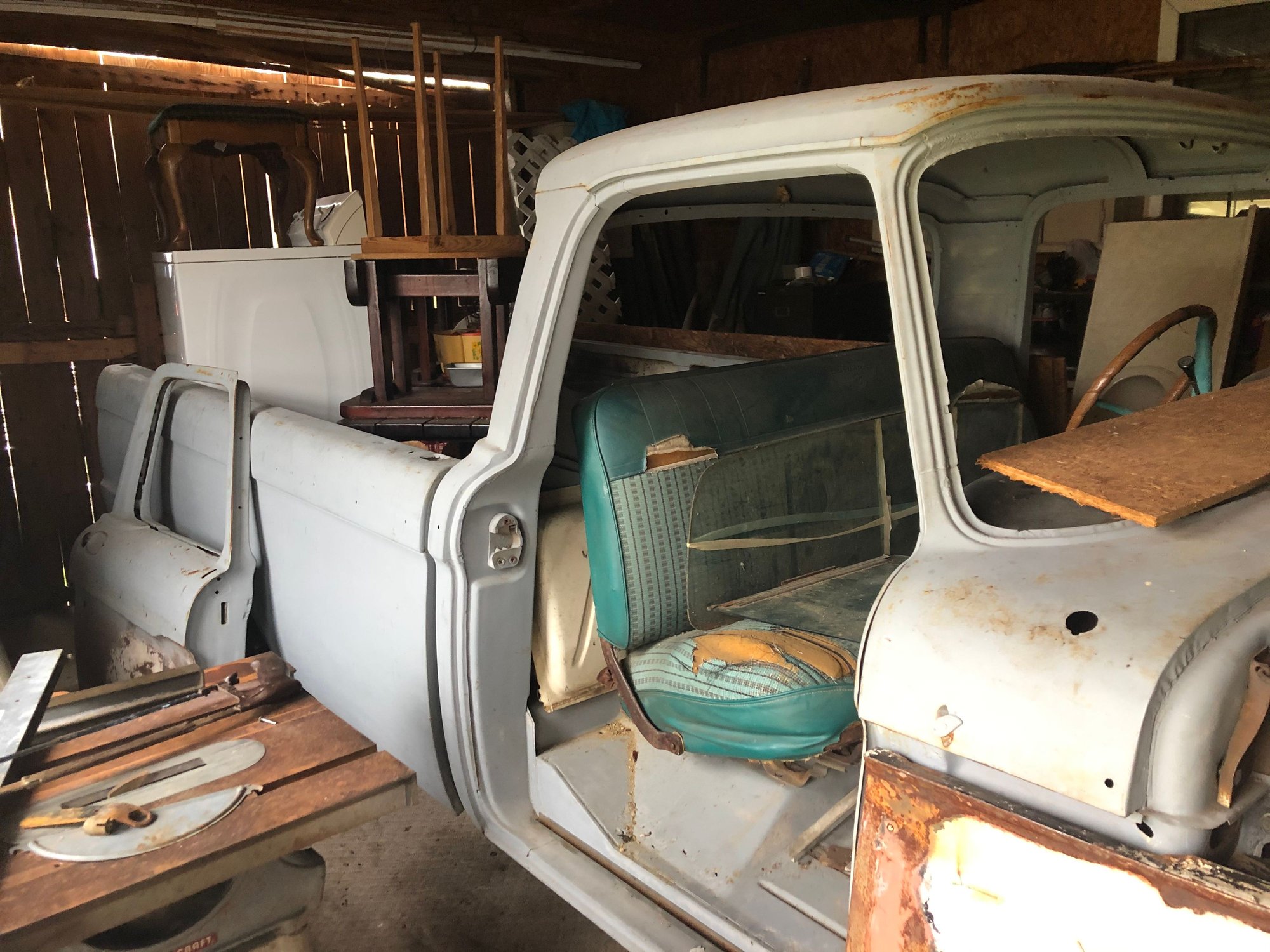

A very Close Friend of mine knew I was looking for a truck to install an engine I have in. He Found a Cousin of his with this tired 1966 F100 long Bed. original engine was a 352 FE, Auto. It died of old age and he stripped body of about everything but the windshield. That became broken when he tried to install a 302 automatic in with trans on it. He kept the 302 and Trans. I bought the rest. Came in a lot of boxes. This was in early March of this year. Body has rusted thru floors, bed, lower door halves, some on hood, other places. Tail gate is toast. Will be a challenge.
First priority is the Suspension, running gear, steering gear and brakes. My plan is to lift the bed off, rework the rear suspension, rear gear, Rear Brakes, parking Brakes, etc. Front fenders and inner fenders are off. Reworking all moving parts. Installing Front discs. Sway bars front and rear. That’s mostly done. Pictures to follow soon. Working on Engine now. More soon. Zeke.

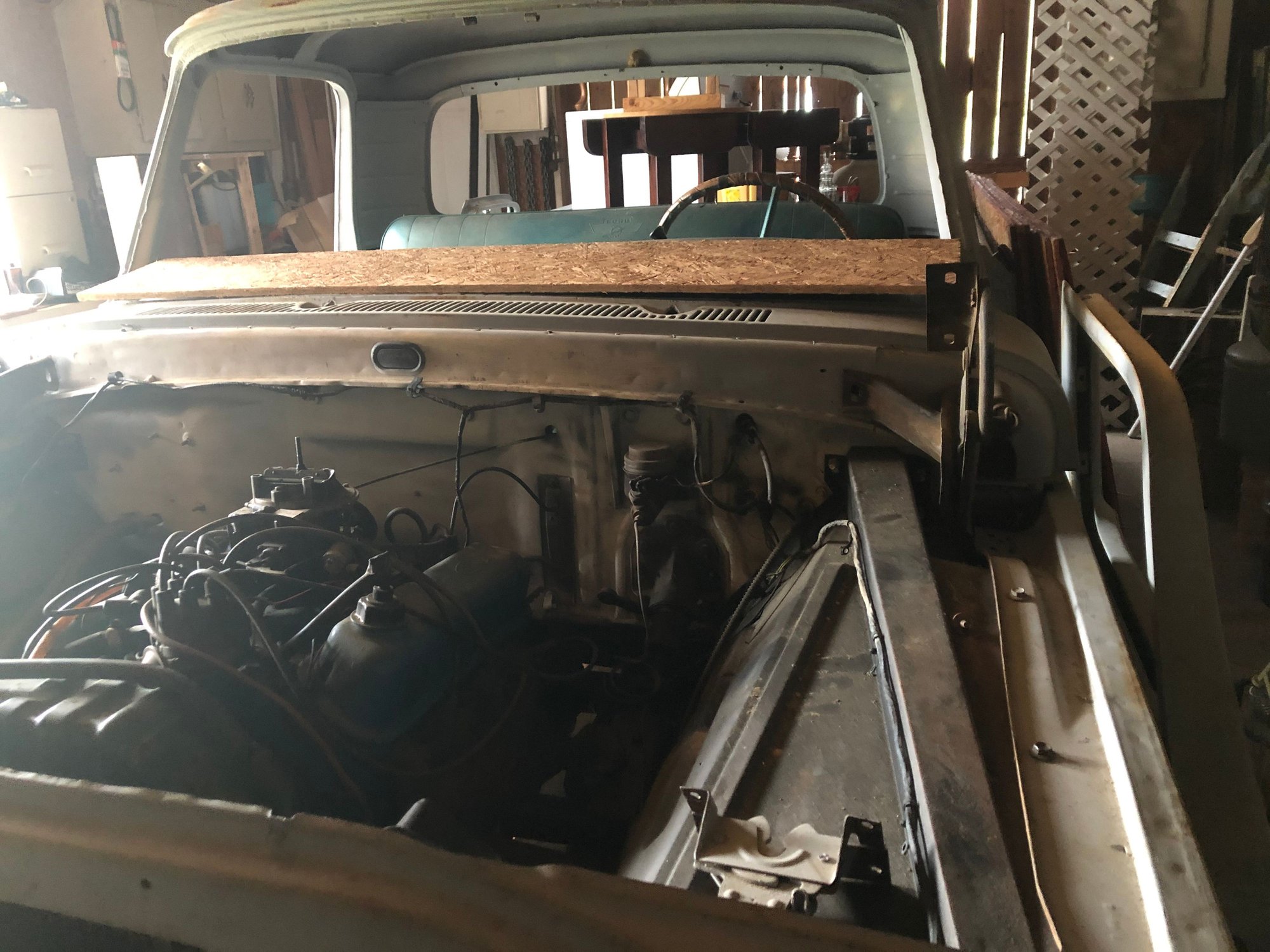

The Beginning, 1966 F100
As found in barn

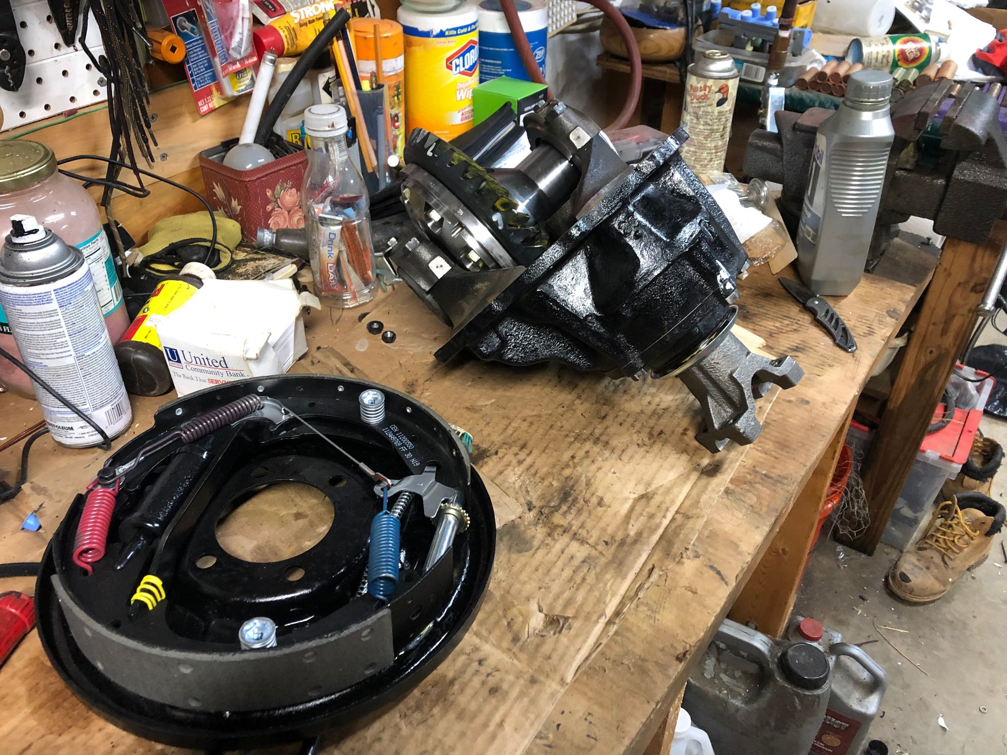

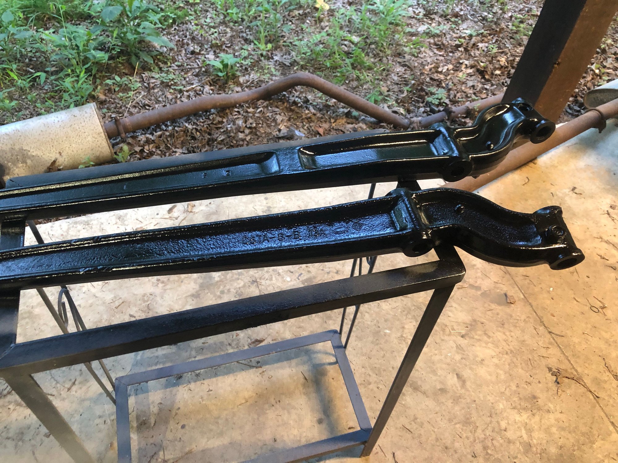

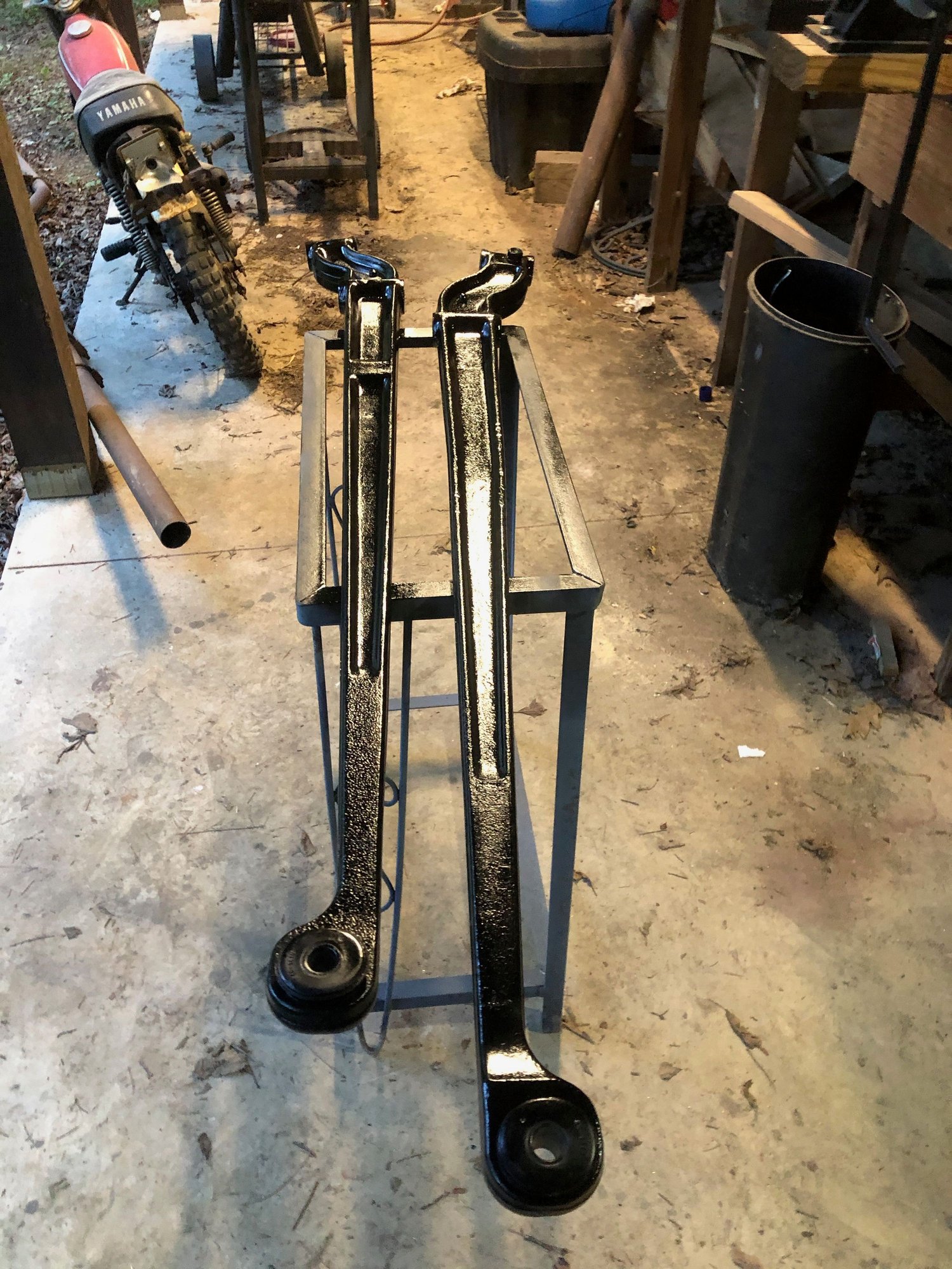

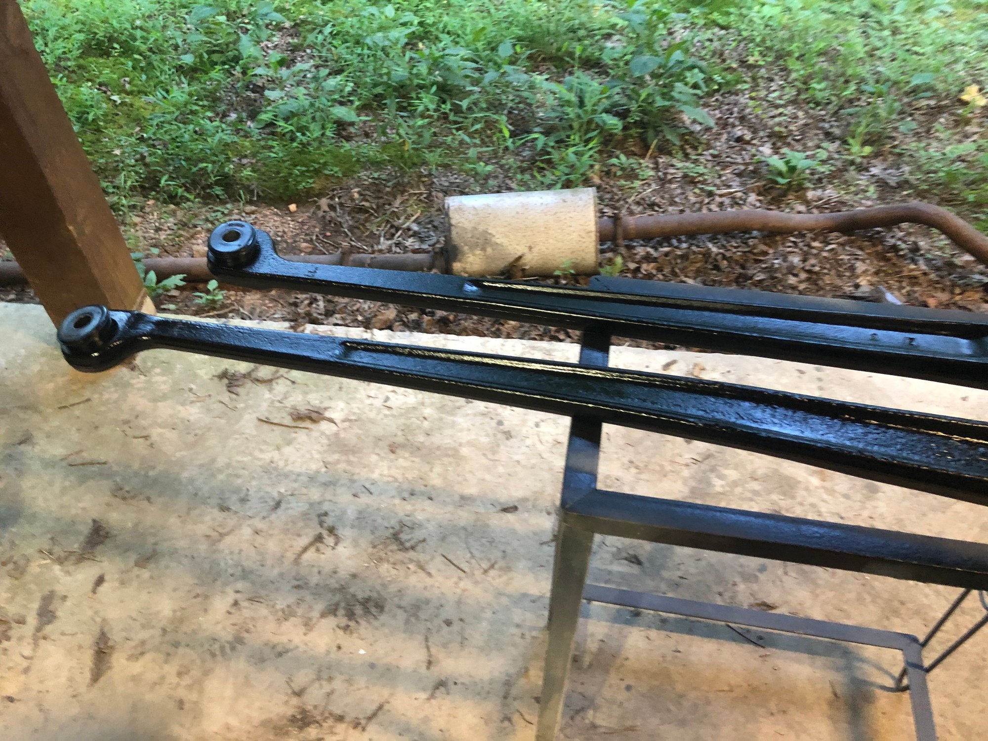

More photo’s
Photos from earlier in year.

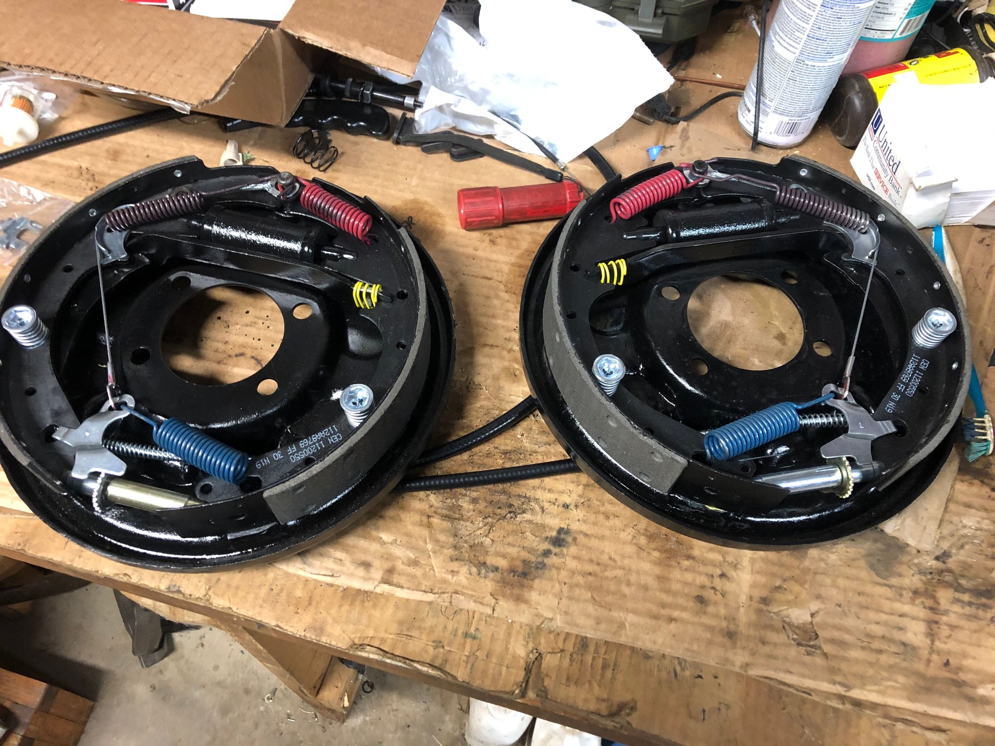

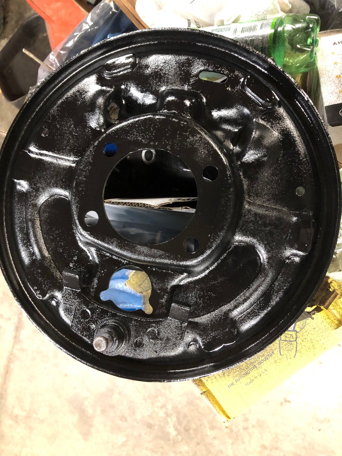

After a lot of sandblasting and some welding rear backing plates are ready to assemble.
Rear brakes assembled.
My assistant checking my work.
9” rear rebuilt, new bearings, limited slip, new gear set

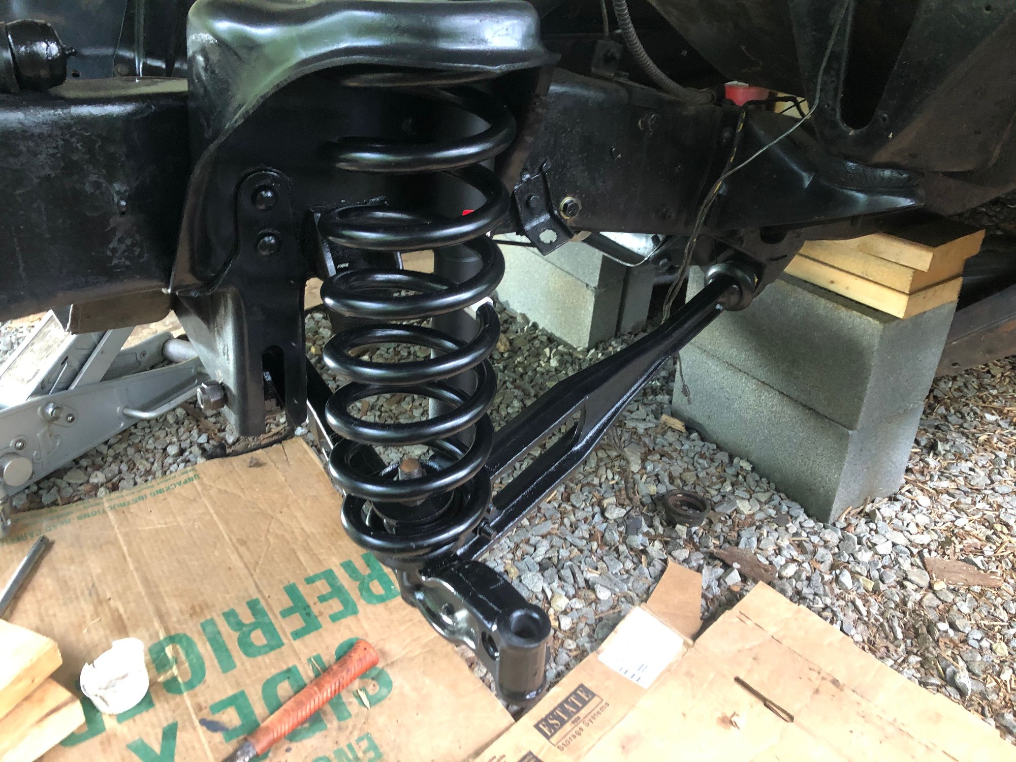

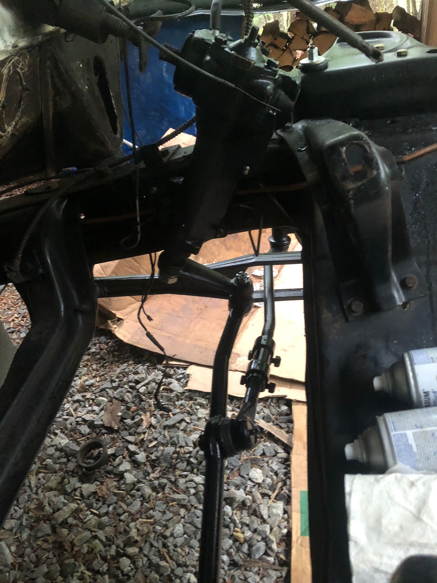

Finished rear suspension, rear end including new axles, shocks, bearing, gears and pose unit. Mounted anti sway bar kit, new paring brake cables and more. worked forward to front suspension. LOTS of sand blasting, new bushings, front Springs, drag link, ty rod, all bushings, a front disc brake kit and spindles with new King pins. front anti-sway bar also. Can't finish it till engine, trans, and all other weight are in. Duel master cylinder and proportion valve to be installed after cab is reworked. also new steering gear and coupling. About as far as I can go till engine and trans are installed.
