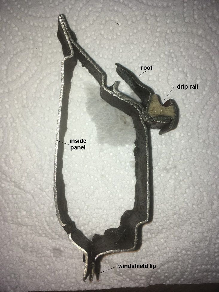

Hope this helps, I cut a small cross section off, The right side is the outside front edge.

Yes thats what I needed . Thanks . Now if I can jut get my brain oriented to which way it sits . LOL If I have it right it is pictured upright , the lower portion is the windshield opening lip with the seam fill driprail above it on the right and the discontinued piece being the roof skin .

this look right ???

Yes John, Glad you did that because I did not know how!!! Thanks Larry

Perfect thanks guys . Thats how I was looking at it but also I am not savy enough to do that .

That is a great photo, much better than the drawings I have seen. To seal the drip rail seam I have been running some KBS Rust Seal down between the roof and inside panel, now I see exactly where it's going and more importantly where it's NOT going. To get to the windshield pinch weld I would have to drill an access hole in the inside panel or possibly go through the rear view mirror mounting holes.

I don't think Henry could have found a convoluted way to stick things together... that very thing kept me from removing drip rails... we just filled them

I'm not committed to it yet but am contemplating taking an inch or so out of the section above the windshield . I think I prefer the drip rail but came to the conclusion that along with some rake on the truck that this would create a place for water to pool plus complicate the sectioning process . The fact that the roofskin appears to be be liberated by cutting the drip rail should somewhat simplify my pondered plan . And yes charlie it definitely shows where anything put in there will go . I will probably stick my undercoat hose in the visor holes .
