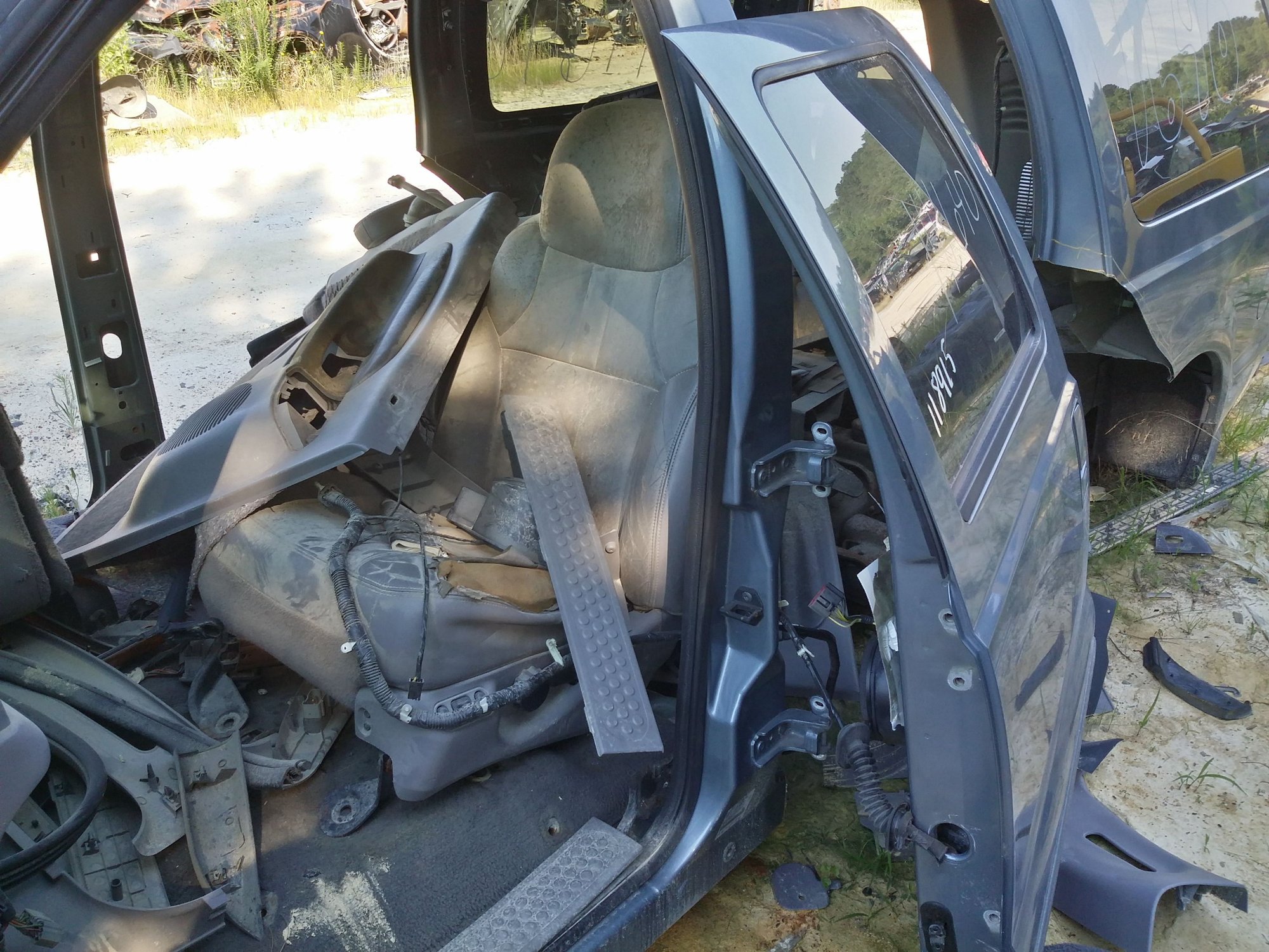

So I'm trying to take off the driverside rear passenger door to fix some rust, where does the wiring for the door disconnect at? I can't find anything in the door?

Exhibit "A"
Behind the "B" Pillar trim.

Mine does not appear to have a connector there? All I can see to do is disconnect the wiring from the door components and pull it out
