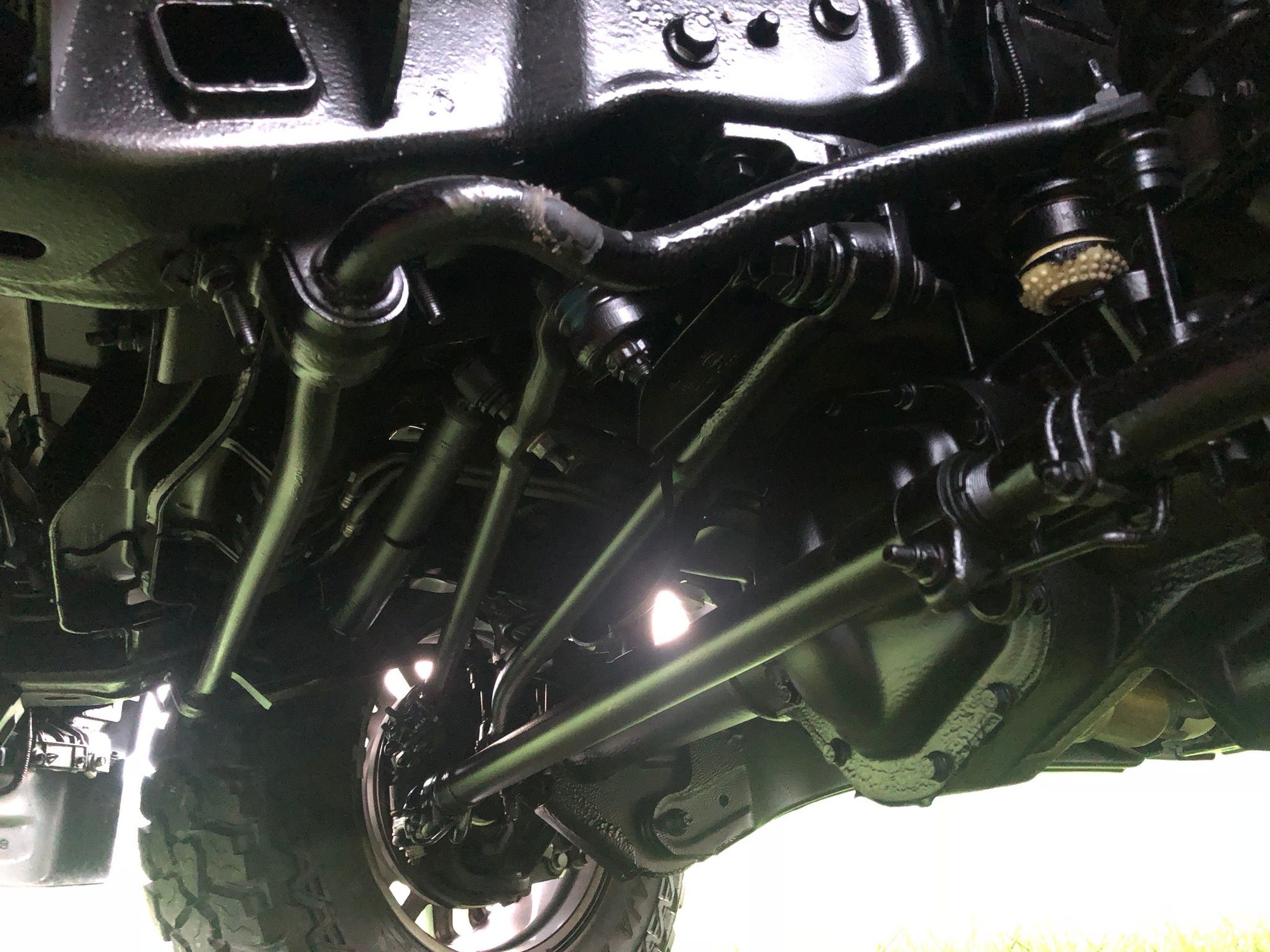

You are almost certainly rubbing on your sway bar too, whether you are noticing it yet or not. Pictures below to illustrate from before I replaced my sway bar.
If I had to do it over I would be looking at Carli sway bar and Lewis built radius arm (provided Lewis returns calls and gets a shipment out - people have been having problems there).

Yes my standard advice definitely is put the tires on and go from there. If you do a bunch of stuff all at once you’ll find yourself wondering where the issues crept in if you had them. Starting with tires is a great place to start on these trucks. Being at risk of crinkling fenders would scare me (not an issue with OEM wheels on these trucks, but I’ve gotten close with other vehicles), but sway bar and radius arm rub only at steering angles you do at slow speeds is only an irritation. No real risk of damage. If you can acclimate to it and aren’t too **** it’s a fine way to drive. As I’ve said in other threads I took it as an engineering challenge as much as anything... and wouldn’t fault anyone for not going all of the way.
The setup, since I prefer posts with pics
