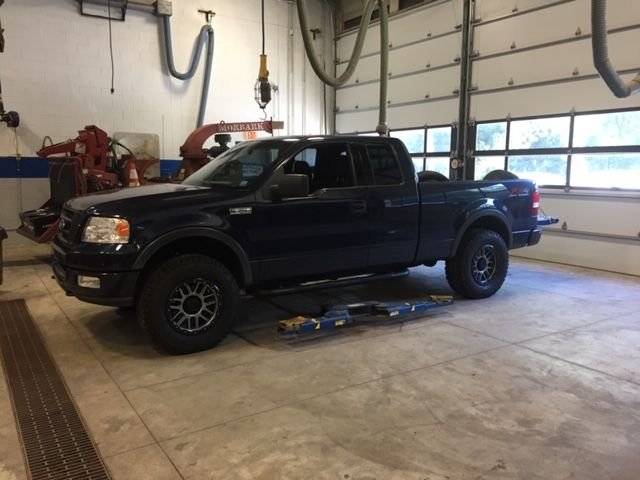

I have an '04 with a 2" leveling kit and 35" tires. No downsides other than a little loss of mileage. 35's fit my FX4 with just a slight trimming of the OE plastic fender flares. 0 rubbing.

Nice truck.

Originally Posted by 85MD
Nice truck.
Thanks. It was almost exactly what I wanted when I bought it. I hate console shifters in PU's, and this one is the rare bench/column FX4 with Blue exterior black interior. I've been thinking about getting a newer truck, but I did put a $5,000+ engine in this one, so I'll wait until it's a lot more rusty. BTW my leveling kit is leveling struts. They're adjustable for dampening. Originally I had it set up stiff, but it was a little scary over some highway bumps with the 35's. It's much better with the strut set full soft. They were less than $100 each when I bought them, but the price has gone up, or I bought them Amazon used.
