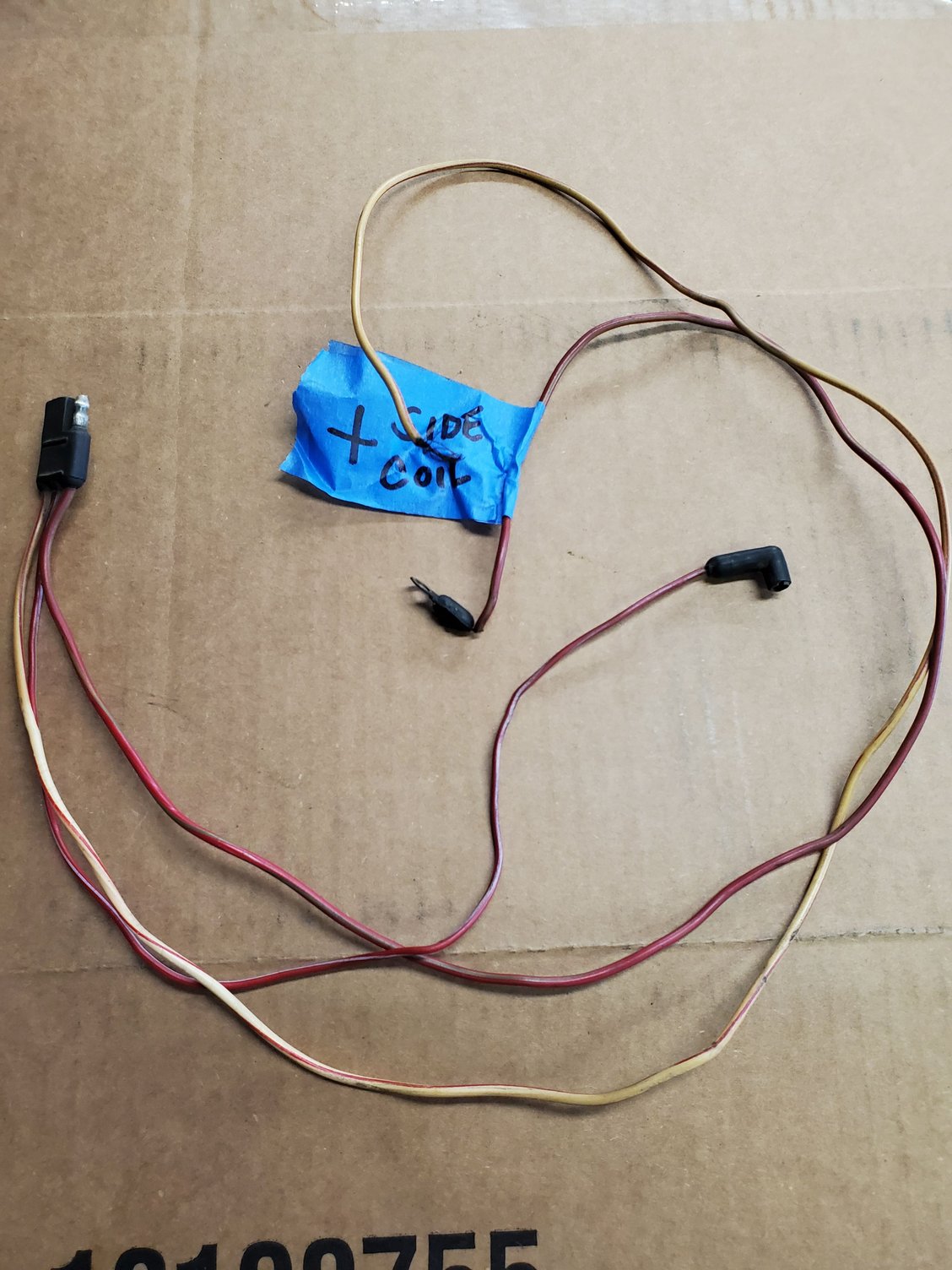

Old Apr 18, 2021 | 11:45 AM
lakechief's Avatar
lakechief
Joined: May 2014
Posts: 34
wire harness
so I'm installing my original harness back into my truck some of the harness was disconnected when I received the truck. this harness goes to coil and the white and red stripe wire goes to oil pressure sending unit and red & white stripe wire goes to temp sending unit correct me if I'm wrong.
Thanks James
