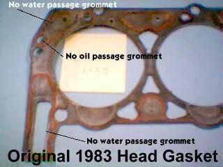

the early 83 had no rubber inserts in the head gaskets ..then they added the grommets for the top passage and the oil hole.... then that was changed and the "O" ring was left out.
in the newer gaskets this is what you see.....
The Top gasket is 7.3 the lower is the 6.9.
This was the original 83 gasket......
on the newer style for a while they did have inserts for the lower passages.
But, Hey Plug the heads.....
