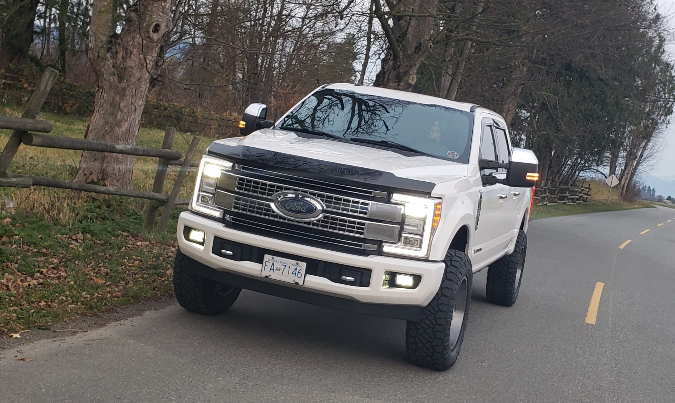

So with the big C taking away my year of traveling to car shows and no winter vacation I'm setting up the truck so she tows/hauls even better next year. I already have the Hellwig Big Wig swaybar installed and just put new 20x10 rims with 295/65/20 Ridge Grapplers (4080lb rating) on to widen the footprint a little. Today I ordered a set of Timbrins to engage the overloads a little sooner and not be harsh like airbags or bigger snubbers. Now I'm looking at shocks and a steering stabilizer with my thoughts leaning towards the Bilstein 5100's for both. Any other suggestions?
Attachment 280657

I dont see any of the items you list as value for "winter condition" driving.....the wider tires might make things worse.
unless you mean winter as in calendar.
you dont need to change shocks , bump stops, etc for the winter

Yes to shocks. I went with the Rancho 9000XL for the adjustability when towing and not towing. An upgrade to the stabilizer may be appropriate with those heavier tires/wheels.

did you have any issues balancing those tires? Im having a great time....

CJONE, airbags are fantastic when loaded as most OTR vehicles are. I figured the Timbrins have zero impact when not loaded, have next to zero potential on the road issues with air pressures, leaks etc. The cost was also considerably cheaper than bags, especially when you add on board air. I'll see in the spring when the slide-in gets out of winter hybernation.
CROTCHETY, a bag of sand works great also and is great weight for poor weather if you don't need it.
STEVEO, these had no balancing issues and don't have excessive weight like I've seen on other tires. So far they ride smoother than my old Open Country AT2's.
SARDIVER, I'll check the trackbar when swapping things.
Today I ordered the Bilstein 5100 shocks and the matching steering stabilizer. The fronts are in stock but rears are on order and the steering stabilizer was special ordered from Bilstein. Wonder when those will get here? lol Not in much of a hurry as I won't "need" them until spring, right now I'm just taking advantage of some sale pricing!

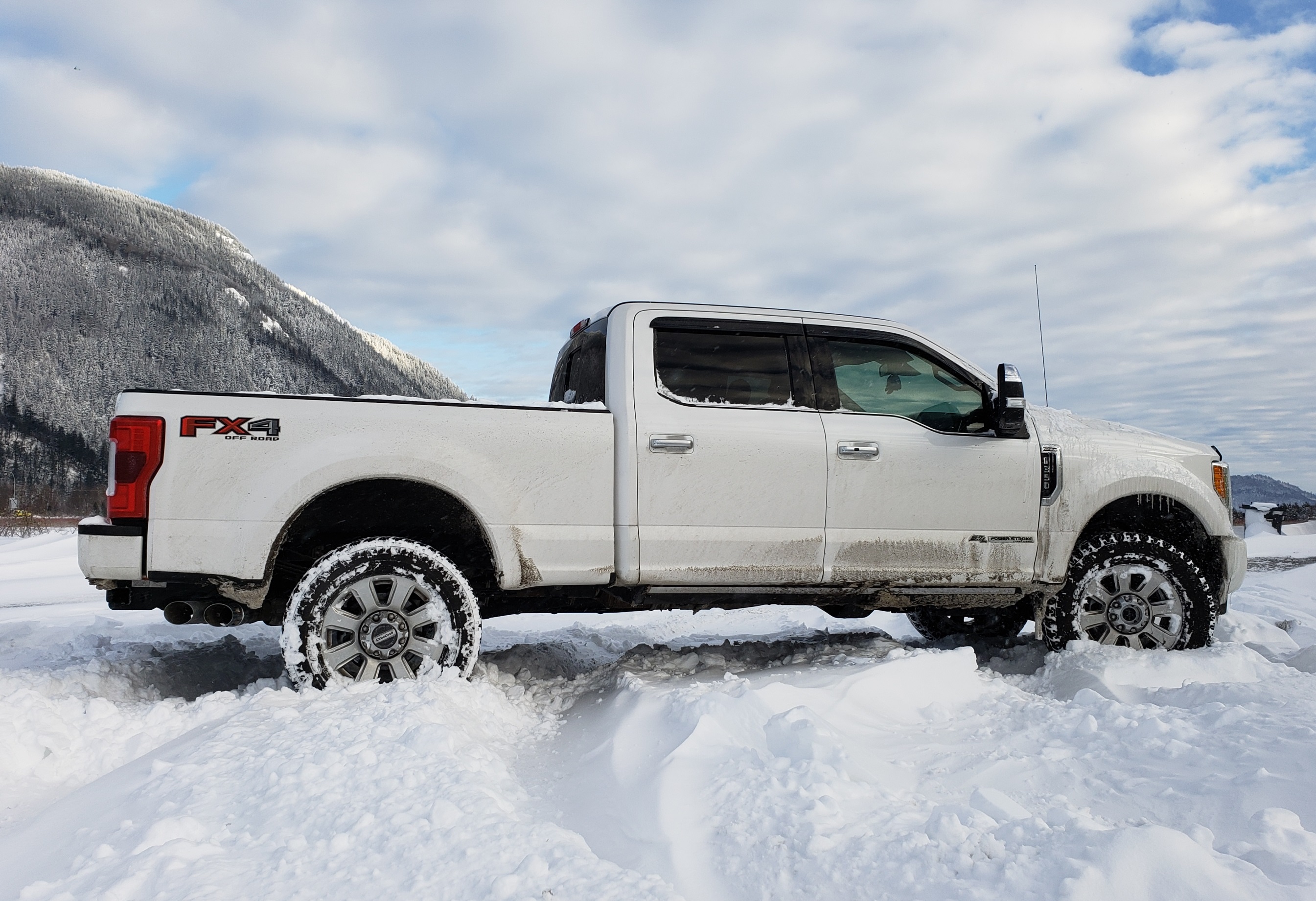

Truck has a nice stance for sure. But in my 40+ years of winter driving, my experience is that a wider tire will ride up on top of snow, spin, and then you're hung up. Depending on snow depth of course. These trucks have some pretty serious ground clearance in my opinion. That being said I was still goofy enough to go for the nice look of the 325/65 on my truck!
I like the taller tire that fills the wheel well. The factory tires looked so tiny. But next time around I'll go for the same or close height but a little narrower footprint. I don't off road or mud bog so floatation is not at the top of the list.
I had the same size tire on the stock Platinum rims, these rims are just wider and have more offset. I had 2 reasons, a wider footprint for more stability with the camper and I disliked the narrow look of the truck from behind! Hopefully these are similar to the Toyo AT2's as they did a decent job in the snow.
Attachment 280844
It's why I qualify my statement with "my experience". Different people have different uses and climates. If your setup works for you, that's what counts. The wheel & tire combo is definitely a good look for your truck.
