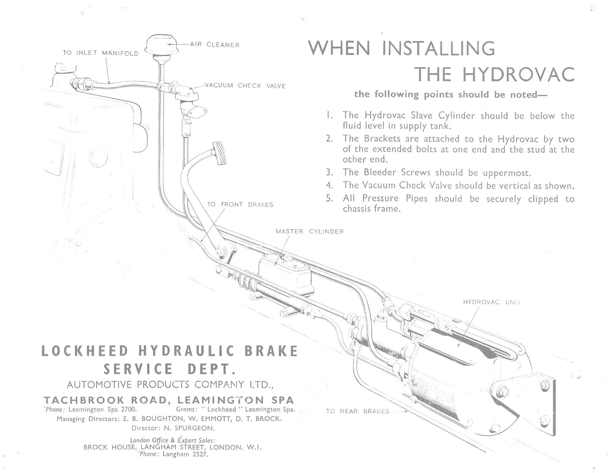

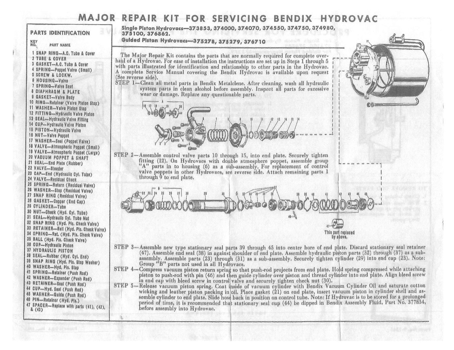

Bendix and Lockheed Hydrovac Info
Couldn't find the thread where this goes, so hopefully the OP will find it.
