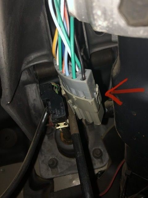

Hello I’m needing some help trying to find a wiring diagram for the steering column wiring. I replaced the piece that the turn signal hazards horn and cruise control act on and I’m afraid I didn’t put the right wires in the right slots because my cruise control no longer works. My horn and everything else works just not my cruise control.
below is the connecting piece I need the wiring diagram for as I believe I didn’t put the wires in the right spots

NOTE: In the OP's picture the connector does not appear fully seated. Could this be part of the problem ?

i tried that and it is not working. I tried changing fuses, changing wires around and plugging it in all the way in and nothing is working. The cruise control was working just fine until I replaced that wiring harness and components
