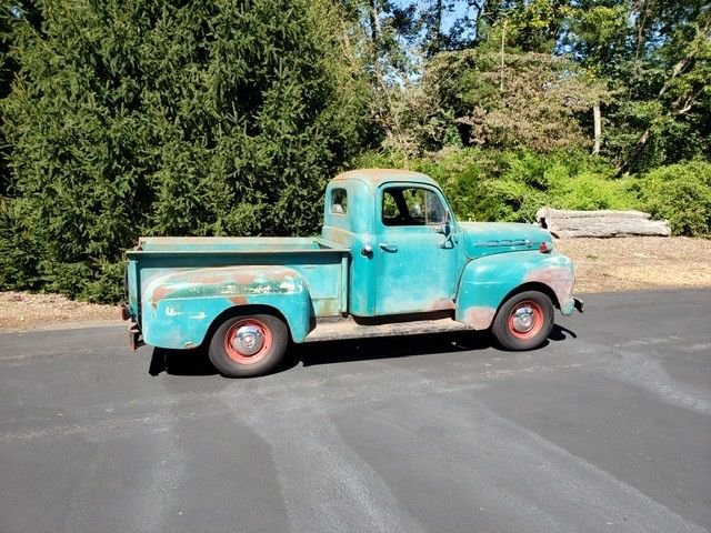

Welcome!
The nose of your truck is 52 with the coveted 6 cyl insignia on the hood. The cab has an early small window.
I can't make out the cowl/firewall stamping from that picture. Can you post one of the beginning of the numbers?
What you show is the vehicle number down the assembly line and what appears to be 1L which would be a November something assembly date.
Also picture of the dash, close-up of the box side would help us sort it out for you.
Tim

Hey Tim
it looks like someone painted the cowl at some point so the only part visible is CS1L639 so would that not be Dec 1st?
the cluster is a 50 style and the bed sides are smooth. I’ll get some pictures tomorrow in the sun.

There should be a number in front of the CS that would indicate the body color.
Your truck was built at Chester, PA (CS) on November 1, 1950 (Henry Ford skipped the letter "I" in these stampings) December code is M. The 639 is just the number of the vehicle down the assembly line and we haven't been able to decipher it any further. All assembly plants did things their own way.
Your picture shows what I thought about the box. It's a late box, probably the same truck the front end came from. I'd guess someone had a good early cab that got matched to the late sheetmetal. While some pieces are different, it all swaps as a unit.
You might check the frame number - passenger side top frame rail close to the motor mount angled crossmember. They're stamped light so you might have to scrub the dirt off with steel wool and shine a light across the top rail at an angle. It should start and end with a stamped hollow star. That will verify whether you have a 50 cab/chassis with 52 front end and box OR a 52 chassis with a 50 cab.
A little more info that may be of interest, my 48 F1 is stamped 12L for the build date. When I removed layers of after-market/farm paint I found the factory yellow stencil date of 11-11-1948. My 48 was also wearing 52 front sheet metal. You just never know.
