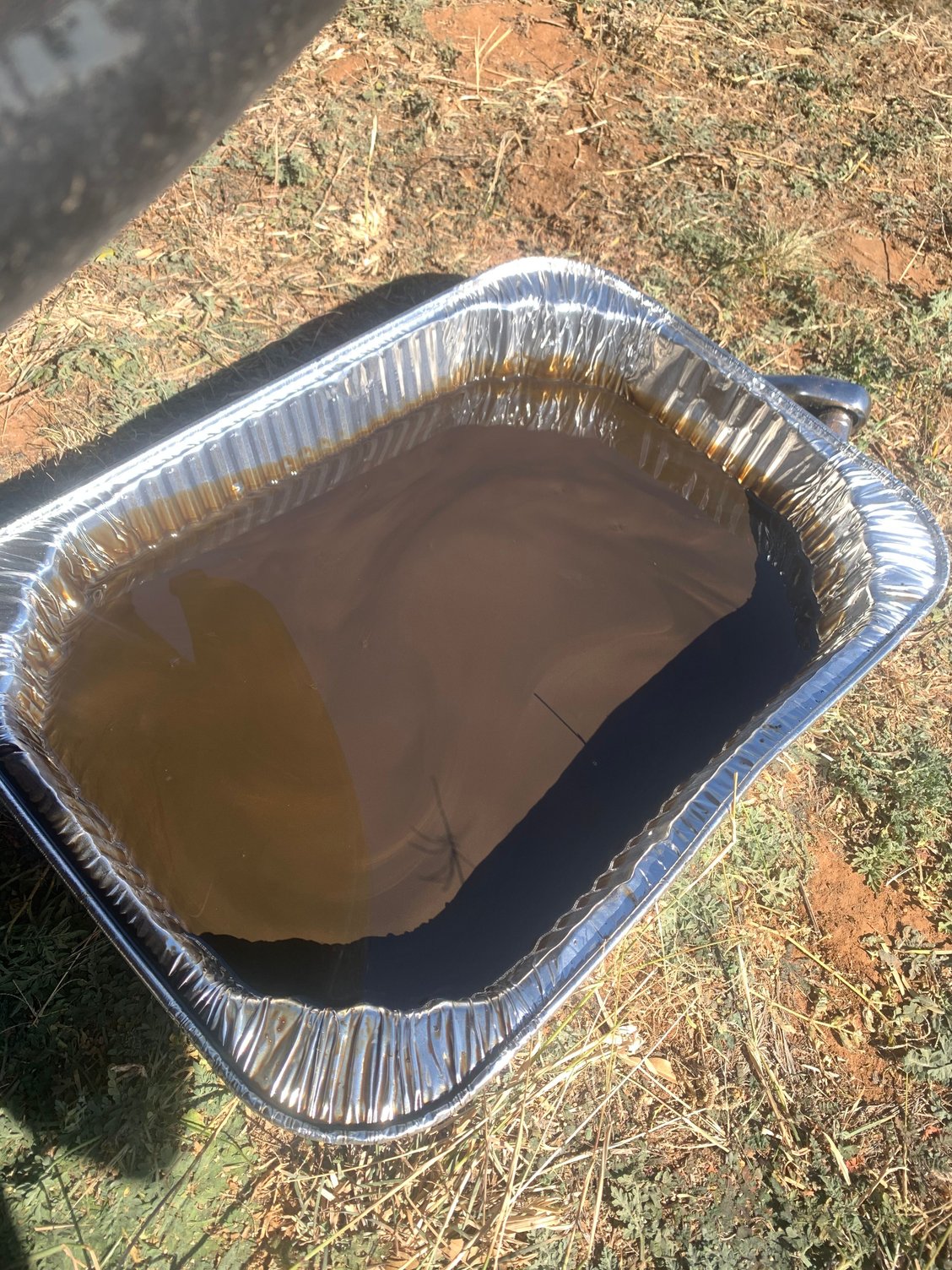

Hey I have a 2001 f150 super crew 5.4 with ~230,000 miles XLT lariat rwd. So I recently (3-ish days ago) developed a knock from what sounds like the lower end of the engine. I went ahead and changed the oil in it again to see if that would help. Just changed it last month. I’m uploading a video of the sound now, and a picture Of the old oil

The metallic swirls in the oil are not a good sign. If its a knock its a rod bearing, if its clacking its the timing chain hitting the cover because the adjusters are blown out.
what would you recommend? Could I send you a video of the knocking?
