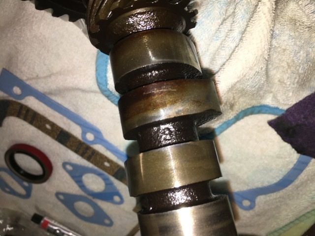

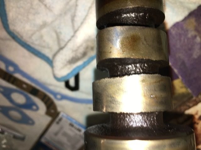

I just pulled my cam out, the bearing look excellent, and I removed the heads and you can see a little cross hatch, I’m beginning to think that the previous owner saying it was never rebuilt was not true. Or at least not to his knowledge.
I have attached the pictures of my cam, it looks okay to me but I’m a beginner. The pictures are the few concerning spots I have, there’s the small areas that look like chips but also look like it was cast and ground that way. I don’t know, and then there’s the dark spots.
Two lifters were collapsed. The new ones I have are slightly taller on the outside, but when you look at where the pushrod sits, it looks to be correct. How can I measure this to be certain?

Head # c6ae reads 66-68 352/390/428 fe. Balancer spacer remove key slide off, had one sheared half way through the key had to rotate it with pipe wrench to line back up with the keyway. Try large washer slide upto spacer then use a short pipe to hit it with a hammer lightly to jar it lose. Pry off with two putty knives for an even pull. Cam i can't tell what shape it is, suggest you get a good name brand.
