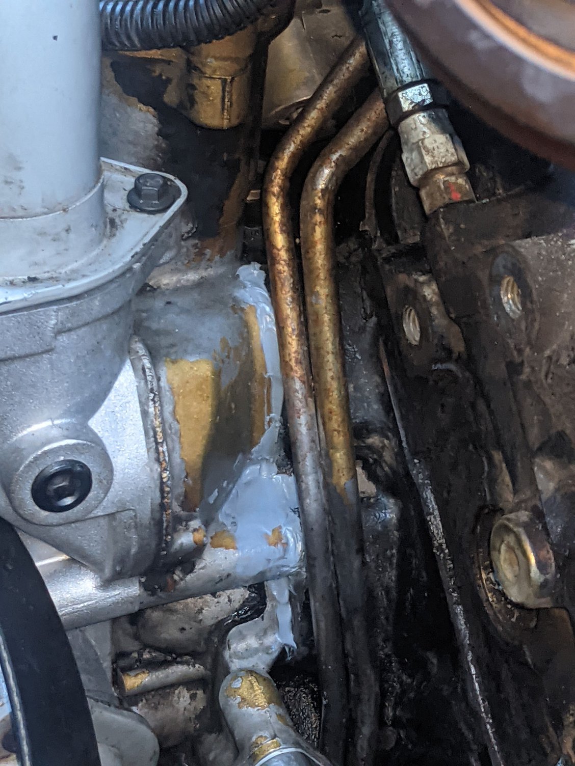

I am about to put everything back together. When I took apart the water pump, the two bolts that go through the timing cover were caked in oil, and there was the distinct sound of silicone RTV peeling away as I took them out. I am hoping that in retorquing everything down maybe the seal will be refreshed. I'll attach a picture of where the leak is now that everything is cleaned up.
On one hand, having torn this far into things, I am tempted to lift the engine and cab up slightly to address the front cover (and oil pan) now. On the other, I suppose there is a remote chance that some unseen force other than this was the culprit and putting back the water pump and oil cooler will magically solve everything.
Correct me if I am wrong, but is the existence of silicone at the seam evidence of something not being quite right, such as a previous attempt at a repair? It looked like the bolts had dried silicone on them as well.... if the gasket is functioning properly, there should have been no need for silicone, right?
I cleaned things up to reveal any potential cracks, but I believe the leak is at this seam here, probably a bit above where the silicon bleeds through
Also I should note that this picture is the space where the hard fuel lines (that I have removed for this pic) go up between the oil cooler and the drivers side head.

Okay I believe the mystery has been solved. The leak is coming from the timing cover in the alcove that the fuel lines run across. There must be a hole in the gasket or something. I suppose I will just monitor how fast this leaks and come up with a plan from there. I am tempted to see if I could just put some additional torque on the bolts that go into the block, right now they are at 18 ft lbs which is spec. Any other quick fixes come to mind?

Ive got my annual cross-country road trip from Portland, OR to Detroit, MI coming up, and I'm way too behind schedule to pull the engine at this time. I really thought about it over the weekend, but having just spent 200 dollars getting my AC charged, I didnt have the heart to have it emptied again.... in addition to all the 'while you're at it's' that I would like to potentially tackle with the engine out. If the experiences of ppl here w the moroso oil pan gasket were better I would have lifted the engine and cab and done the job with the engine on, but I personally felt like it wasnt going to be worth the trade off if the seal didnt hold.
But in the name of half-assed-jobs, I am however going to explore 2 quick fixes. I'm going to clean up the area of the leak and see about putting some TA31 there if I can get it clean enough, and I am going to see about putting a washer on the bolts near the leak and potentially torquing them a bit higher, maybe closer to 25 lbs. I did verify that the bolt were the specced 110mm. Could these bolts have stretched slightly? I measured them bottomed-out and the space left was just barely enough to hold on and seal the pump and gasket -- i think there was 47mm of space, and the pump and gasket was 48mm. Something like that. I am thinking that if I can tighten things up just a bit, that might at least minimize the leak to the point that I can buy myself a few more cross country trips.

As for tightening those bolts more, be careful. Last thing you want to do is snap one. If it were me I'd just clean it real good and try and smear some ta31 over the area.

Alright, Ive placed all my faith in the miraculous powers of the TA-31 sealant...
When I finally do pull the engine, I'll probably curse myself for doing this
I can think of a number of ways this could fail, so I look forward to seeing how this experiment works out... if it holds I will be very pleasantly surprised!
