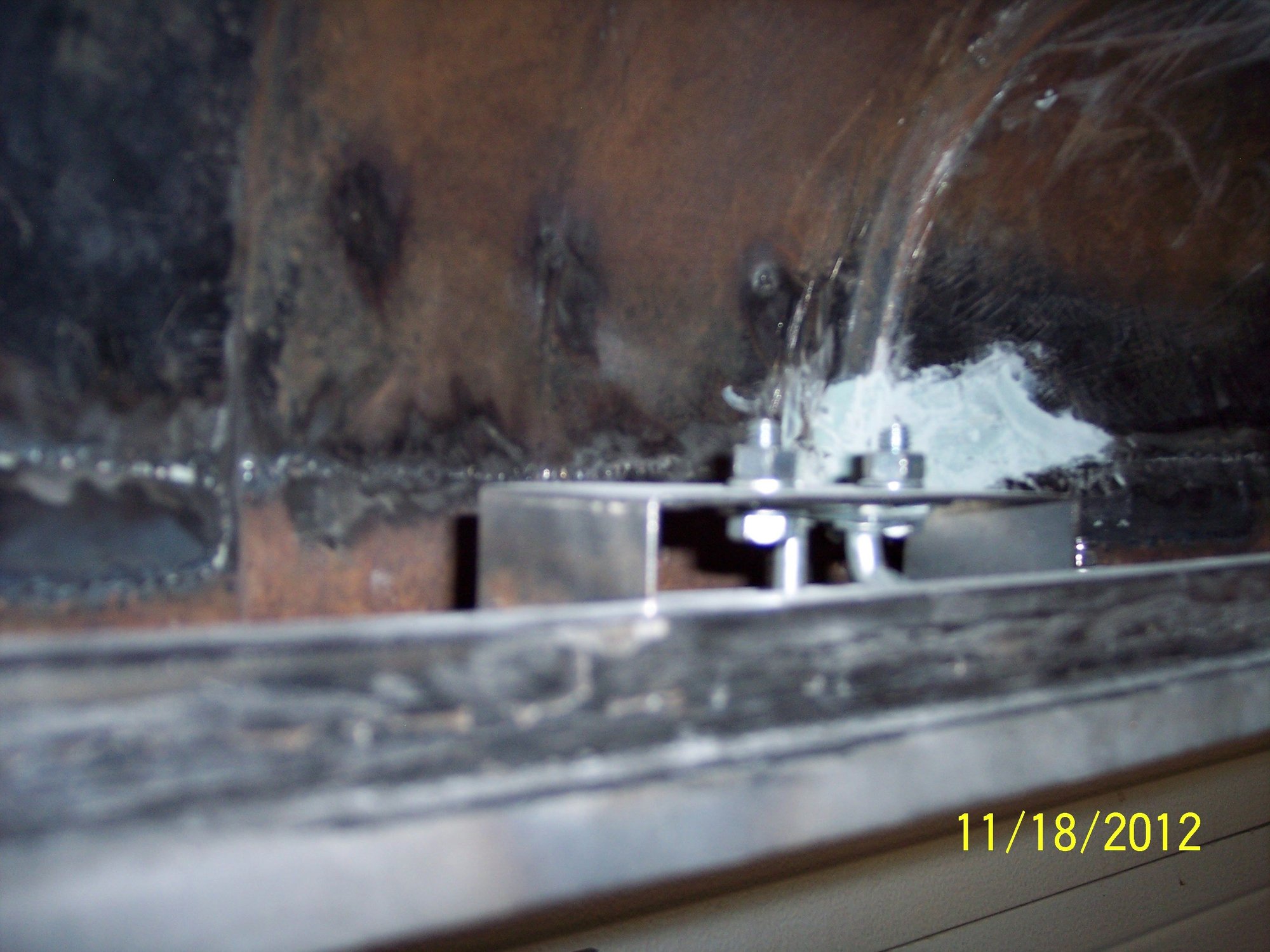

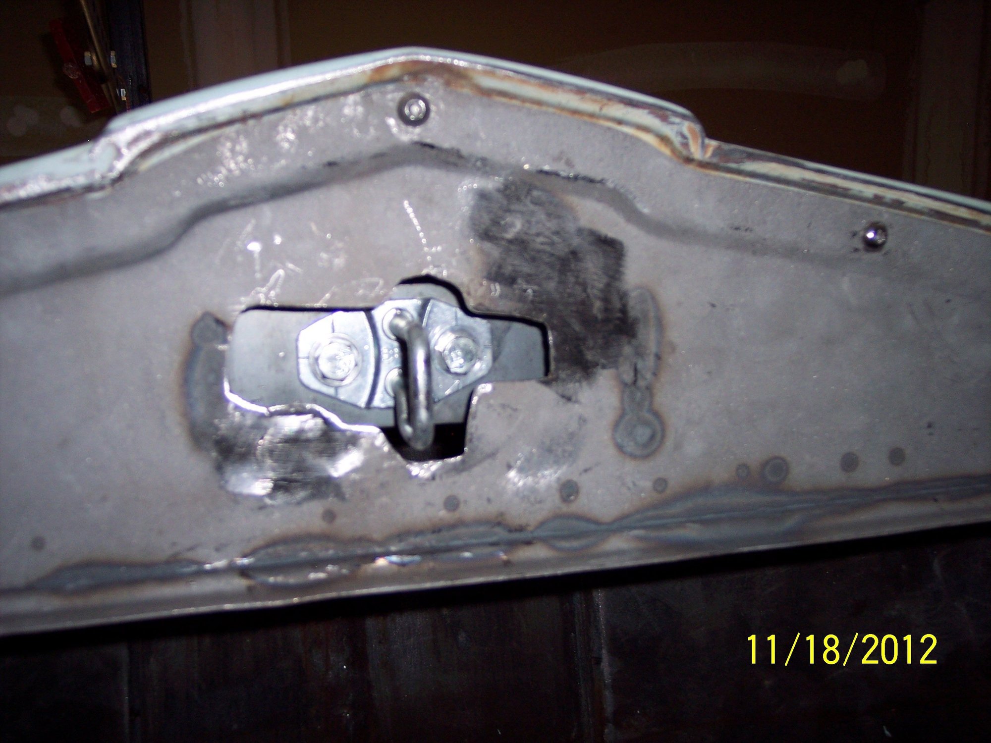

You are correct, a safety latch/chain should be installed with the conventional opening hood. My hood is a reverse opening hood. A safety chain or latch is not needed. When my hood is closed it is secured in the front latch and on each side at the rear of the hood attached to the firewall. ( see pictures).

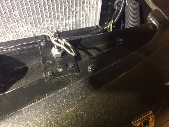

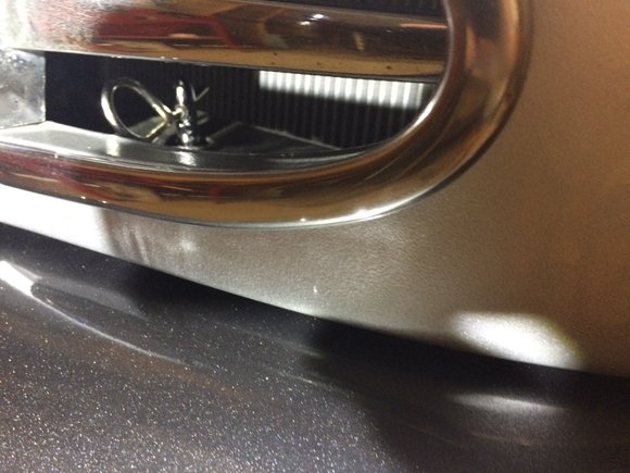

I did hood pins under my hood like above and kept the stock locking and safety catch as well.
