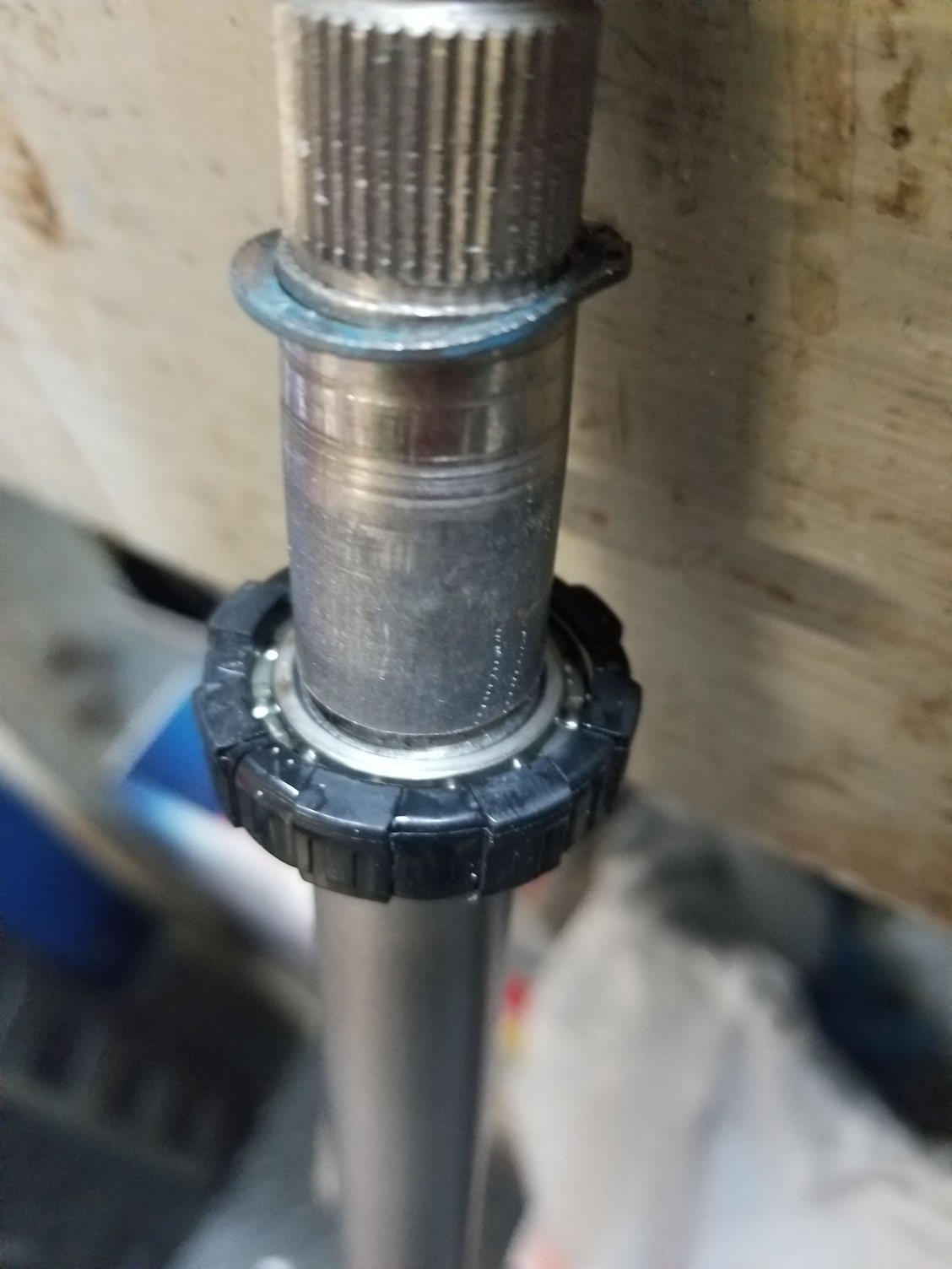

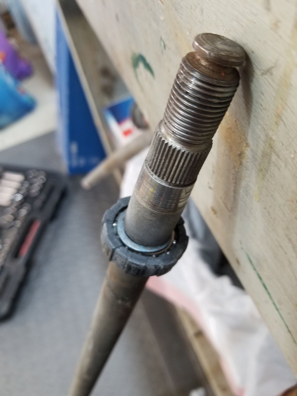

I just cleaned the old one and lubed it. But, the black plastic ring which goes around it broke. Does it really need it?
The black plastic part fits pretty tightly inside the area in the column. It might be OK for a while, but I would get a new bearing.
