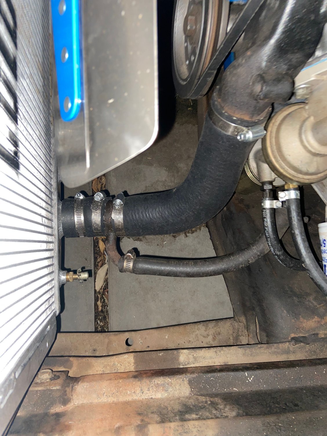

So everything is up and running and I drove it all over the street and went down the freeway.
then I got stuck in traffic for awhile and when I was driving the temp gauge went from say 1/4 to halfway.
When I got home and shut it off. It was smoking a bit and the overflow tank someone crafted had about a quarter inch of antifreeze in it. Also the bottom radiator hose leaked on my floor until it “cooled off”.
I popped the radiator cap and it looked about an inch empty.
I just got a shroud from summit so we will see if it works out. ( it didn’t line up )
I’ll post some pictures in a minute. It’s the aluminum cold case radiator and according to the website it says run 50/50 green in it.
Any suggestions? I don’t want to mess up a rebuilt engine.
I also have a problem with the fuel sender or wiring for fuel. It’s not reading.
This fitting I believe is the culprit that leaks antifreeze

Verify temp with a thermometer as dash gauges can be misleading. Double check timing...should be 6-11 initial and 35-39ish total. Vacuum advance (if in use) will add another 12-15ish. Also check crank pulley diameter to fan pulley diameter ratio...should be 1:1 or greater. Speaking of pulleys, do you have a new damper pulley? Always nice to put on a new one for a rebuild. They do rot out over time.
If it still tends to run hot it may just need some break in time. I got a reman 390 from Jasper that ran scalding hot for the first few hundred miles. My next engine was built by an FE guy...torque plate and line honed, etc. Never ran hot even though it displaces noticeably more than a 390. I have a factory type radiator from NAPA for a '65 and shroud from I think a '68, btw. Adding a shroud will help; just make sure the fan is spaced about halfway into the shroud.
What is the fitting in the bottom radiator hose?
