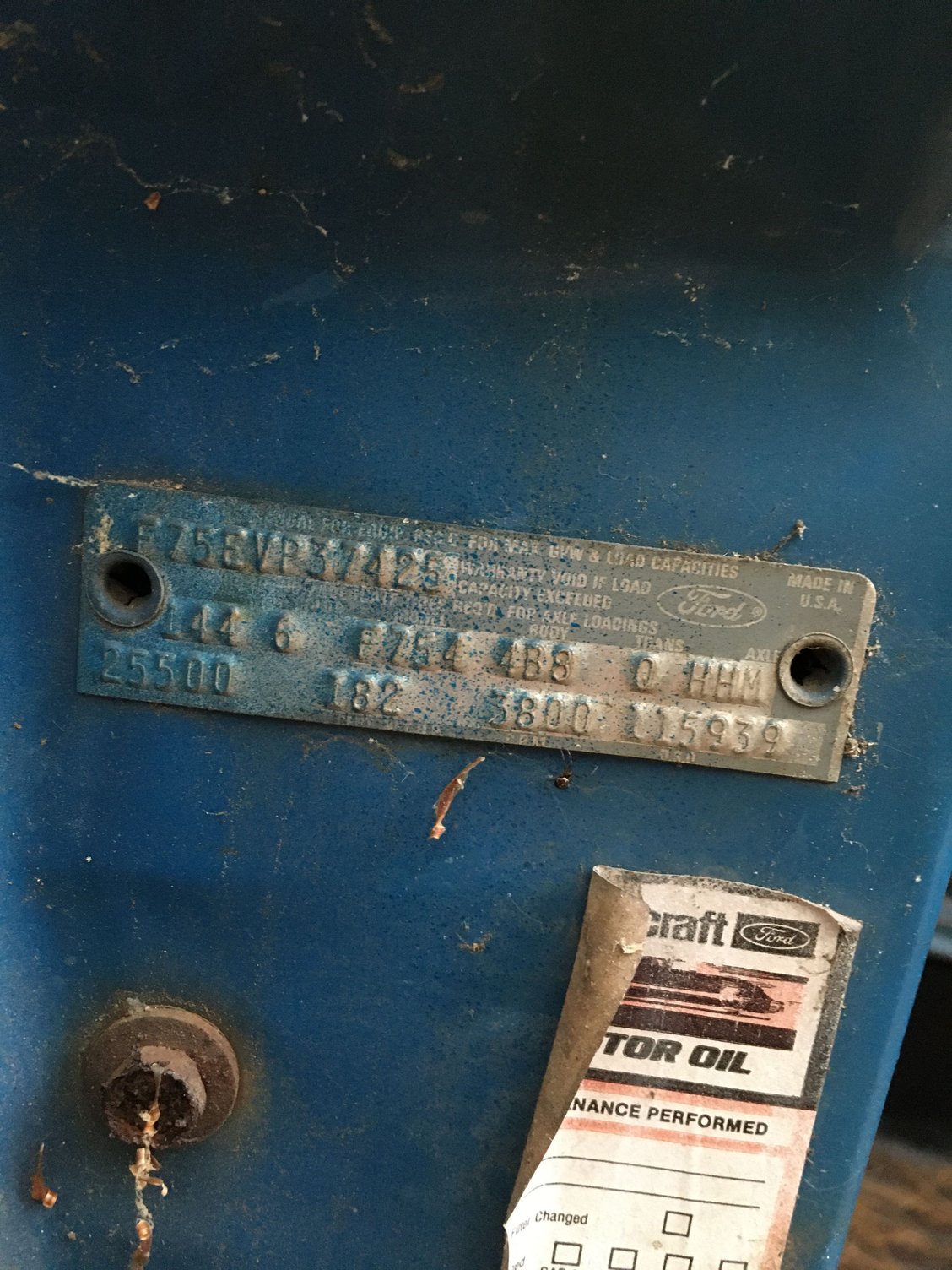

So I just got a free f750 that runs but it needs a clutch, it has a 361 ft 210 horse and a 5 speed manual with 2 speed rear end. I don’t know too much about these trucks I need to know what trans it has and where the hell to find a clutch thanks.

My first thought in this case as well. Might count the tranny input splines and diameter before you head to Napa or take the respective clutch parts with you.

You're actually in luck, those clutches are pretty much unavailable but Fort Wayne has them on clearance. A couple years back they were 500.00 then they dropped them to 145.00 now are 99.00.

Trans code Q: Dana (Spicer) 5 speed direct, model 5652.
Are you familiar with two speed axles? There are videos from Eaton available, and they should be shifted as recommended. I'll post them if you want.
