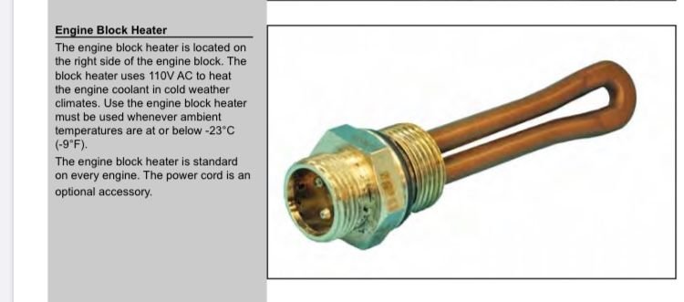

Does anyone know if the Plug in Engine Block Heater is screwed into the block drain plug? I'm guessing IF for some reason I'm going to start to need to plug this truck in it's an option pretty easy to add?
last information on the 6.7 the heater is installed on all engines. Only thing you get with ordering with is the plug, so see no reason one could not just purchase the plug and install.
Nope, unless ordered there is just a plug in the block on 6.7 engines. Look above the starter for the plug.

Go look, the 6.7 doesn't come standard with the heater installed. This isn't new, go to post 37 for pictures of the plug.
https://www.ford-trucks.com/forums/1...-heater-3.html

OP, What state in this truck being ordered/purchased in? There is a list of cold climate states where the block heater is actually standard equipment. This is not to say it is free, I'm sure it is rolled into the price somewhere.
As for it being on all 6.7s, and the option is just do you get the power cord. These trucks are built by a company run by bean counters. They are not going to put an part on every engine, and only use it on a few, when there is a much cheaper part (plug) that can be used on most.
