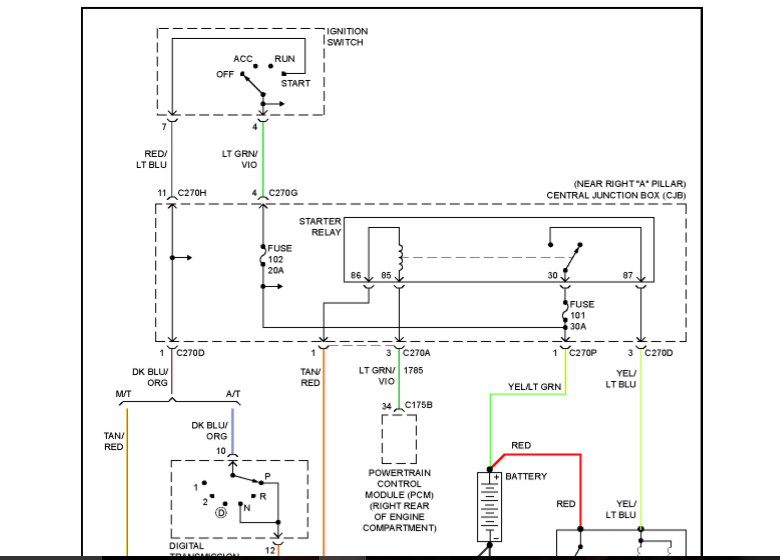

Gentlemen, my 04 does not crank. I'm working 6 12hour days for the next month so I need to fix it sunday. Does anyone have a wiring diagram they can share?
Thanx Eric

Attached is PDF version. Cheers -

Here is just the starting circuit.
