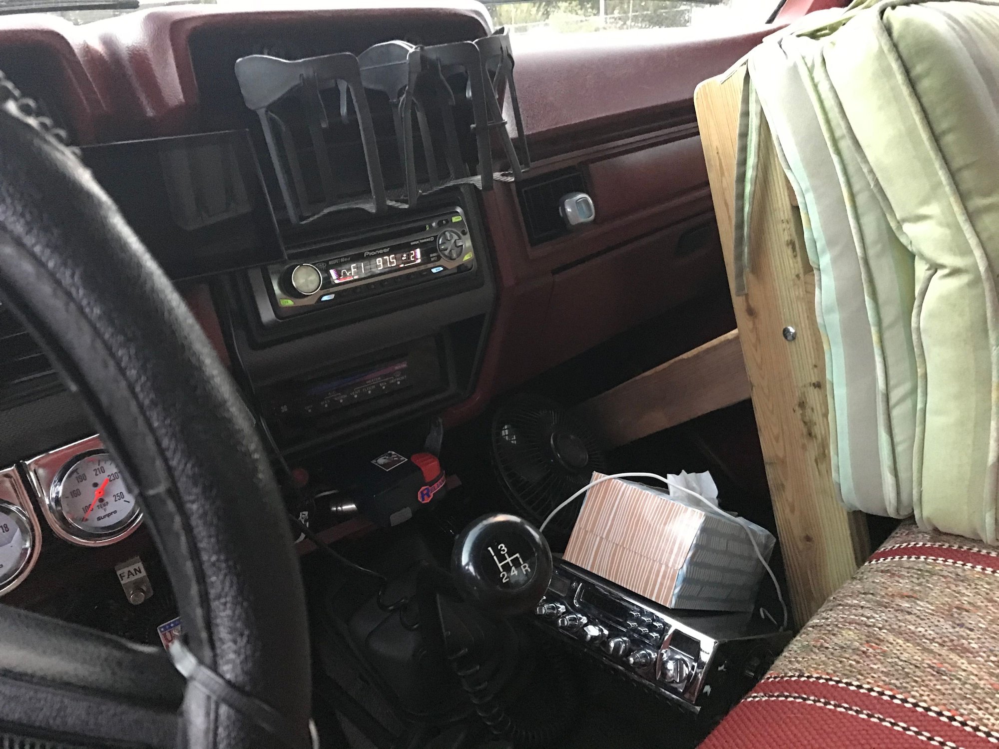

My cup holders I added in the 90s
The green pillow scissors is for my husky who rides often , I made this last winter as collapsible to take in and out .Once in the floor after hard braking was too much!!!

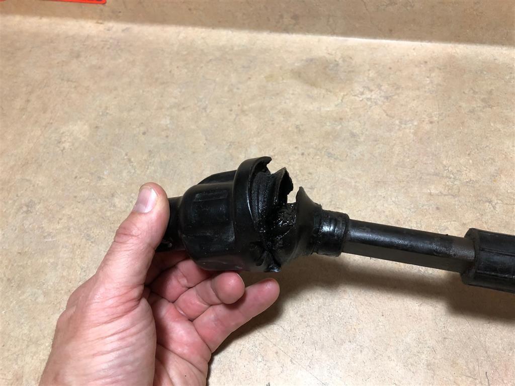

Originally Posted by Bishop9.5
What's the deal with the intermediate steering shaft?
The rubber boot on the upper joint of the Bullnose steering shaft will deteriorate and fail/rip/tear after a while, and there is currently no replacement available. The 1987-1991 steering shaft has a "dry" upper u-joint...meaning it is like a regular u-joint, with no rubber boot to fail. Also, the 1987-1991 steering shaft has a bonded rubber "rag joint" that is a sturdier part than the traditional style rubber disc rag joint that was used on the Bullnose trucks. It's one of those things...if you can find a good one at the junkyard, grab it for a spare, because when the upper boot rips on your shaft, you'll have a good replacement.
1980-1986 upper joint...
1987-1991 upper joint (on the shaft in my truck now). $15 used item.
