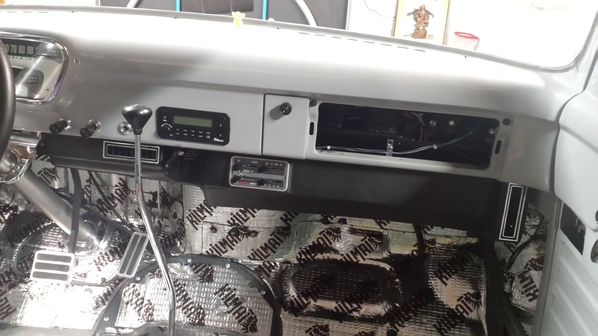

I have had many under dash panels made, both for my F100s and my 40 Ford, Until my recent move, I lived in close proximity to Direct Sheetmetal in El Cajon, CA. Dave, the owner, will make anything you want...just provide the dimensions. I use 16 ga steel and adjust the height of the panel to match the steering column drop and/or vent sizes.

Here are a couple of pics of the panel in my buddies 55 truck. He opted to mount the panel with a set back to allow the glove box door some clearance. I am not a big fan of the stereo mount but it works for him.
BTW - this is an OEM seat that was upholstered by the same shop who did the other seat that I have posted showing how a stock seat can be bolstered to look more custom.

BJ , you've seen mine. Its just a piece of 11 gauge sheet metal, 4" deep and ever how long it is from door to column mount. I welded several "L" brackets to mount it to the under side of dash with Tek screws... drilled the holes for switches, a/c and a/c controls. Left of the column is the same.. I've seen some that follow the curve of the dash at the doors and they look nicer than mine because of that detail. I didn't set mine back as much as some since I have no glove compartment door to deal with. Also you can do with thinner stock as Charlie mentioned and it's easier to work. I used what I had on hand. Sorry, I don't have any really god pics of mine
