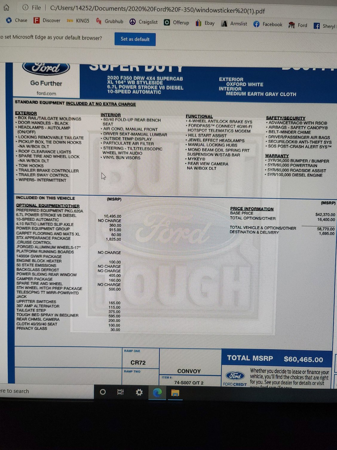

14k GVWR Package?
Bought a 2020 F350 stx sclb 6.7l to pull new fifth wheel. On the window sticker it lists a 14k gvwr package, camper package and fifth wheel prep package. I cannot find a 14k gvwr package in the order guide. Anyone know what it includes? I am not concerned about ability to pull fifth wheel as it is well within weight limits. Yellow door sticker 5800lb capacity.

Aren’t all DRW’s 14,000 gvwr now? That might be it...because it’s a dually.

It's just a line item. All duallies are 14,000 pounds GVWR unless downrated to 13,000 with an option code.

Thanks for the replies! So payload packages listed in the order guide are downgrades?

Yes. Just paper downgrades for people in states that require CDL or higher registration fees.
