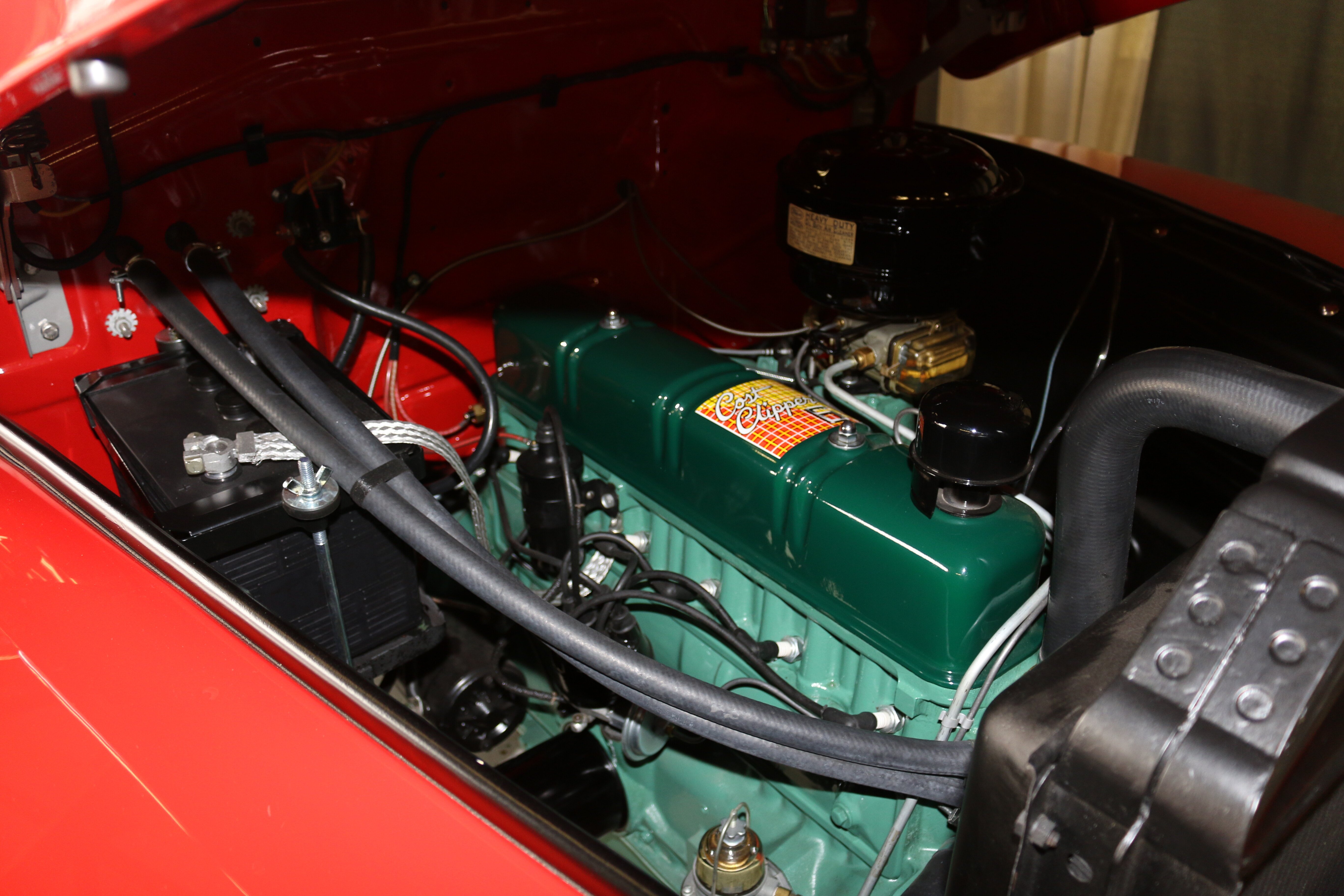

[QUOTE=52 Merc;19519603]Welcome to the forum! Are you sure the truck is a 49? From what I see, with the larger back window and the later style bed, it suggests a 51 or 52. The the EAA prefix block ID suggests 215 OHV 6 cylinder, which would be correct for a 52 (the first year that engine was used). You might need to do a little deeper digging for chassis numbers or ID tags to verify. That truck, unfortunately, is about as rough as they come, so if you're planning a restoration, I hope you're up to the task. Let us know what you find, we're here to help.
The engine is only worth something if it can be verified it's not broken or junk. Even at that, as long as it's been sitting, it would only be minimal core value if it was good.
Rear end in a 52 would be originally a Dana 44. A 49 should have a Dana 41. Those are identified by a number cast into the lower right housing web, next to the rear cover.
Good luck with your project.
Very nice original resto!
