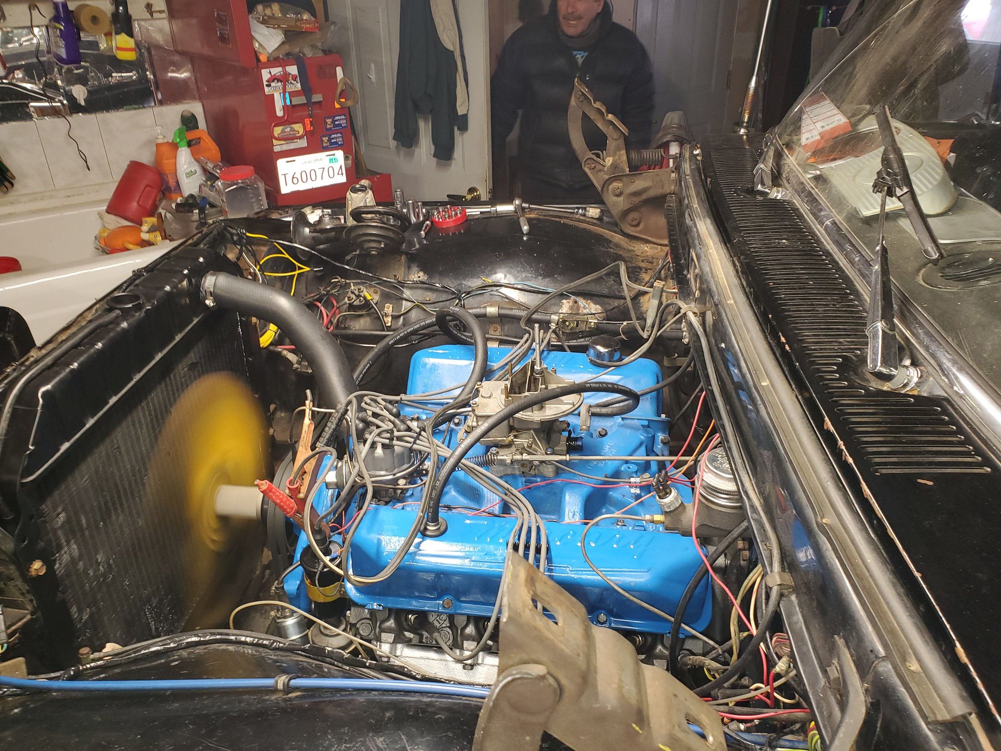

Blackie Runs Again!
Finally, we got the rebuilt 390 from S&J Engines in and fired up yesterday! Runs and sounds great!
Old Jan 29, 2021 | 03:22 PM
Vandy23's Avatar
Vandy23
Joined: Sep 2019
Posts: 272
Likes: 24
From: North Jersey
Congrats. She does look good in there!
