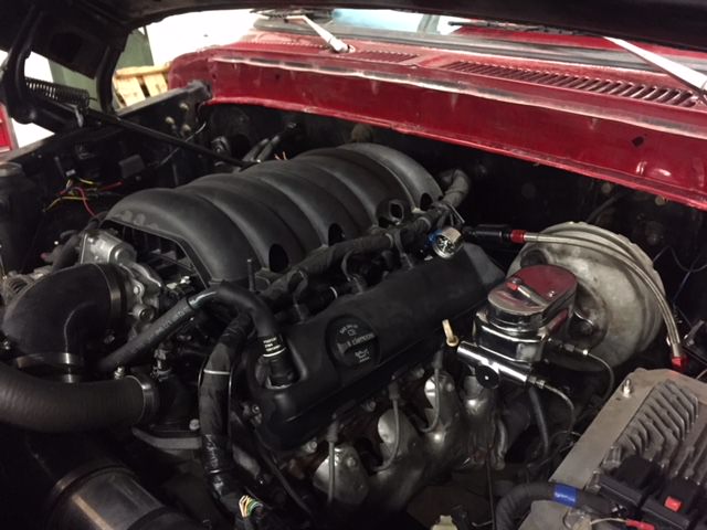

An LT engine (2014+ Chevy) is nearly a bolt in conversion- I am running one using original 74 Ford motor mounts and motor perches. These engines are leaps and bounds better than LS engines and are fairly inexpensive. I have a 74 f250 with this engine and also a 74 F350 with a 428 SCJ engine. The SCJ runs really great and is one strong big block. It can't even begin to keep up with the 5.3 LT, not to mention half the mileage and half the gears. A funny thing about modern engine swaps is that Chevy transmissions are easier to adapt to Ford NP205 t cases than most Ford transmissions. This being said, I will be ditching the LT powered truck for a cummins powered truck.
Attachment 281225

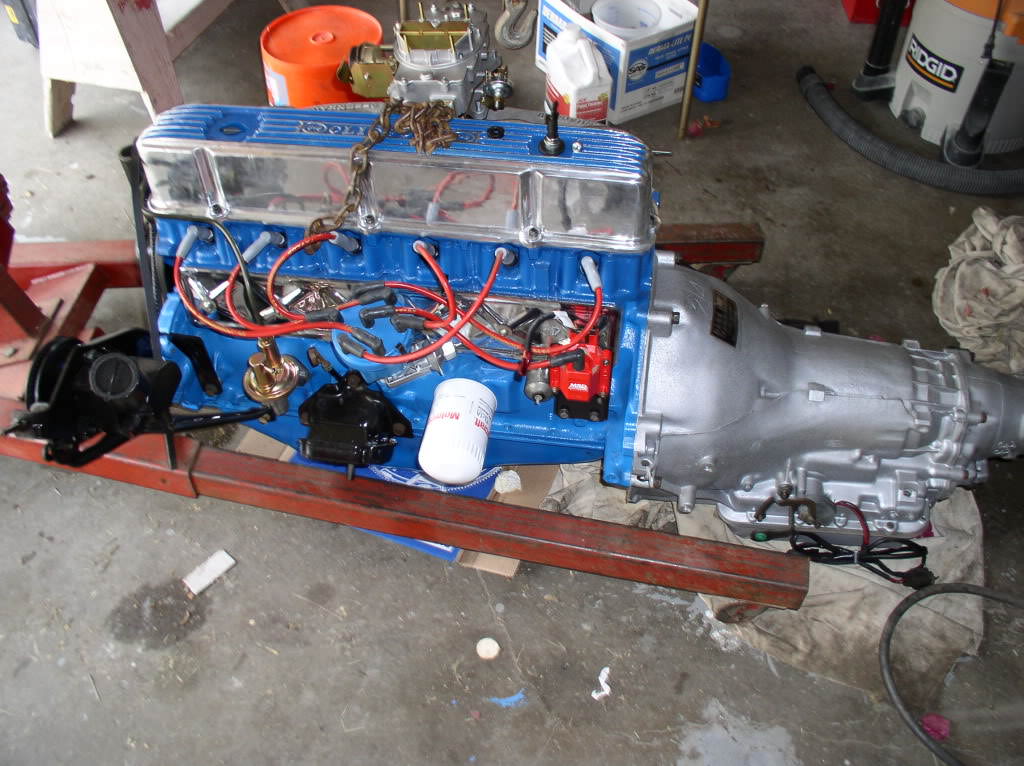

I converted a 75 f250 from a 360 with a c6, to a HP 300/4.9. with a zf5. Because of the head work, 4v carb, msd ignition, headers, I kept all the horse power and went from 10 mpg on the highway to 20 mpg. What I learned is that you have to work with the strengths of any engine. The strength of the 300 is hp down low, so keep the cam small or you lose the grunt. The recipe for amazing power is larger valves, 1.94 int and 1.6 exh, msd ignition, bowl work on the head, Hedman header with 1.5" tubes, an Offenhauser or Clifford intake, and a 500 cfm edelbrock or a 600 cfm Summit Racing 4v carb, both vacuum secondary carb. Use a hyper piston with a D shaped dish with 25 cc dish, and stay around 9.0 compression ratio. That combo will blow your mind. Rear gears not taller than 3.31, better at 3.50. Use 2.25" exhaust tube, dual to rear end, then 2 into 1 2.25". Most people want to put a small carb on these engines. But remember, the 300 is 75% of a 400 v8, with 4" cylinders and 3.98" stroke. That's a big gulp of air, so don't choke it down with a small carb. I've seen untold guys throw a Holley 390 cfm 4v on them, and wonder why they power is limited. And then I've seen guys toss a Holley 600 on them because they are inexpensive and everywhere, and they run fantastic. I've run many carbs on this engine while searching for that balance between mpg and thrilling power. I've tried the Autolite 485 and 600cfm, 750 and 800 cfm Quardajets, an edelbrock 500 cfm, a Holley 1848 (465 cfm), and the Summit Racing 600 cfm. For crazy power the Summit 600 blew everything away. The Edelbrock 500 had the best balance of power and mpg, but man, I sure loved that Summit 600.
The photo below shows the engine with an Autolite 4100, 485 cfm.
Attachment 281223
Here it is with an 800 cfm QJ on it.
