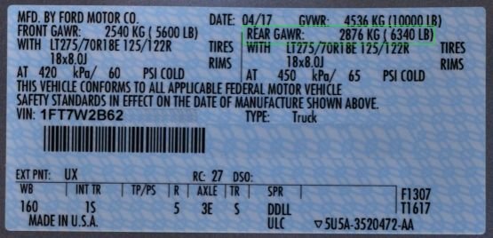

Originally Posted by tsmithco
How can I find the ACTUAL rating of my axle? I know the rating on the door is limited by the tires, but I've replaced my tires with higher ratings (not for towing but they just happen to have higher rating). In theory, I've gained about 400lbs to my rating because the tires were the limiting factor.
The white driver's door jam sticker will state what it is limited to 'legally'. (Your wheels, if OEM, might be the weakest link.)
Here from my 2017:
Old Sep 30, 2020 | 03:12 PM
tsmithco's Avatar
tsmithco
Joined: Jun 2020
Posts: 435
Likes: 140
yes, but like I said, that's limited by the tires. The axle itself should be hundreds to even thousands more. (not that I would add an additional 1500lbs and think that's ok!) Since I don't have the HD tow, it seems like its a sterling axle and not a Dana?

Old Sep 30, 2020 | 03:26 PM
tsmithco's Avatar
tsmithco
Joined: Jun 2020
Posts: 435
Likes: 140
Very True. In my case, I already have Airlift bags installed. The tires will still be the weakest link.
I was able to find the answer - the Sterling is rated to 9750lbs.
So, for anyone else who finds this later, here's the breakdown:
3.31 Sterling Axle - 9750lbs
Airlift bags (Load Lifter 5000) - 5000lbs
Tires (275/70 R18) - 3640lbs
Orig tires (275/65 R18) - 3415lbs
Wheels - 3590lbs (Added this after the post below from h20camper)
So, in my case, my rear axle rating (rawr) went up due to tires from 6340lbs to 7280lbs. (Actually 7180 due to wheel limitations listed in the post below)
Thanks for the replies - sometimes it takes working through things to get a better idea of how and why they are the way they are. I found out the HD package has a Dana axle, which is basically the f350 axle, which explains a higher rawr as well on those trucks.

Old Sep 30, 2020 | 03:30 PM
h20camper's Avatar
h20camper
Joined: Apr 2017
Posts: 3,924
Likes: 321
From: Lost in the Ozone....
Actually, the wheels.They're slightly under the AT tires.
Old Sep 30, 2020 | 03:35 PM
tsmithco's Avatar
tsmithco
Joined: Jun 2020
Posts: 435
Likes: 140
oh nice - good catch! So, 3590 x 2 - 7180lbs. I'll edit the above post.
Old Sep 30, 2020 | 03:51 PM
OffBalance's Avatar
OffBalance
Joined: Jun 2020
Posts: 778
Likes: 14
From: Seattle area, WA USA
I'm curious how the actual axle specification plays into this. For an F-250 the axles are spec'ed at 6000 lbs front and 6200 rear. How can they get a rear GAWR of 6340 rear?
Old Sep 30, 2020 | 04:10 PM
h20camper's Avatar
h20camper
Joined: Apr 2017
Posts: 3,924
Likes: 321
I'm not sure about the 6,200 vs 6,340 but the same physical axle under a F350 can be listed up to 7,230. Its all about classifications. Not physical ability.
Old Sep 30, 2020 | 04:18 PM
Joe T's Avatar
Joe T
Joined: Mar 2017
Posts: 10,172
Likes: 1,376
From: Chaz
My F250 6.7 4x4 20 inch wheels is 6340 rear gawr @ 65psi.
The same axle in the 350 srw gas truck is like 72XX lbs @ 80psi.
I never really need to exceed 6340. Even if your trailer is 25% pin at 13,000 gross you probably wont be over the rear axle unless you have a lot of stuff in the truck. Probably doesn’t even need the airbags.
